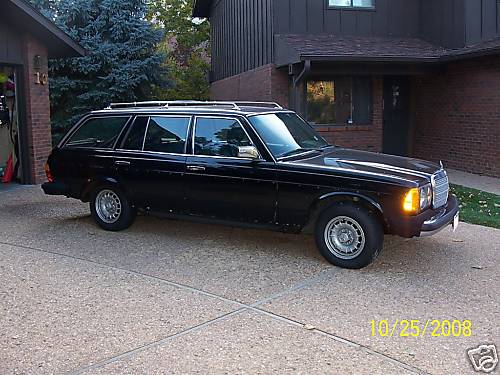

04-23-2009, 09:20 PM #8
Came across this ebay sale a while back and pirated the pics. Wagon with no trim on it, looks like the owner was in mid something, since all the holes are there.
This is something I am considering as well, ive got a slight bend in the trunk from some accident which is amplified by the trim. I think the wagon still looks pretty good.

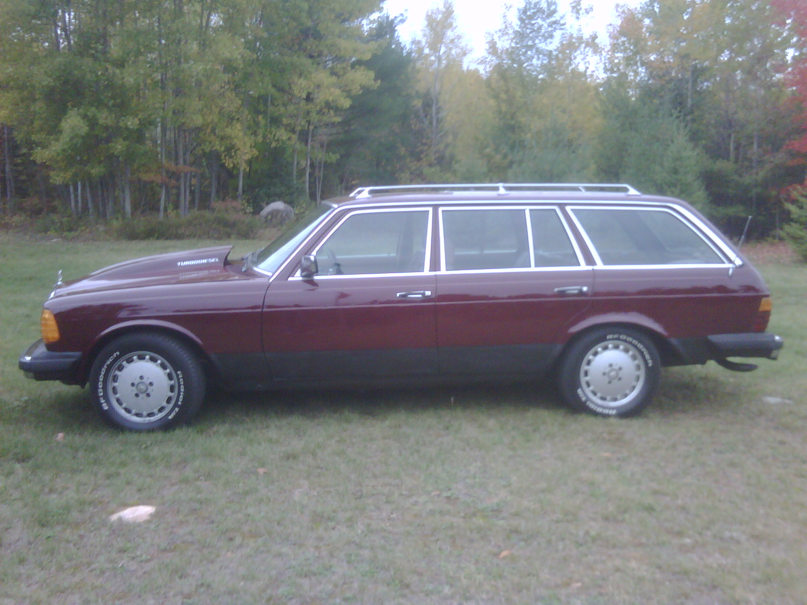

I removed all the side molding off of my wagon, It was a little more work than what I was hoping for. To fill in all of the holes I spot welded all of them and then grinded them all smooth. It was really time consuming and I wouldnt recommend it unless you were going to be repainting the car.

05-18-2009, 11:13 AM #12
I removed everything off the back of the wagone except that metal piece that holds the license plate lights, it was tricky seperating the molding from that but it worked out. I will try to take some pictures and post them. I also removed all emblems and instead used 210 chassis emblems because they are smaller and cooler looking print.

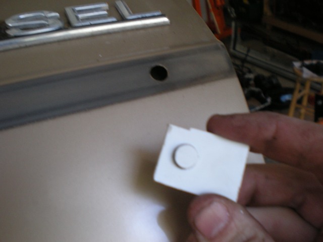

02-28-2010, 05:47 PM #15
(05-24-2009, 08:53 PM)GREASY_BEAST every W123 that I have seen with the trim removed looked like something from a war-zone. There is just something not right without the trim, maybe its the holes. If you were to do it right and fill every damn hole it might end up looking cool... But unless you can get to the back of each hole, just filling them with weld will allow for rust from the burnt-off paint on the backside...

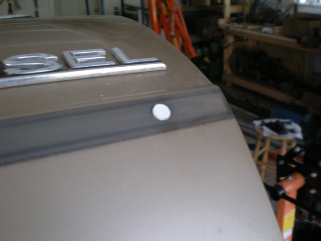

Working on my wagon today- You CAN get to the back of all the holes on the cargo end, and if you pull the fender, the front fenders as well. Not sure about the gate and the doors, but with enough work, I don't see why you can't get to those as well.
But why weld? I was thinking it would be easier to just grab a little square of thick plastic, clean the back side, and JB weld it to the back of the panel behind each hole. Then just work from the outside with bondo or fiberglass to fill the hole in. No potential rust problems. Then a nice coat of paint.

03-01-2010, 08:15 AM #16
I welded all of mine, if you use any other material it will expand and contract at different rates with hot and cold weather and therefore will crack and in some cases fall out. The doors are not bad to get to, the tailgate gets kind of tricky it all depends on how versitile your welding gun is. One mistake I made though and is something to watch out for is dont go down the line one after another, skip around the car so you dont heat one body panel up too much or it will warp.

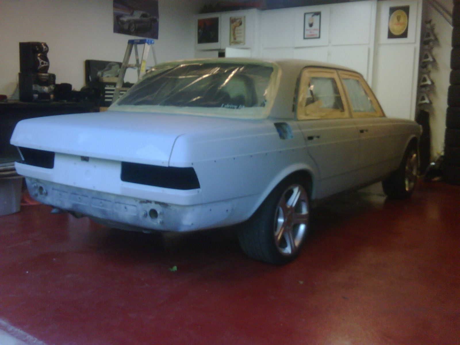

03-02-2010, 08:13 AM #20
This is an old picture, about 3 months after it was painted.

03-02-2010, 09:02 AM #21
I love it! the lettering looks great on there, and I don't think the actual body lines of the wagon lose a thing by removing the molding. I think it cleans it up actually.
It looks like you also removed the plastic flare from the bottoms of the doors, that looks good as well.
Is this a two tone? or is that undercoating along the bottom there?

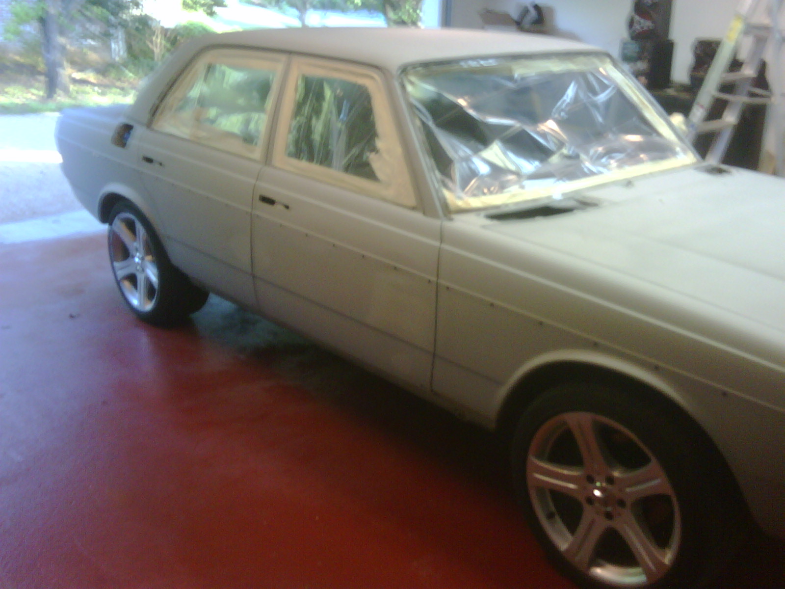

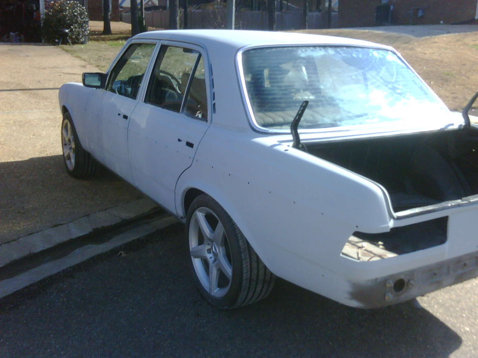

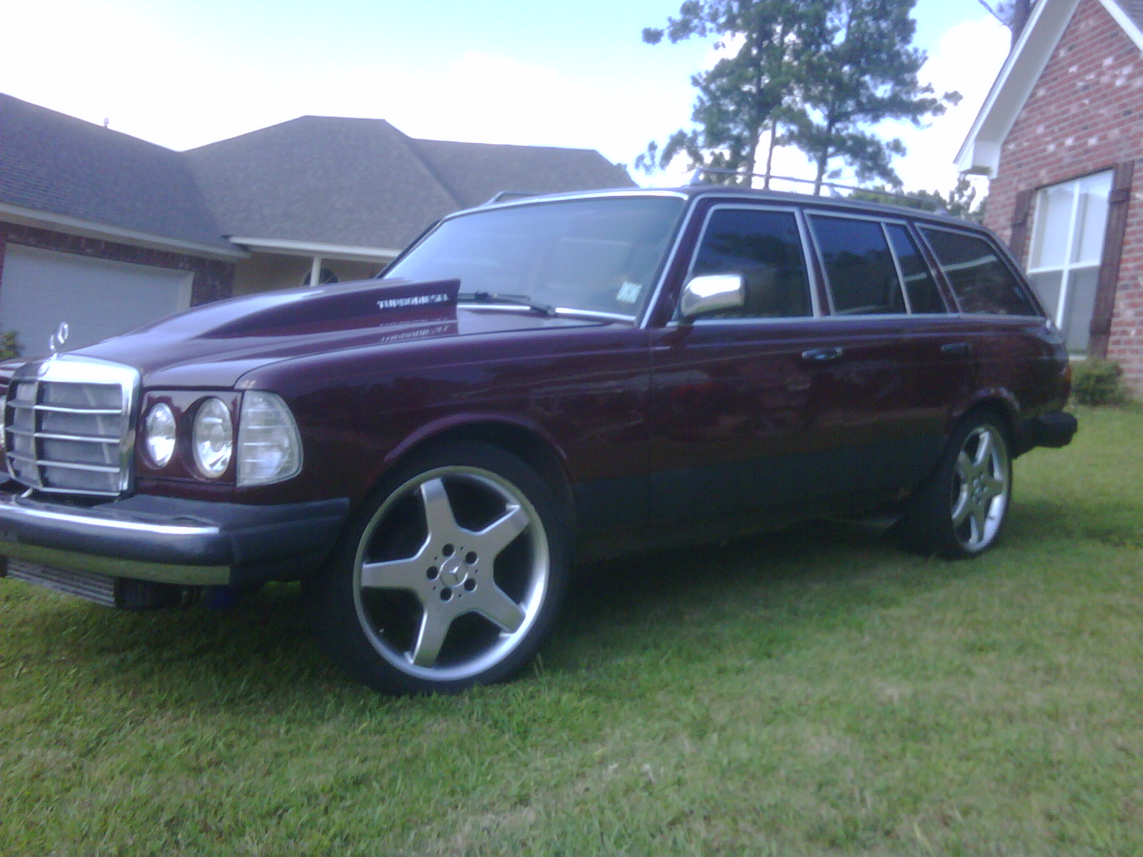

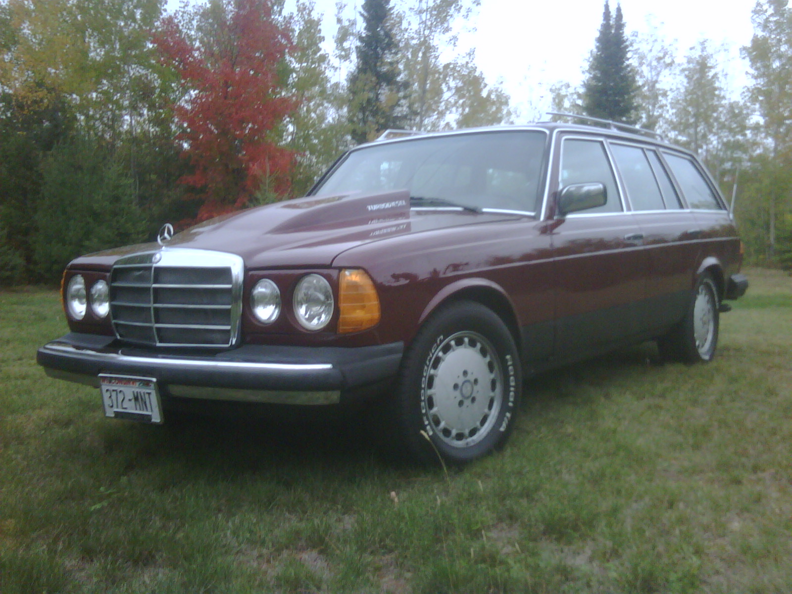

03-02-2010, 09:57 AM #22
Yes I removed the lower trim as well due to most of it being missing to start with. That is undercoating or like a bedliner material. My bodywork got kind of sloppy on the bottom so I incorporated that to hide the imperfections. Once again this was mainly just an attempt to see how it would turn out, the next one will have a little more time and effort invested in it, but not bad for my first attempt at body work.
Here are a few more pics, including one recent one.

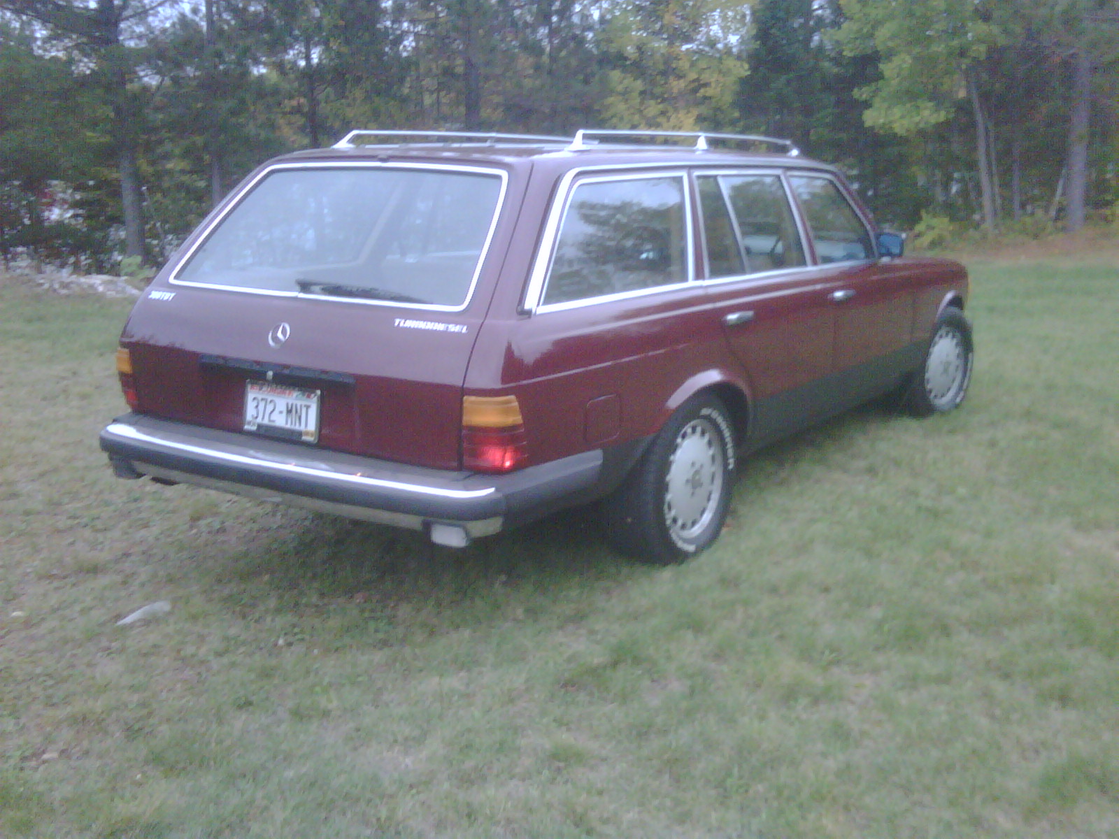

Maybe I will try again on my wagon, I like the no molding look enough to try and follow your example down the road. Painting I will leave to a professional.

03-02-2010, 10:17 AM #24

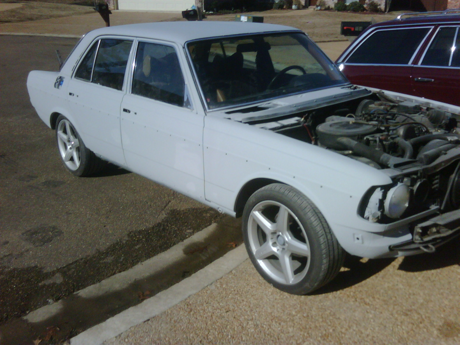

My wagon I did pay to get sprayed but I am currently doing body work on my 123 sedan and that one I will try to spray myself, this one however is keeping all of the trim since it was all in good condition still. I may black it out though (not sure yet).
Here are some progress shots of the sedan. Hoping to paint it soon

03-03-2010, 08:52 PM #25
looks really good! you also answered another question I had, which was what a 123 looks like without the bumpers on it.
What are those rims on it? are you using any kind of spacer?

03-04-2010, 10:21 AM #26
There are 1/4" spacers up front so the center cap clears, but those are not on in the picture.
Those are wheels from a 211 chassis

04-08-2010, 01:12 PM #27
heres what im doing about the holes left behind-
I took a piece of styrene I had laying around, and made a little plug, then epoxied it to a flat piece. Then I cleaned up the back, and epoxied the flat piece to the back of the panel.
The plug sticks out and the styrene is really easy to work with as far as shaping, so all I have to do is make 100 of these, glue them in, sand them down, and add minimal body filler to complete my trim hole elimination, and not have to worry about warping the panel, or removing paint.

04-09-2010, 09:13 AM #28
Wow thats a neat idea, let me know how that works out. Maybe I will hold off on paint to see how that works. Heres where I am at.

04-13-2010, 10:51 AM #29
I will sand it down and do a primer test on the one hole. I think the styrene is very paint friendly, but im not sure. Ill post back with results.

06-09-2010, 10:21 PM #30
heres another picture worthy of being added to this thread along with MB TECH's wagon. Stolen from benzworld.
I think this sedan looks great without the trim. Chip Foose is right about all these older cars being over chromed.

(09-14-2010, 11:06 PM)garage Dropnosky, did you ever plug the whole car with styrene?
Howd it work??
Unfortunately, no. Just that one hole. that car was overtaken by events. Space for it disappeared and i sold it.

09-16-2010, 08:46 AM #37
(09-15-2010, 10:31 PM)garage
(09-15-2010, 06:50 PM)dropnosky
Howd it work??
Hmmn, how did the one hole look/last?
I would like to find an alternative way to fill the holes in my car other than spot welding. At least the doors and rear quarter panels.
It looked good, and was still stuck on there. I never got around to sanding it down though. I still have a bunch of styrene scraps if you want em. I could mail them off to you if you want to test it out. Its also available in sheets everywhere, you might be able to get a scrap from a plastics place.

09-16-2010, 02:34 PM #42
(09-16-2010, 01:54 PM)Captain America I am not near my car at the moment but can someone count the number of holes
I think around 100 or so. Probably less, but that should cover all of them
(09-16-2010, 09:13 AM)garage Hmm, does this stuff already have the little 'knobs' to fill the hole, or do you need to carve/sand each one to make it fit?
no knobs, just scrap. Stuff is easy to shape though. I intended to use a wood plug cutter drill bit to make all the knobs fast.
This post was last modified: 09-16-2010, 02:37 PM by JB3.
