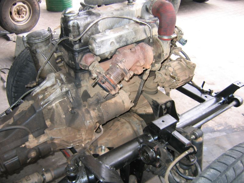

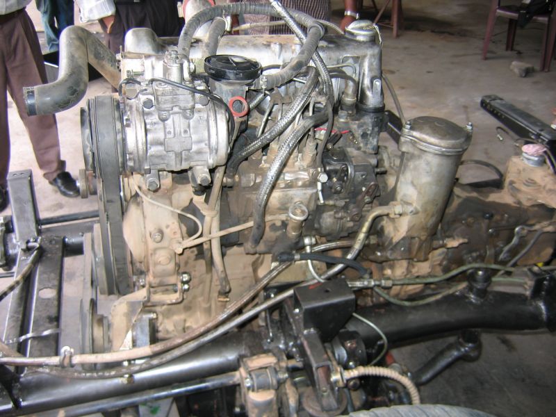

Gurkha
31
03-13-2009, 12:08 AM #15
(03-12-2009, 02:25 PM)ForcedInduction
(03-12-2009, 08:54 AM)Gurkha Lastly, new pump is needed.
Not really. The differences between the turbo and non turbo MW-pump is the ALDA and governor settings. They have the same 5.5mm plungers and the same governor.
The pump part number on my OM616 turbo is totally different from the N/A OM616 sold here.
(03-12-2009, 07:20 PM)Graminal95 STT made kits for 240's and 300's in Europe and many of them have gone 100k's of km without issue.
Quote: engine crank needs to be strengthened
I had not heard of cranks breaking in the 616 or 617's before. I think the crank is fine unless your making huge power or at least more then the 5.5mm elements can provide.
Quote:exhaust valves are sodium filled
The exhaust valves do not have to be sodium filled, many turbo diesel's and turbo gasser's have run very high EGT's without them.
Quote:oil pump is chain driven
The oil pump seems to have plenty of volume for my car.
Quote:oil cooler is needed
All w123 diesel's in the US got oil cooler's although the 300 is much larger then the 240.
Quote:oil squirter pistons
I don't have piston squirter and they are only needed if your really pushing the engine with high EGT's.
All these things would be nice to have and I consider them an over build as MB did to the diesels, but not necessary.
If I had the money and time I would just get a 300dt and plop that in but I had a 240D with 120k miles and wanted more power. I had an professional race engine builder with 30yr+ experience telling me to "DO ITTTT!!" so I did.
MB added nitrided crank to the OM616 turbo as well as 617 turbo pump, exhaust valves and pistons. I have removed the muffer on my 616 turbo to gain better throttle response as well as lower operating temps and EGT.
After 128000 kilometers, I have miniscule oil consumption between changes and my compression pressure is stock. I guess all the extra steps MB took is paying off.
I for one would rather go for the 72BHP mod and keep reliability than go for the bolt on turbo route. If it works out with turbo, more power to you.
This post was last modified: 03-13-2009, 12:13 AM by Gurkha.
Gurkha
03-13-2009, 03:58 AM #16
(03-12-2009, 07:20 PM)Graminal95 The exhaust valves do not have to be sodium filled, many turbo diesel's and turbo gasser's have run very high EGT's without them.
Just because other engines do it doesn't mean the 61x can.
Quote:The pump part number on my OM616 turbo is totally different from the N/A OM616 sold here.
Thats because Mercedes doesn't make your engine, they only licensed the design for production rights.

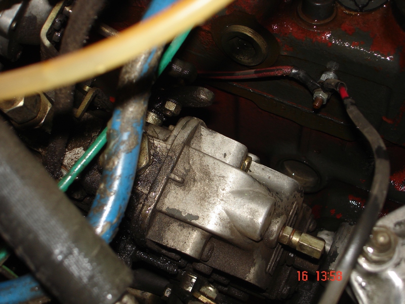

Here is the engine sold in India. It looks little like a 616 except the basic form. The IP is nothing like what was used in the USA. Its similar to the M-pump but with mechanical shutoff instead of vacuum.

03-13-2009, 07:55 AM #23
The pic you have is the N/A, the turbo has a different pump than what you see in the pic. The India OM616 has all mechanical pump in case of turbo and non turbo, turbo has no ALDA.

03-14-2009, 06:58 PM #30
(03-13-2009, 07:04 AM)ForcedInduction Here is the engine sold in India. It looks little like a 616 except the basic form. The IP is nothing like what was used in the USA. Its similar to the M-pump but with mechanical shutoff instead of vacuum.
That looks like an A pump.

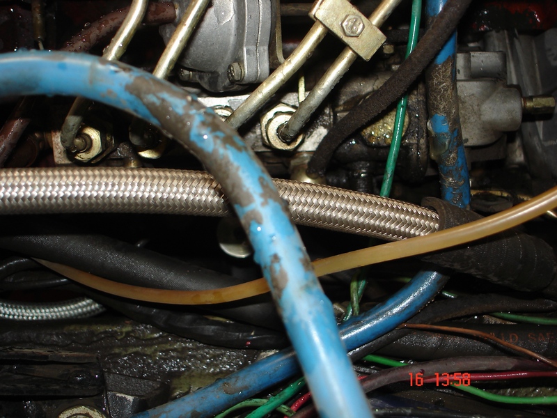

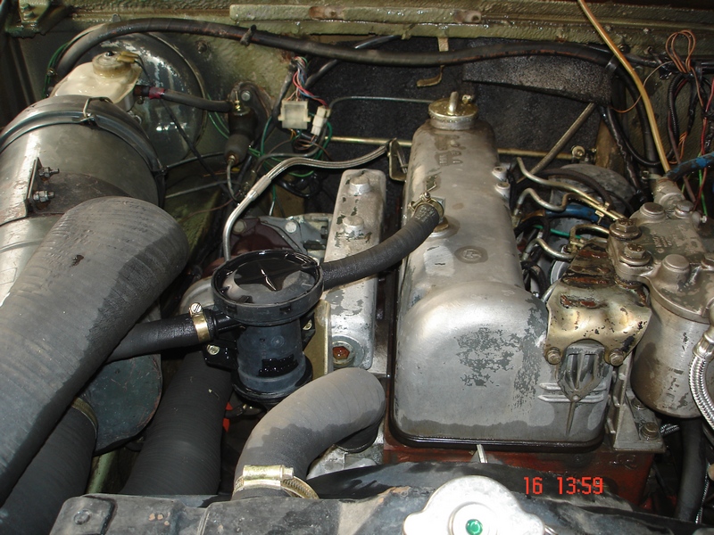

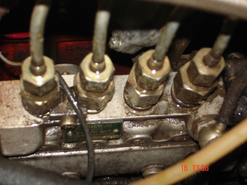

03-16-2009, 04:10 AM #31
As promised, here are the pics of the pump and the OM616 turbo engine. As you can notice, there is no ALDA and its an all mechanical affair with a vacuum shut off.

03-16-2009, 04:23 AM #32
Looks just like the one I posted a picture of.

03-16-2009, 04:30 AM #33
Yep both are turbo OM616, the one you posted belongs to a guy named RRNSS who runs the site www.force4x4.com He owns a LWB version called Judo.
