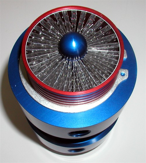

I know I'm not crazy, and I HAVE seen these.
It's an air-water intercooler that looks like a chunk of regular charge piping, but has a bunch of straws that the air flows through, that are surrounded by the water.
I saw it on a website a few months back, had a black background iirc.
I'm not looking for one of those useless "we took a chunk of square core and shoved it in a section of tube" deals, or the box ones.
I also know it's not a laminova core.
I kept telling myself I'd bookmark it, but never did...

these were aftermarket, aluminum, and iirc anodized red or orange on the outside.
I'll look into the landcruiser setup
EDIT: Found the ones I think you're referring to Tom, those are made by "PWR" and aren't the ones I was looking at before.
EDIT: anti-double-post concatenated these, they were two separate posts...
[Image: starburst.jpg]
Found em!
Expensive as hell as well...

07-11-2011, 05:45 AM #5
By your description, sounds like a marine style heat exchanger. I am not sure how efficient it would be for cooling charge air. It's meant for cooling fluids. They sure flow good, though. I thought of using one years ago & talked to the diesel tech at the boat yard I worked at (formerly a jet/diesel Rolls Royce man) & he told me it would "Have to use bloody nitrogen to be worth the space".... Yeah, he is british.
Sorry, computer was slow to load the pic.
Ed

07-11-2011, 06:08 AM #7
I don't really think that unit could be too efficient. The restriction at the inlet & having the body at the same diameter as the charge piping? With a marine heat exchanger, the diameter more than triples so as to not restrict flow.... It sure is pretty, though...
Check out http://www.sen-dure.com/ for ideas, products & ratings. The company you are referring to probably uses one of Sen Dure's cores & makes their own housing.
I would think that some form of disruption of airflow to allow for all of the air contacting the surface area would be nessecary for cooling efficiency.
Now, a marine heat exchanger might cool well if you use your air conditioning direct or to cool water flowing through.
Ed

I know exactly what your talking about Walt. My buddy made a few as prototypes and wouldn't give me one haha (I wanted one for my car).
Yeah you look into one side of it and it looks like a bunch of small straws inside.
I wish I had a picture of it. I seem to remember seeing one around on the net too....
The design is similar to the Ford EGR cooler on the 6.0.
