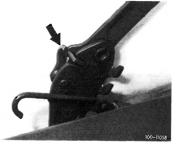

07-31-2011, 05:46 PM #11
I remember on my 116 you could unlock the hood and put it in the up right position whats the trick on the w123?

07-31-2011, 07:17 PM #13
Look for the locking tabs on the elbow of the hood hinges. You push both down to free them from stop slot in the elbow.
