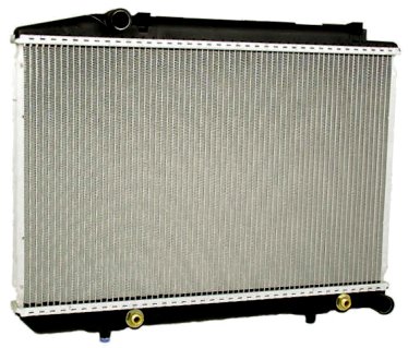

07-28-2011, 01:51 PM #6
Here's a pic of both I was using stock hoses but the transmission lines where to far off as I remember
The om603 300sdl on the left and the 300sd om617 on the right
The om617 is about 5-6 inches narrower than the om603 because of the engine oil cooler witch might help putting it in a w124
The the om603 SDL has it's oil cooler on the RH behind the bumper not right next to the radiator

07-28-2011, 11:06 PM #7
The w124 radiator not the same as the SDL's. It's short and wide, with the end tanks on the sides. Pretty sure the 617 radiator is too tall to fit under the hood. Plus, if this is a gasser, both the inlet and outlet are on the driver's side. Probably just a matter of hose for you.
