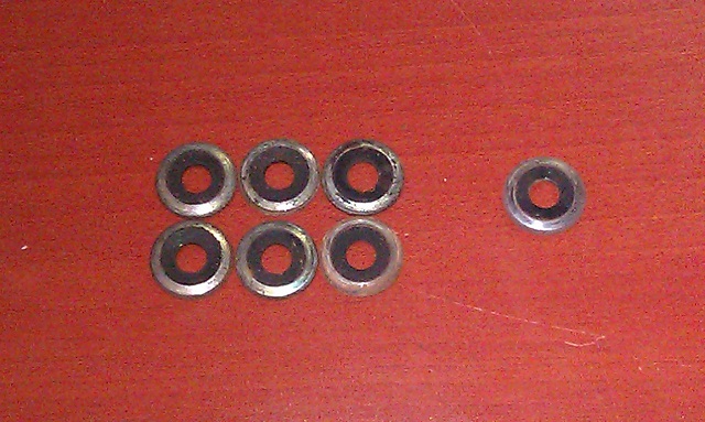

Last-night I installed the professionally rebuild Injectors with Monark Nozzles.
I discovered this was not the first time the injectors were removed; you might ask how can you tell? 7 heat-shields from a 6cyl.
