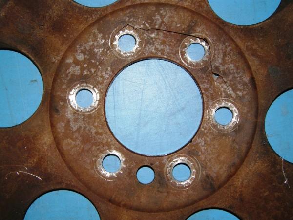

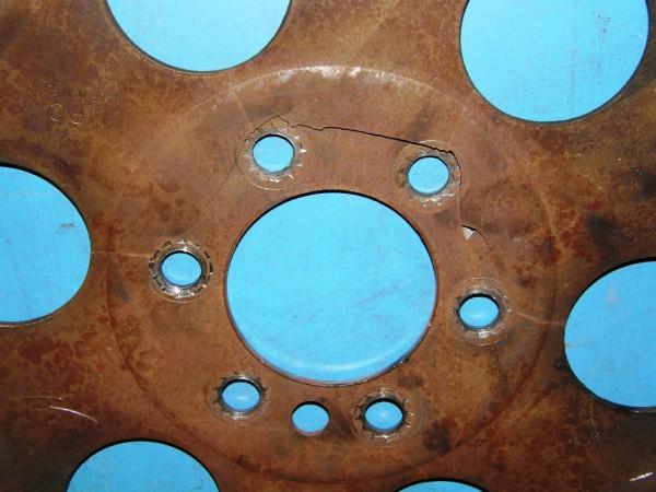

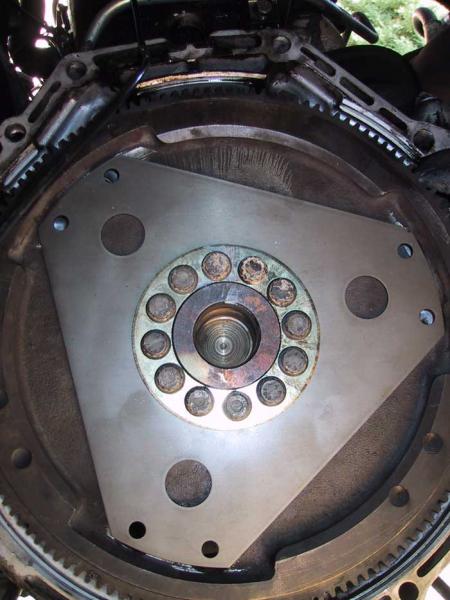

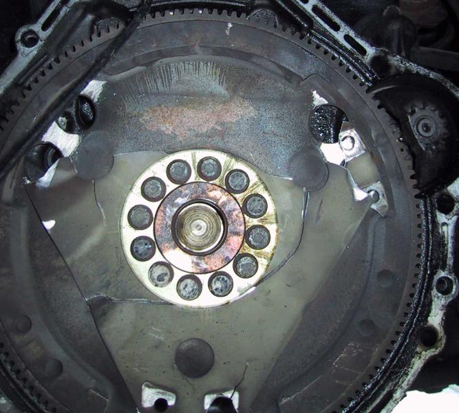

My Flex plate In my Sprint spider cracked.... More of a high pitch "ting ting ting" sound. Like hitting a sheet metal oil pan or valve cover with a ball peen hammer kinda noise. Make noise with and without load...
Hard to see in the small pics, but basically spider cracks everywhere, the white lines are cracks too
Loose torque converter bolts will make the same sounding knock noise

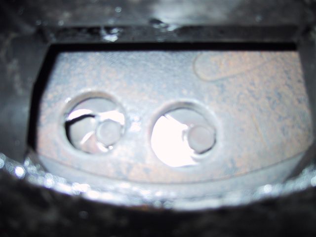

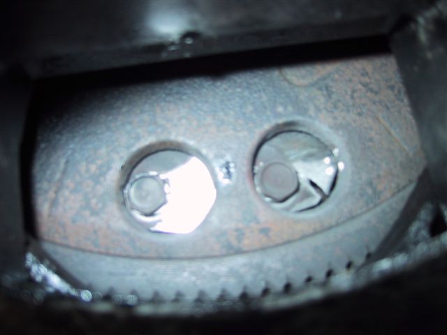

Wow great! I pulled the cover off of the trans (access hole for the torque converter bolts and they were tight with no cracks visible- at least at the bolts themselves- but your pictures show cracks at the center where I would expect them, which is good in terms of extending the hope that I don't really need a new motor.. I did say Clack but it is very like a hammer hitting metal and you do not hear it as a sound from the block it is not deep AND there is at least one you tube video of a similar noise where the guy indicates that it was the flex plate.. thing about the video that got my hopes up is that he says the sound is coming "from around here"
as he has his hand just behind the turbo and that is exactly where this sound is coming from on mine..SO... should I pull the tranny back a bit or pull the engine and tranny

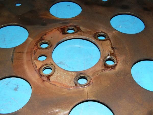

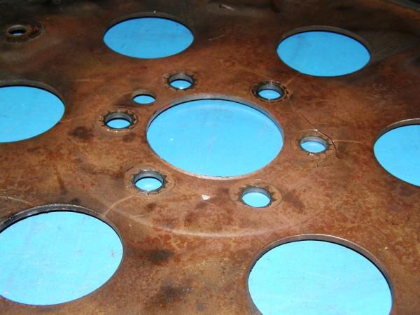

09-19-2011, 01:52 PM #8

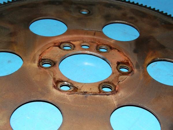

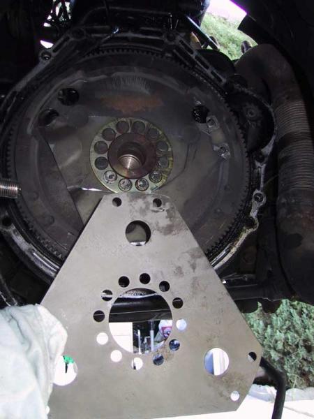

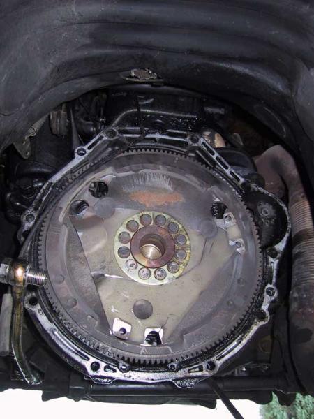

Here are my pictures of a crack flex plate. The noise was horrible! You could easily tell it was coming from the back of the engine.
Enjoy.

09-19-2011, 03:08 PM #9
Hi thanks, yes I have seen those pictures in my searching.. I just started and moved the car about twenty feet.at start up, once again it sounds fine... it is when you come off idle that you begin ti hear the sound and as it warms up or you go for a drive the sound gets progressively louder/more prominent.. it never sounds like it is coming from that area and the mercedessource article/ alert indicates people have been fooled by the sound. I read that torque convertors actually "swell" as they warm up or fill or pump up.. the sound does not have that deep quality of a crank/rod journal and I dont know what a wrist pin would sound like or piston slap but it seems to me those would be constant .. thank you I'm going to pull the trans this evening.
