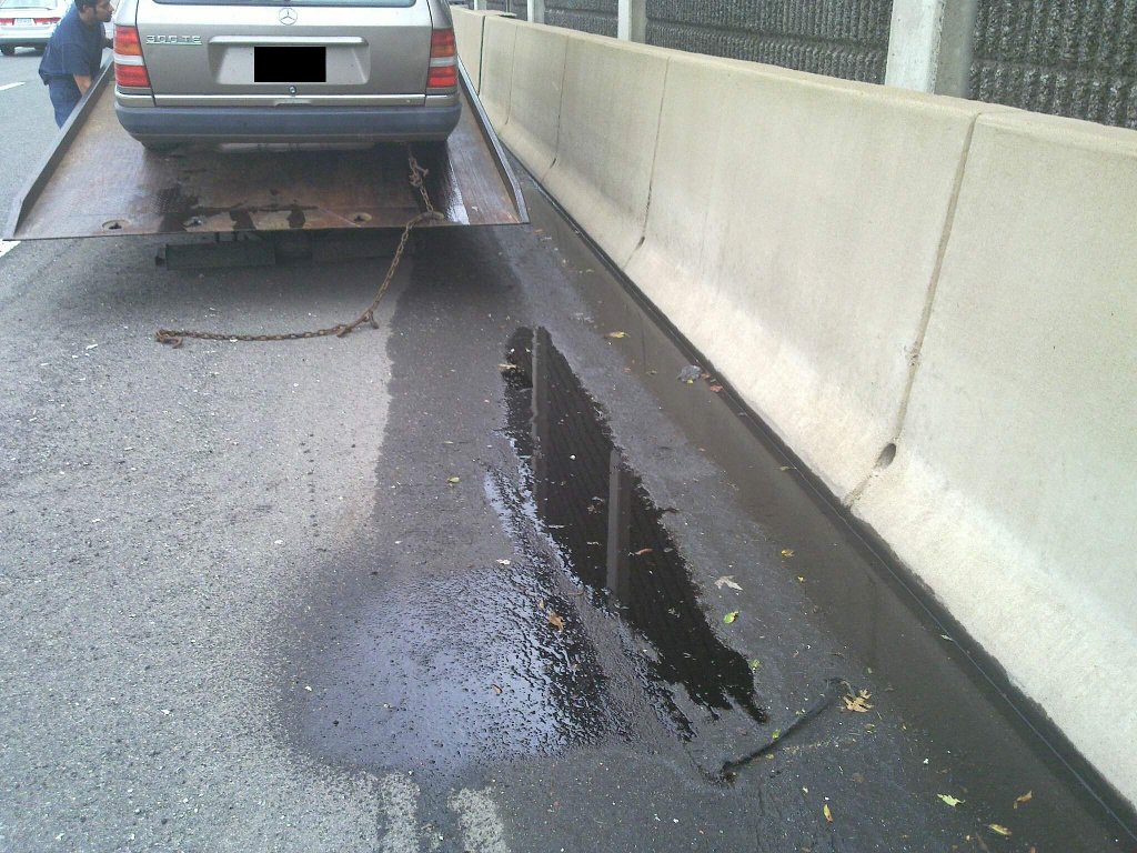

So I ordered a 1990 300TE in the mail.
For some reason I did a google search for 300TEs on any craiglist, and found one in Texas. Not running, and sat for 4 years in a garage. I convinced the dude to let me truck it out to the east coast.
After about a week it arrived. Didn't start up even with a new battery and some fresh gas. So I fought with the Evil Gasser Fuel System for a while. A filter and new plugs didn't do it either. Ended up bleeding the gummy old gas out by cracking the injector lines, and it started right up.
I drive it around for a bit and it seems fine, bit low on power. The oil pressure gauge was wonky, refused to sit between 1 and 2 bar, and would only jump between the two. Fuel gauge totally dead, although the reserve light seemed to work. I take it onto the highway to clean the cat out for the 2 year emissions inspection, since I flooded it with unburnt gas. Cruised along a good 15 miles or so, then disaster strikes. Presumably a vacuum line or something popped off the transmission, and it shifts in 2nd at 65mph, 7000rpm. I slow down to 55, and wonder if I was going to drive the remaining 10 miles or so to the inspection station in 2nd gear.
That was not to be the case. There was a crunkley noise, and the oil pressure dropped to zero. Pull over and cut the engine. Start again, still no oil pressure. Apparently 6000rpm was still too much for a tired oil pump, or at least I hope that's what it is. I get out and there's a growing puddle of oil coming out of a small hole in the oil pan. Ended up getting a tow.
I guess the OM603 plans are accelerated now. I'll have to do the DMV paperwork the long way too. Started prepping the engine for pulling right away. Here's a pic of the oil pan hole, it's more of a crack:

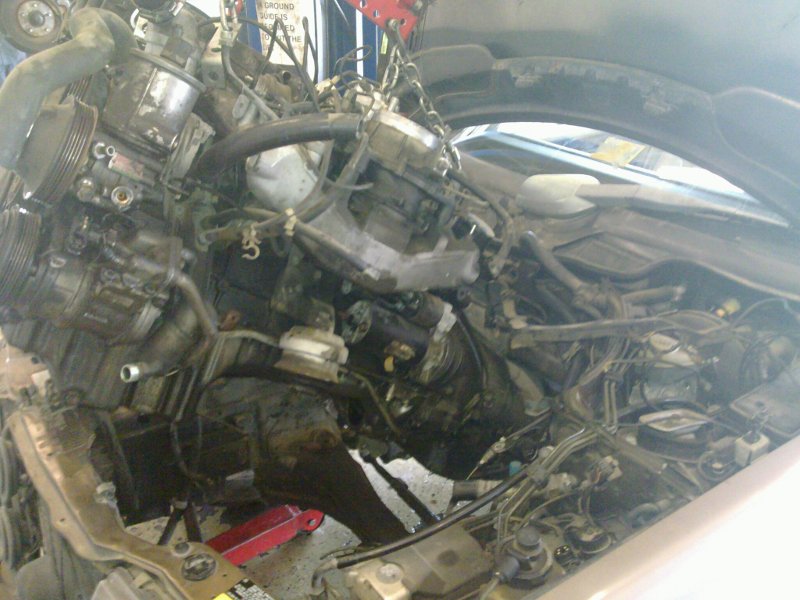

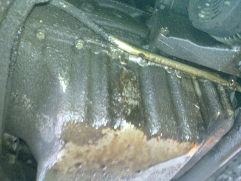

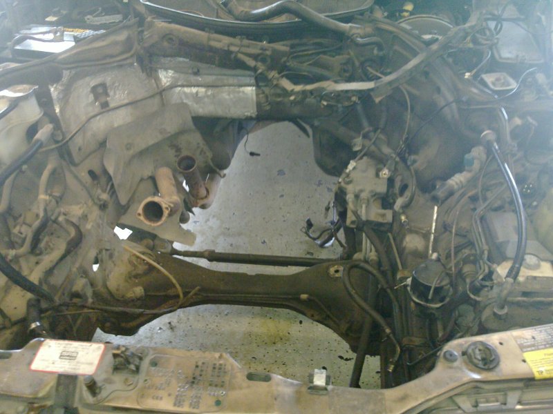

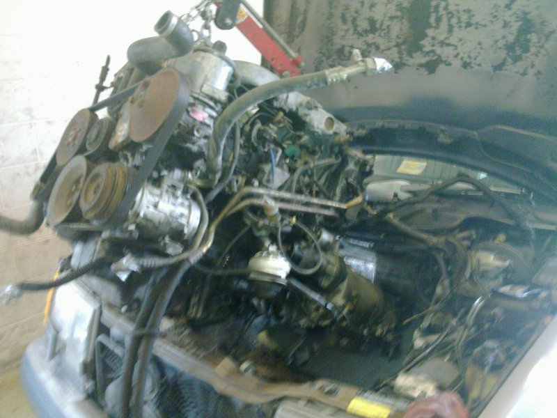

10-01-2011, 05:26 PM #5

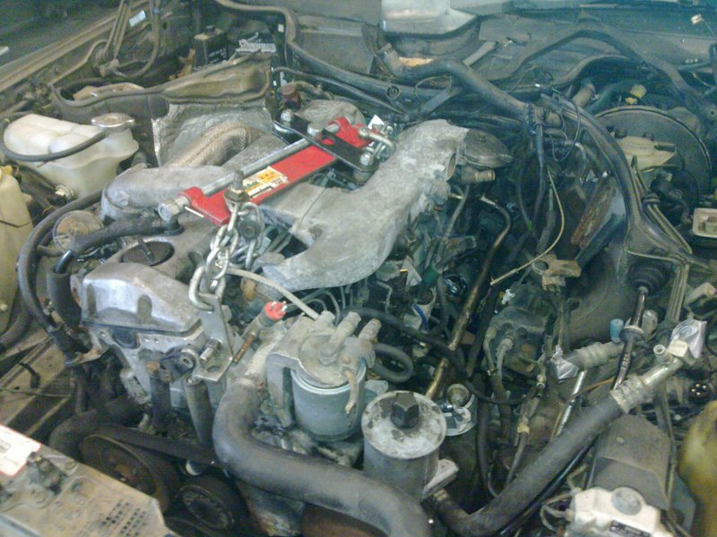

I've yet to take apart the 103. My theory is leaning towards "threw a rod" now.
I dropped a 603 in today.

10-01-2011, 08:20 PM #6
Nice, a w124 engine bay is quite big..
Kozuka

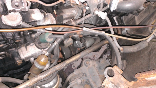

10-09-2011, 06:10 PM #11

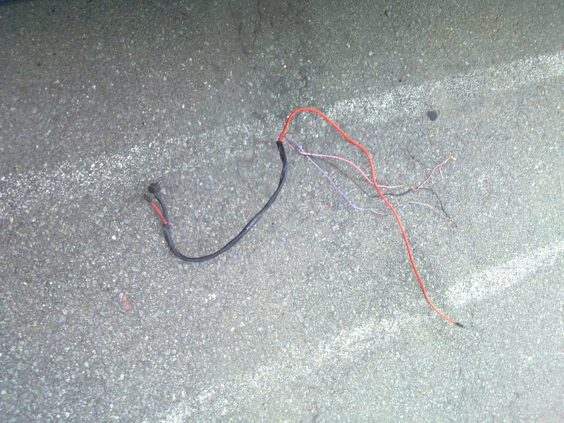

So I wired up the glow system, and it starts easily now.
I extracted the harness from the fusebox:
Seems they slightly rearranged the X26 connector inside the fusebox in 1990. Wasn't hard to splice the differences though. Still have no glow light though, I tried to use a 93 300D cluster and the glow harness was different (two wire instead of 1 wire).
The big 6 or 8 gauge red wire bolted right onto to the X4 power block, aka pile 'o live connections direct from battery inside the dash.

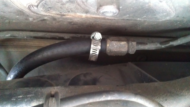

Next is the fuel tank. I'm currently have diesel in an extra windshield washer reservoir.
Today I drained to the tank by shorting the fuel pump on. Next is bypassing the electric fuel pump.

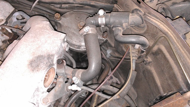

Heat was easy, just grafted some heater hose and used the TE aux pump. I get the feeling that flows in the opposite direction of the diesel, but hey heat works.
Fuel tank was more grafting to bypass the electric pumps. I used the gasser tank, and adapted the fatter supply opening the gasser tank has to a smaller hose that was then clamped to a fitting for the hardline. The gasser fuel hardline has fittings on the end of it, I extracted the female ones from the gas rubber hoses and used them.

03-15-2012, 06:13 PM #36

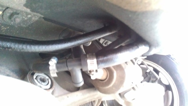

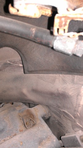

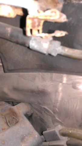

Here are some pics of various hoses. I'm wishing I had replaced that leaky fuel tank return line now...

03-17-2012, 12:12 PM #38
so your return line is mostly all rubber from the tank on up?
ashedd
03-17-2012, 05:23 PM #39
Nah it clamps onto a hard line a few inches afterwards. That top hose is the stock return line.
