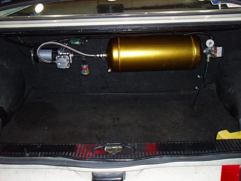

01-18-2009, 11:34 AM #16
Now that would be a cool use for my onboard air system (If I still had an automatic) Big Grin

nice air system,beats my test system all to h--l,got a old co2 bottle with a accy regulator to adjust the aldy pressure to fake if on turbo pressure.
come on now, how do i figure how much hp gain i should get if i can burn all the fuel with the ip maxed out,some one stated that the pump could supply fuel for 180hp max,dont know if thats turned up or not.
