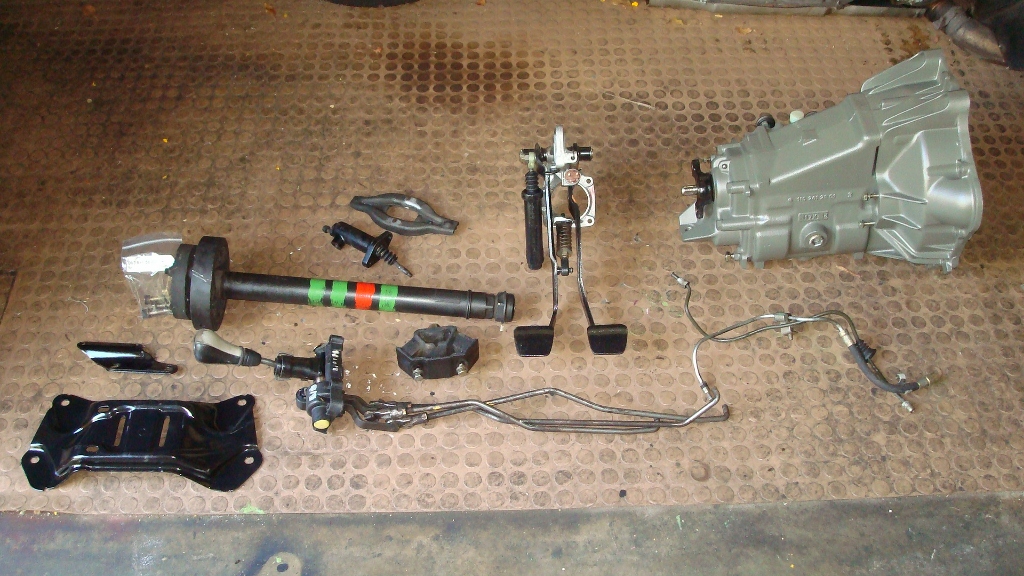

First, a STD thanks to Dropnosky & SurfRodder for ALOT of info on the 4 speed conversion. You helped me get over my jitters and concerns of taking the leap.
This came from a Euro 300D 5 cylinder. Because after 4 years and no luck finding a 5 speed, I am going to settle on a 4 speed.
I am attaching a picture of the 4 speed I located. I should have it shipped shortly. I need a Flywheel, speedometer cable, clutchkit, and some odds and ends. Any 300G flywheels out there for sale? I will add more once I start this project.

Nice looking "Iron" trans your going to get. Looks like you have most of the pieces there for the conversion.

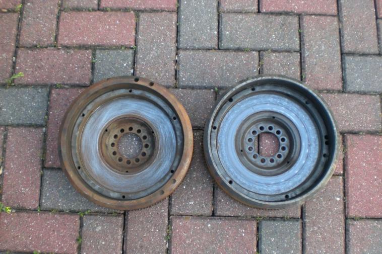

I thought you were using the "G" to refer as the 300GD flywheel which takes a wider diameter clutch.
Here is a pic of a comparison between the 300D and a 300GD flywheels compared side by side
[Image: gwagen-flywheel.jpg]
I don't have any more information on that eBay "D" flywheel, but the ad states shipping is €65.00 which is $89.75 US.
But $300.00 is the market price for a "D" flywheel. You can however get a new "G" flywheel from the Classic Center for over $600.00.
