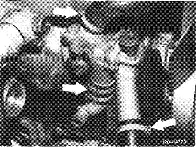

Is the tstat the part connected to the neck? because that what i saw that was held on with three 10mm bolts.
If so, in that pic, mine doesnt have that round thing stickin up out of it. where it looks like that thing would screw in its just an empty pit.
hmmm Huh

10-29-2011, 10:55 AM #9
The T stat should be behind the neck here's a better picture
