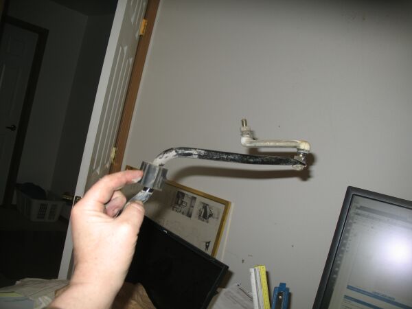

Purplecomputer
Slowness 220D
897
01-03-2012, 12:37 AM #11
(01-02-2012, 09:40 PM)serverman777 rockauto.com.
They sell the cheapest parts on the web and got everything
Is this what I should replace? if so i forgot to take pictures but they are dry rotted on my car.
[Image: 2013261081.jpg]

JustPassinThru
W123 and W124
491
01-03-2012, 01:22 AM #12
Those are rear sway bar bushings. I just happen to have a rear sway bar beside me (finger is pointing to a bushing). If dry-rotted, by all means replace it. Might not be the whole solution though.
JustPassinThru

Yeah those are all cracked and dry rotted. im going to replace those
(01-05-2012, 07:12 PM)ronnie two differant tyres? That does not help anything. Should not be the problem though.
Used tires, with good tread i only got both of them for $50
This post was last modified: 01-06-2012, 11:34 AM by Purplecomputer.
Purplecomputer
01-06-2012, 11:27 AM #23
(01-05-2012, 08:20 PM)vstef_is I'm still selling the "rear arms bushes" story...
Just follow the rear arms towards the underside of the car, where they connect with the chassis, look for rubber - that's my bet...
serverman777
226
01-06-2012, 11:44 AM #24
The tires look fine. I got 4 different brands on tires on my Benz. Your wear looks even also.
