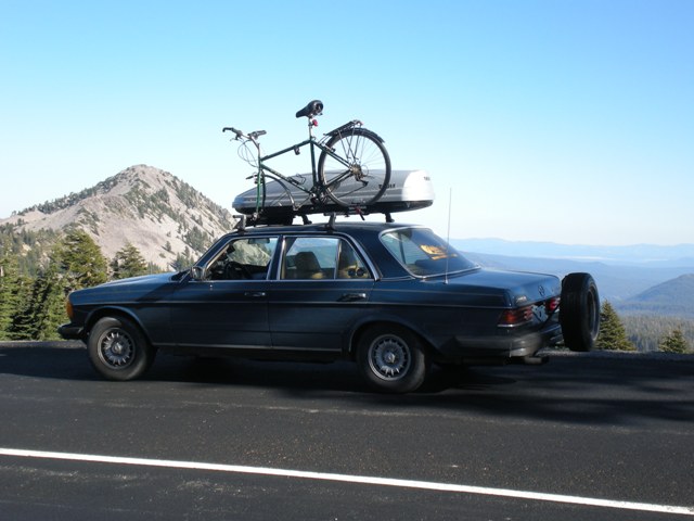

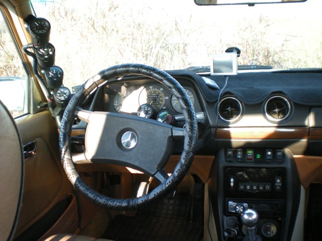

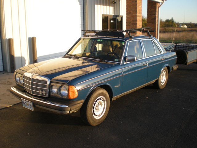

Hi, Im a new member. Just wanted to post a few pics of my baby and a few stats.
350,000 miles, 8 supplementary gauges, two aux fuel tank levels, two fuel temps, turbo boost, EGT, Lift pump outlet pressure. Twin trunk mounted fuel tanks, 800 mile total range. Tow package/continental style spare (depending on trip), roof mounted toy carriers.
1985 300SD 2.88 Rear end (bright blue powdercoat under all the oil)
1981 240D 4-speed manual
3 inch exhaust with glass pack (they made me put it on)
Blocked off EGR.
EMPI aluminum shifter, stock boot, custom shaft to work with both.
Basically, Ive tried to rig this car up to be as fast as possible top speed for highway cruising. I make a lot of road trips, for work and pleasure. Other than that, Ive added gauges so I can watch everything, added tanks so I don't have to stop, and added places to take all my toys with me on the road.

You described 7 gauges, whats the 8th?

Thanks! Im slowly trying to make it impossible to see outside! whoops, the 8th is fuel restriction before lift pump. What id really like to do at one point is make an actual A-pillar multi gauge pod. A friend of mine has a pretty decent home made vacu-form machine rigged up; I need to carve a gauge pod, or make one out of clay, then we can make some styrene test pieces.
It wasn't fifteen minutes since I had all those gauges tentatively rigged on the pillar when I caught the topmost one with my head and ripped it off! Hence the closeness of it to the next one down. I think the center of the dash, or up above are far less risky locations and look nice.

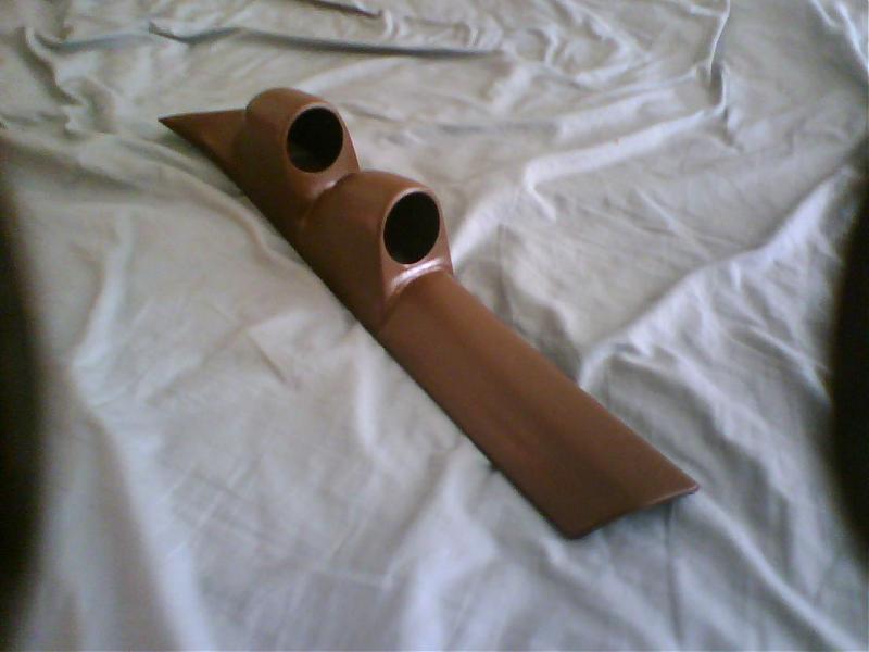

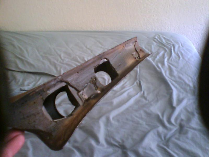

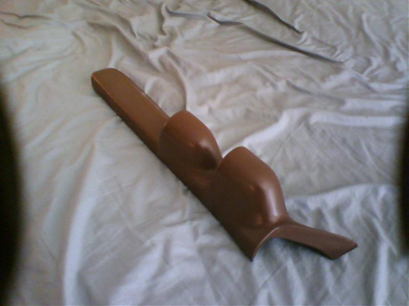

Here are some archive pictures of one that might help you along.
