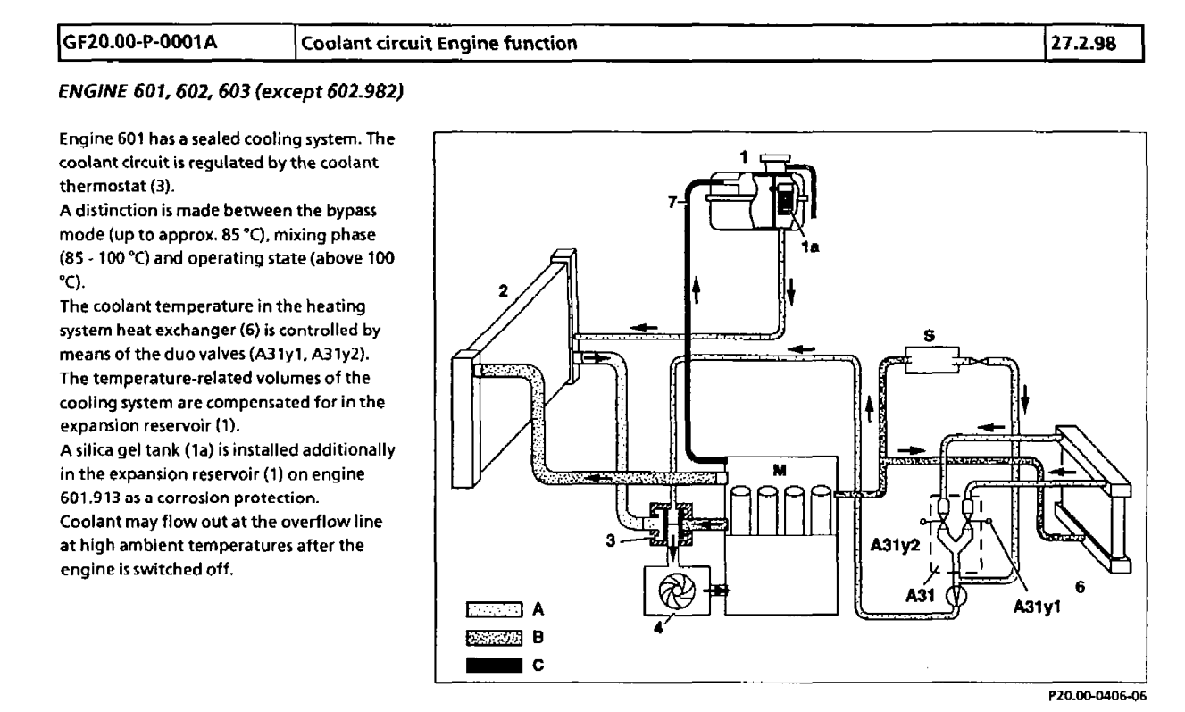

03-13-2012, 03:01 PM #15
Here's a w124 vs a w126. On the w124 the overflow hose goes to the engine, on the w126 it goes into the radiator.
Presumably attaching it to a high point of the system is important for air removal.

Attached is the flow diagram.
03-15-2012, 06:27 PM #23
Have you verified the 100C temp with an ohm meter and IR gun?

03-17-2012, 07:23 AM #24
(03-15-2012, 06:27 PM)winmutt Have you verified the 100C temp with an ohm meter and IR gun?
Thanks alot! No I have not. I feel like its no use measuring any temperature before my flow peoblem is solved.... Sitting in my car right now. Im so tired of it....!
Jesus.. Haha
And now it leaks water out of the heater at drivers side foot heat.. Jesus

03-19-2012, 05:09 PM #25
Hi again! Got an answer on a email i sendt to a diesel guy!
But im having a hard time this will fix my issue... can anyone else try to interpite the email? :-)
Hi Christian
You might be having an issue with the fuel thermostat:
Here is a link to a picture of the part:
https://mercedessource.com/node/2879

03-19-2012, 05:33 PM #26
Haha they linked one of their products.
The fuel thermostat is slightly related to the cooling system. But it has nothing to do with your problem for two reasons.
First the thermostat itself (pictured) has nothing to do with coolant, instead there is an additional fuel line loop that the thermostat routes fuel to, going to one of the heater "hoses", actually more of a metal coolant pipe intertwined with metal fuel lines. Second this heater hose/pipe is just an empty pipe used for the heater. It is not going to stop the cooling system from working since it's not the main part of the coolant circuit.
As for now, I'd try removing the main thermostat (not the fuel one), since it wouldn't be the first time multiple thermostats in a row turned out bad. And the radiator isn't clogged, is it? Not sure what the best way to test that would be.

03-20-2012, 09:56 AM #27
Still sounds like an air pocket to me! I Just had this problem with a Subaru this weekend. it took an hour to get all of the air out same thing no circulation and kept getting hot
They make a vacuum filler system for cooling systems that pulls a vacuum on the cooling system and then it auto fills by sucking in the coolant. It's really cool and never leaves any air pockets. I really need to get one for my selfBig Grin

03-20-2012, 11:48 AM #28
(03-19-2012, 05:33 PM)aaa Haha they linked one of their products.
Thanks for reply.
Ive cleaned the clooling system with ecitric acid(dont know if i spelled that right) So i dont think thats the problem :-<
But maybe I'll take out the thermostat and try that!
I've done it before... but that was before I changed the waterpump...
Any more good idea's?? :- )

03-20-2012, 02:48 PM #29
I don't think citric acid would fix a thoroughly clogged radiator. It seems to be more of a preventative maintenance procedure.

03-21-2012, 11:09 AM #30
(03-20-2012, 02:48 PM)aaa I don't think citric acid would fix a thoroughly clogged radiator. It seems to be more of a preventative maintenance procedure.
any tips??

03-21-2012, 02:52 PM #31
Well where are you with it now? I'd only look at the radiator again after removing the other potential obstruction (the thermostat). With that out of the way and if the problem's still there, I'd do something crazy like yoink the upper radiator hose off and see if coolant gets pumped out. Or maybe the other way around, yank the lower radiator hose and block it off, to see if the system will drain out of the lower radiator opening.

03-22-2012, 12:23 PM #32
I'd use a garden hose keep disassembling til I found the blockage... Check the radiator, pull the thermostat check the head/block. Drain it after you figure out where it is.

03-22-2012, 02:09 PM #33
I'm a little late on this one, but why not use vacuum to suck the air out when flushing and refilling, etc. In theory it sounds like it would work pretty well, all you would need is an extra radiator cap to sacrifice by drilling a hole and then sticking a hose into it, going to a vacuum pump, or I bet with a tee and a small valve one could even use the vacuum system in the car to to avoid having to keep making vacuum with a hand pump
