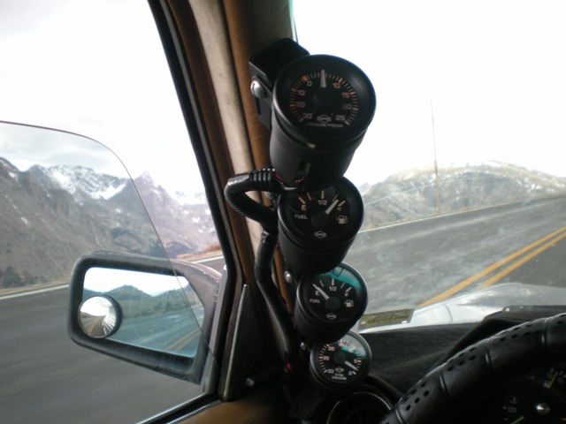

Interesting, Once the turbo kicked in, it ran pretty normally, even way up high. The boost seemed to hover around 5-8 since I was driving pretty slowly. Heres a pic of mine as well, I was going about 10mph gawking.
I was able to compensate, but several times I made the mistake of parking on a steep incline to sight see, which caused most of my problems when I tried to move forward again.
I guess I wont worry about it too much then.
