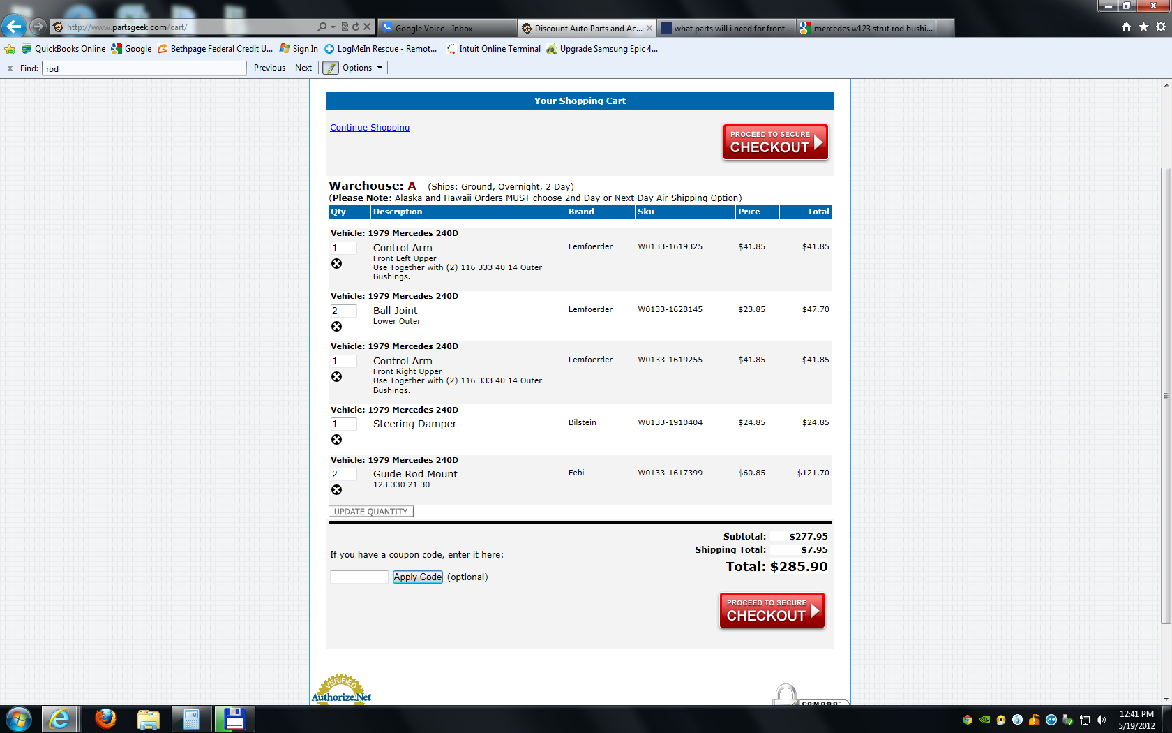

05-19-2012, 11:44 AM #11
Is all of this correct? I drive about 200 miles a day doing service calls for my job (diesel is paid for by the boss Cool)
So the front suspension is all weak, wobbly, every time I go over bumps The car jolts either to the left or right, not to mention It sounds like the whole car is going to fall apart
