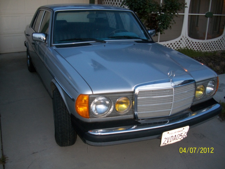

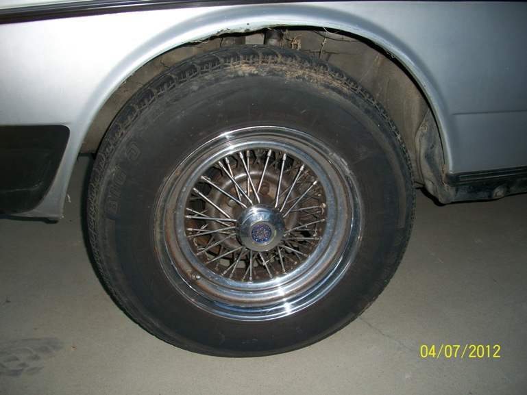

After 4 years I have finally convinced my dad he needed a diesel Benz, so earlier we went and got him one. Its an '83 240D, with a manual transmission and manual everything else as far as that matter goes (except for electric sunroof). Its silver with black interior, with some pretty boss spoke wheels (Mercedes wheels?, who can tell me about them?).
Now, aside from all of the regular maintenance stuff I plan on doing (oil/filters/flush coolant/etc.) because the car sat for 2 years, is there anything else I can do to maybe help with the sluggishness a little? Also this car has some serious blowby, hopefully it goes away once the car starts getting driven, but it does have about 300k miles on it. (luckily the parts car in the back only has 170k

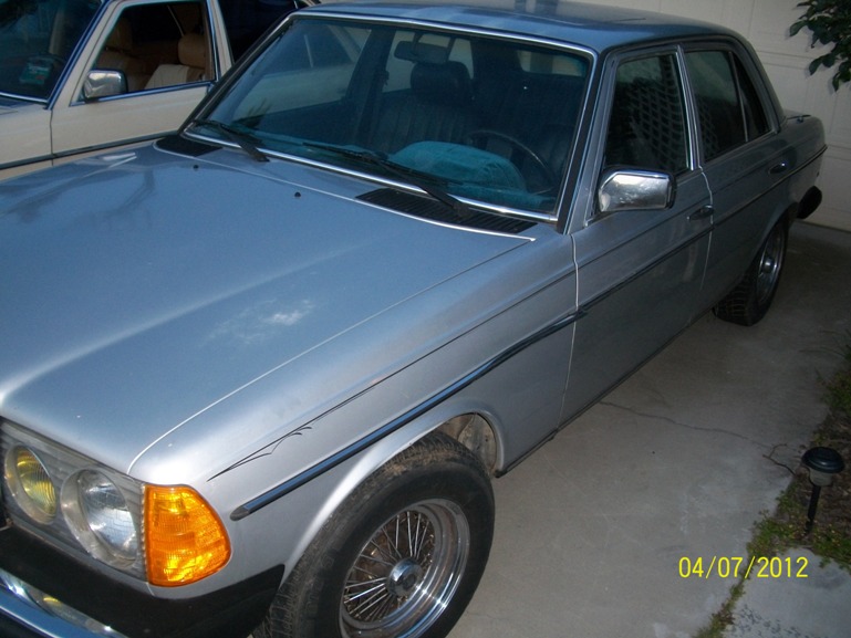

well, youll need to get rid of those pinstripes and then the car will go faster.
