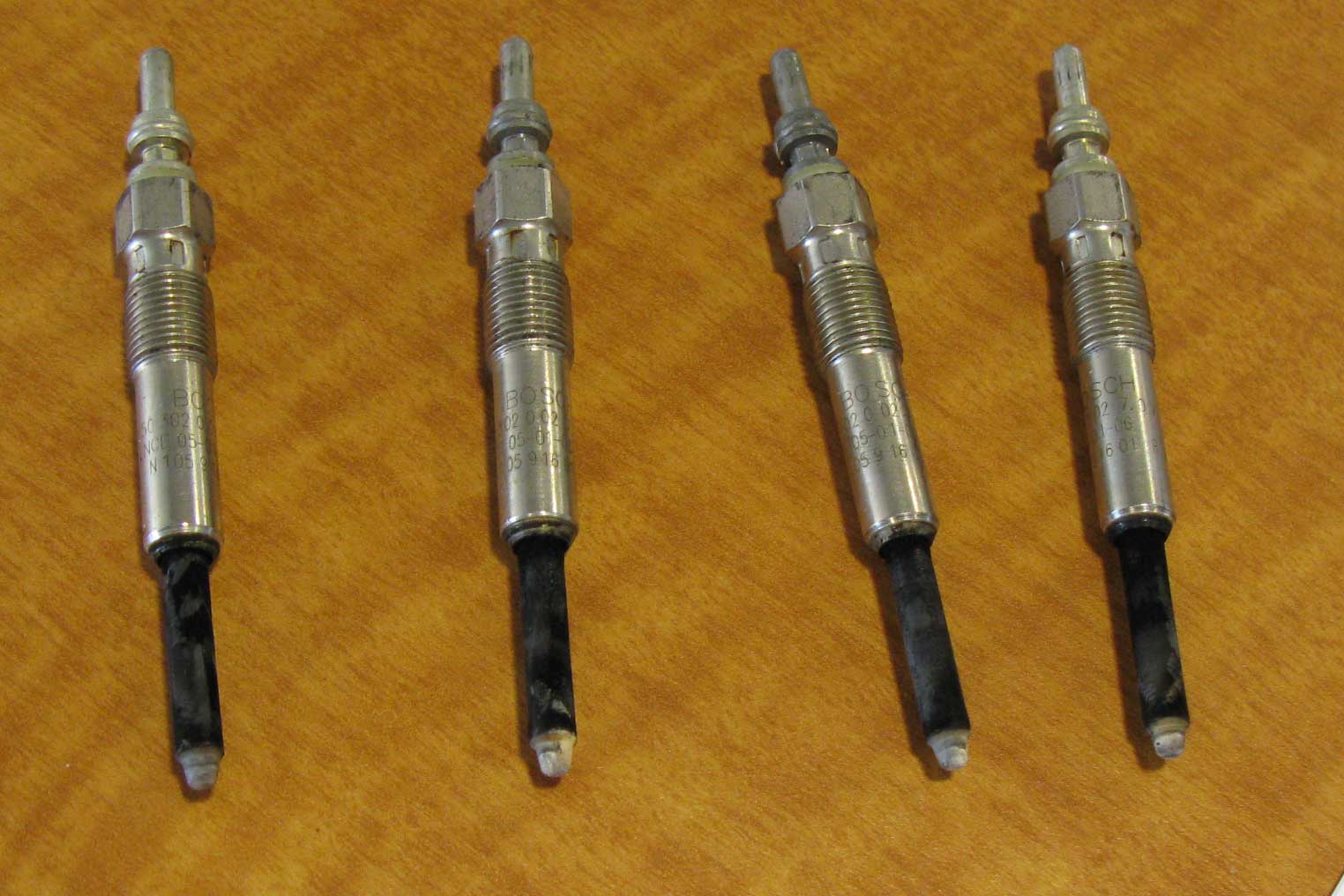

I recently checked in a 2009 E Class with the 642 V6 Bltc Diesel, when I pulled the vehicle in the check engine light and glow plug light were on.
After diagnosis I found the tips of number 3 and 4 glow plugs completely melted. After further testing it appears they were just defective and there was not too much amperage or voltage sent to them. These are rapid heating ceramic glow plugs that will pre glow an engine on a below zero morning as fast as you can turn the key to start it. Im begining to wonder how these will hold up through the years after experiencing this problem with a brand new car.

05-07-2009, 08:31 AM #1

02-08-2011, 10:23 AM #12
Nothing is funny about broken GP tips. At all...
[Image: prechamber1.jpg]
