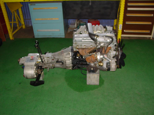

Where'd you get that 2.9l 602?

06-25-2012, 01:17 PM #3
Quote:Where'd you get that 2.9l 602?
From a Dyno test lab. I came with a Getrag 717.433 5-speed and in a nicely constructed wood crate with MBZ logos on it.
The engine had only 100 hours of testing when I got it.
Here is a picture of it with the Atlas II transfer case mounter to it:
[Image: good-to-go2.jpg]

913
06-25-2012, 01:55 PM #4
Sweet.
Why MW vs M? You can get 6mm M elements easily off used 98-99 cars. The similarly bored-out 3.5L used 5.5mm elements, so 6mm should be a boost over stock. For larger may as well go for 7.5mm, and it won't be from the US.
