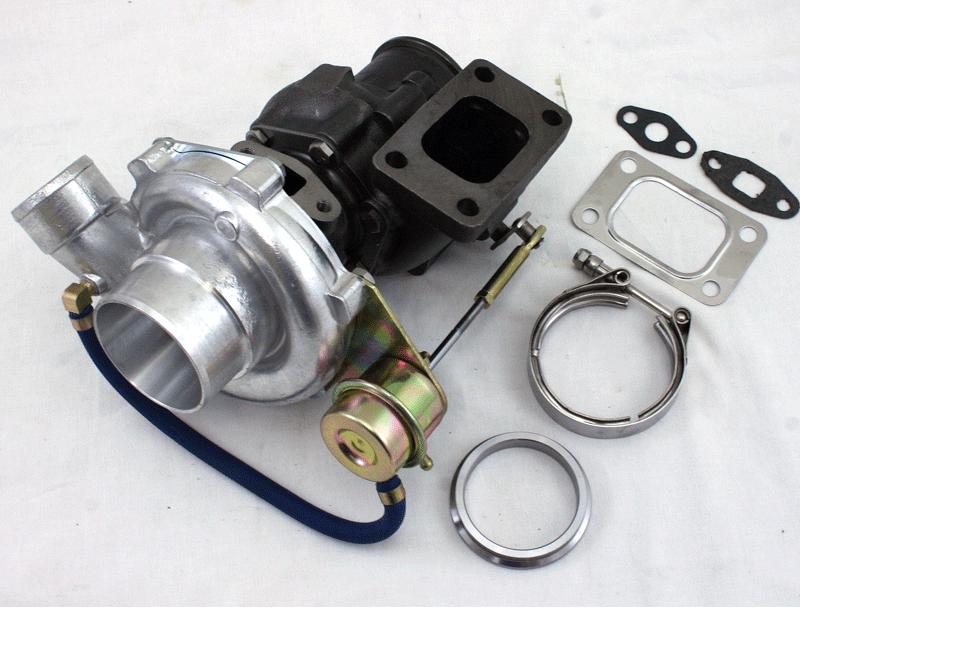

Here's a turbo that i might consider, (T3/T4 V-Band Hybrid Turbo/Turbocharger 8psi internal WG) copy and paste on Ebay (i having issues with copy and pasting address)
About the oil feeding, From the looks of it, it seem that if i install the turbo the oil feed holes will be horizontal, will this be a problem
8 psi? That turbo is for a gas engine. Look into an HX25 or HX30. You'll need at least 14psi. The stock turbo will put 14 down pretty easy.
