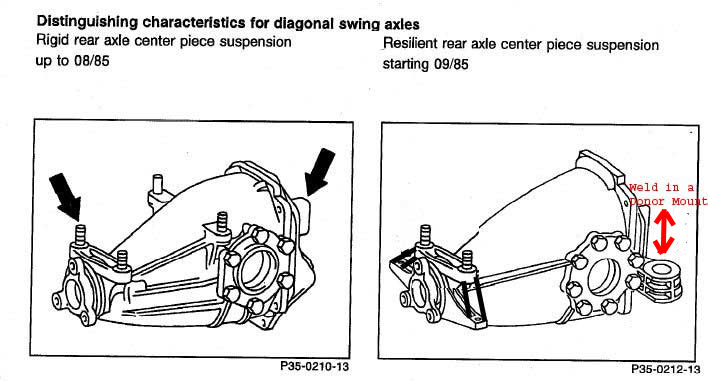

06-09-2009, 01:25 PM #16
(06-09-2009, 12:57 AM)Gasoline Fumes What can I do with a 1987 2.47 W126 LSD? Any way to make it work with my 2.88 W123 gears?
The other option besides swapping diff housings, is to surgically graph (weld) in the center part of the sub-frame of a 2nd Generation W126 into the w123 sub-frame so you can use the later differentials.
(06-09-2009, 12:46 PM)SurfRodder .....
anyway, your 2.88 gears will swap into any w123 housing (185mm ring gear) but not any of the 126 housings (210mm ring gear).....
Actually not all w126 had the 210mm housing, only the GAS version of the 126 had the 210mm Gear. The DIESEL 126 (300SD) had the 3.07/2.88 185mm housing.

The second generation had both sizes as well. The 1.1 liter 185mm was in 2.88 (300SDL) and a 1 liter 185mm 3.46 (300SE,SEL). The 1.3 liter 210mm case was offered in a 2.47 (380,420,500,560SEL) and a 2.82 ratio (350SD,350SDL).
Here is the difference between the two style of mounts.
Image provided by peachparts.com member Johnhef
This post was last modified: 06-10-2009, 07:38 AM by DeliveryValve.
06-09-2009, 06:07 PM #18
(06-09-2009, 04:37 PM)winmutt
(06-09-2009, 01:25 PM)DeliveryValve Actually not all w126 had the 210mm housing, only the GAS version of the 126 had the 210mm Gear. The DIESEL 126 (300SD) had the 3.07/2.88 185mm housing.
I think its more 2nd gen w126 than gasser vs diesel. I could be wrong I have *never* seen a 2nd gen diesel SD in the yards....
The first Generation W126 had both 1.1 liter 185mm (300SD - 2.88/3.07 same part number for w123 300D) and 1.3 liter 210mm (500SEC - 2.24, 380,500SE 2.47) casings.

06-22-2009, 06:06 PM #37
(06-22-2009, 01:05 PM)SurfRodder .....
so how'd that work? Do you machine the 123 subframe to move the mounting hole fore or aft 3-4"?...or do you modify the newer style diff to mount up to the old subframe?
Remember the rear mounst is bolted to the body's floor, more specifically the beam that runs across. So it should be a matter of drilling new holes for it. But it also bolts to the subframe, so to make it work, you would need to weld in donor piece from the 2nd gen subframe.
For the front two bolts, I think making a custom bolt in bracket with stock 2nd gen bushings which will mount in the stock w123 subframe front location would work.
[Image: attachment.php?aid=703]
This post was last modified: 06-22-2009, 06:09 PM by DeliveryValve.
