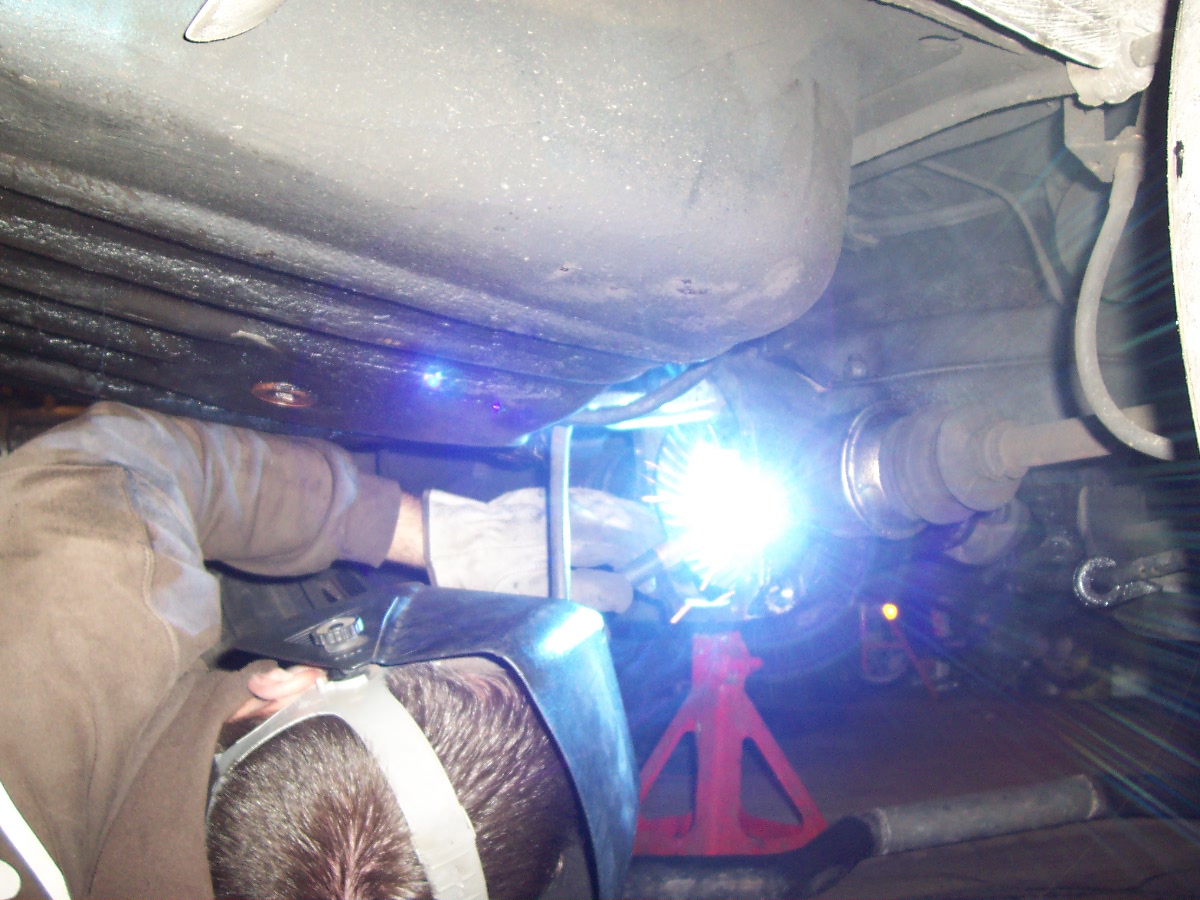

did someone say weld up the diff?
http://www.pirate4x4.com/forum/showthread.php?t=763645
Yeah, y'know, but you need that heavy duty clutch and driveshaft for it to work!
(12-23-2009, 04:20 AM)CID Vicious Yeah, y'know, but you need that heavy duty clutch and driveshaft for it to work!
Sorry, I thought you were giving me a little 'wink wink' since the guy in the thread appears to have welded his ring and pinion together, rather than his spider gears. I don't know whether it's a real fuckup or just a guy who'll go the distance for a great internet joke, but either way it's kuh-lassic .
I'd be willing to find a spare diff and weld up one. Just swap them out when I feel like getting frisky for awhile, and when I want to drive like a sane man again, swap the open back in. Maybe even weld the 240D diff (I've heard the manual 240D could have been equipped with a 3.72, and has at least a 3.46, I could get a 3.06 or even higher diff for long trips and getting better gas mileage. Since the gears go as high (numerically low) as 2.04 I believe, I could get the same mileage as a 300D or better as long as I wasn't getting on the gas, and it still would be faster than a modded 617a . Those high gears could be real useful if the 'whole hog' twin turbo setup was ever installed, which it could since the cost of a pair of junkyard T3s, rails, injectors, a few sensors and a Megasquirt system wouldn't be much at all considering the stupid power we'd be talking about.
