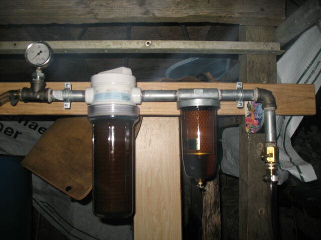

Well, I'm not sure if this is what you're asking, but...in my WVO refinery setup, I'm using a 110-VAC 7-amp carbonator motor, driving a Procon pump, which pushes (already hot-centrifuged) cold vegetable oil through two filters in series; the first is a Whirlpool household water filter with a 5-micron element (bought at Loew's), and the second is a Goldenrod 15-micron water-block fuel filter (bought from Dutton-Lainson). I have a liquid-filled pressure gauge before the first filter.
When the filter elements are fresh, the oil gets pushed through at 20 psi, unless the air temperature is below 45 Fahrenheit, in which case it's 40-50 psi. When the pressure hits 100 psi, that's how much the Whirlpool is rated for, and I figure it's time then to change both filter elements.
This motor+pump has no trouble at all reaching 200 psi, to the centrifuge, if I let it (i.e., if I fully close the bypass valve).
A cheaper way, might be to rig a clothes dryer motor via pulleys-and-a-belt to a power steering pump.
Hope this helps...

In case the above is unclear, here's a pic. Pressure gauge, Whirlpool filter, Goldenrod filter, and then a Dramm valve. And then into my 5-gallon mixing bucket it goes, through clear PVC tubing. All piping is galvanized steel, all joints sealed with Teflon paste. If you duplicate this arrangement, *make very sure* that the Dramm valve is open before you start the motor!!! (--unless you are a terrorist, in which case you want to close the Dramm valve, start the motor, and then run like hell muahahahaha....)
Am I even close, to addressing what you intended to ask?

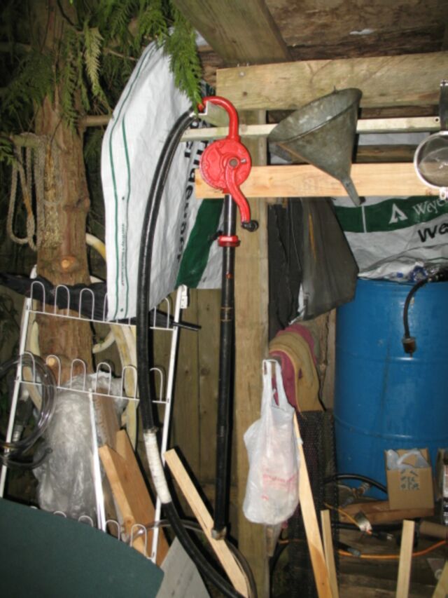

Ah, now I see (I think). You're looking for one of these hand-cranked barrel pumps then. No idea where to get one, or how much they cost; I bought 35 gallons of kerosene on Craigslist, and the seller threw the hand-pump in for free, along with the barrel. Perhaps at Harbor Freight or the like. A home water filter such as the Whirlpool would be easy to plumb into the spout. It will produce the necessary 20 psi of pressure, easy.

That's what I have but it is super hard to pump through a filter.
Then if you want the electric version of the barrel pump you're looking at a couple of ben franklins.

The one I have would have no problem pumping through a filter. Perhaps yours needs disassembly and cleaning.

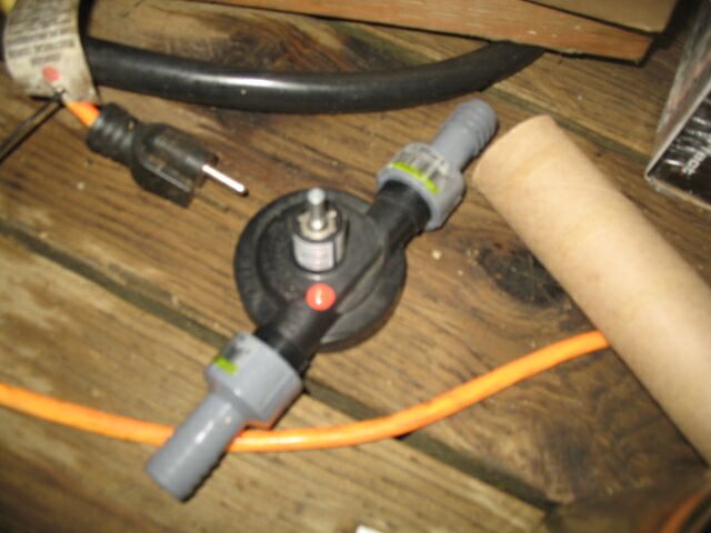

Alternatively...electric-drill-powered fuel pumps do exist; here's the one sold by Diesel Secret Energy for $29.99. It's pretty weak though, you'll need a strong drill of at least 2000 rpm to make it useful.

well the barrel pump can move oil fine. Till you attach a filter, then it's a bitch. I think them little drill pumps are probably a bit tinker toy.

Hmm. My barrel pump really *gushes*! I don't doubt it could push 20 psi. If yours isn't gummed-up inside, then perhaps mine has lower gearing than yours. It's Weyerhaeuser surplus.
