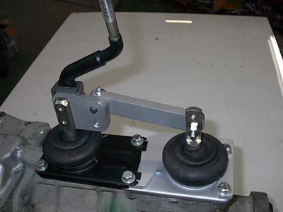

12-08-2018, 10:30 PM #22
Looks sweet, as for the shifter have you considered relocating it with something like this?
ilovemybike
11
12-09-2018, 08:06 PM #23
I played with that idea, but it shifts pretty good as it is.
