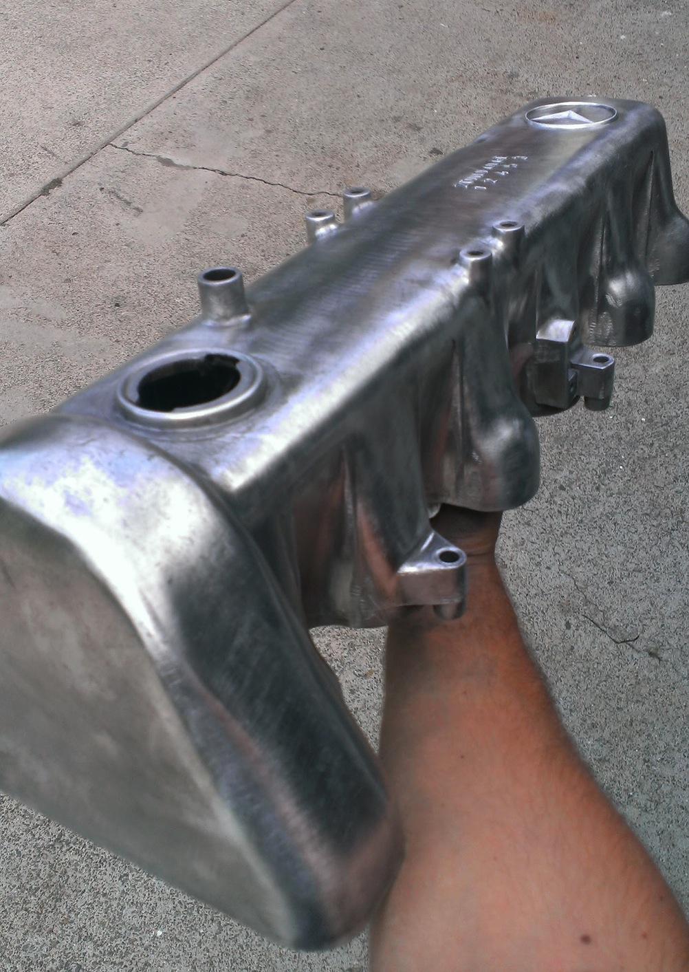

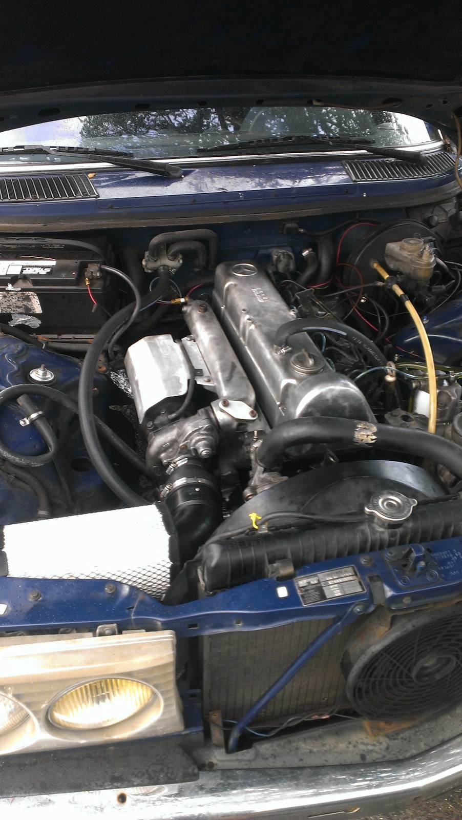

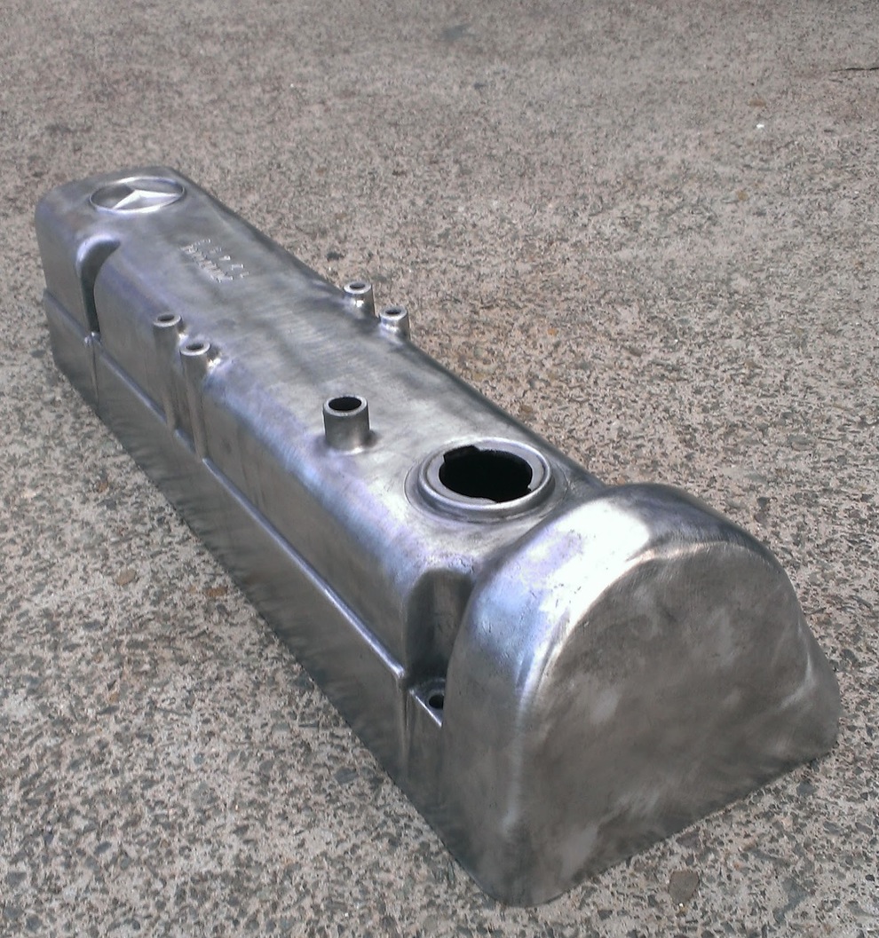

The first picture is when i just got it back to hawaii, the second is after buffing it taking off the old tint and some other things. I dont have any pictures of the interior, but it is clean, cloth interior, someone reupholstered it too
[Image: IMG_0769.jpg]
<a
[Image: IMAG0072.jpg]
[Image: IMG_0835.jpg]

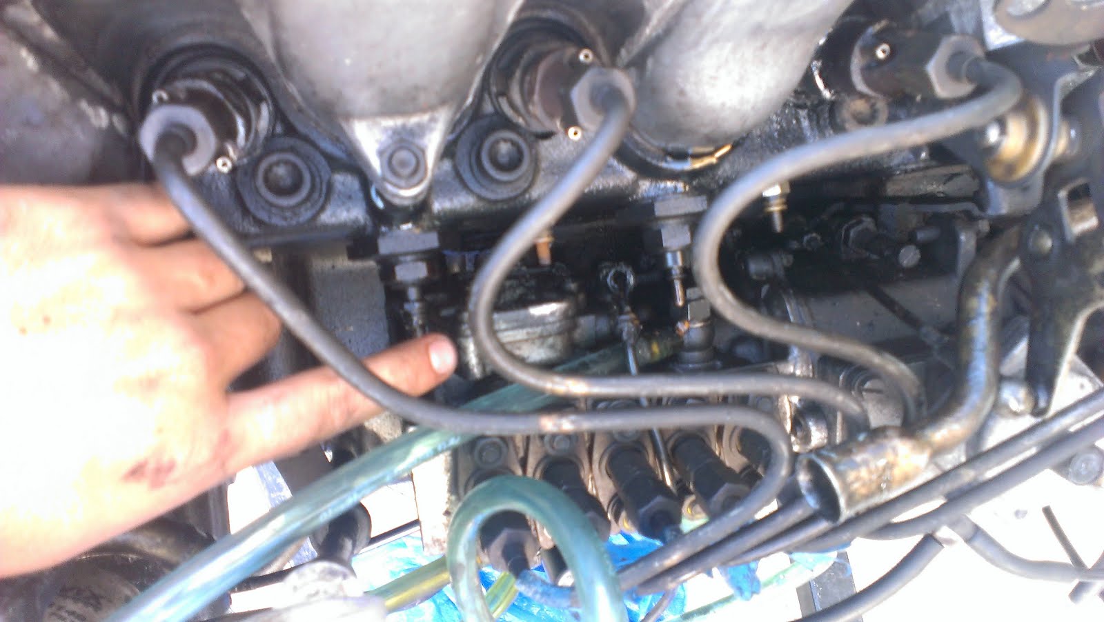

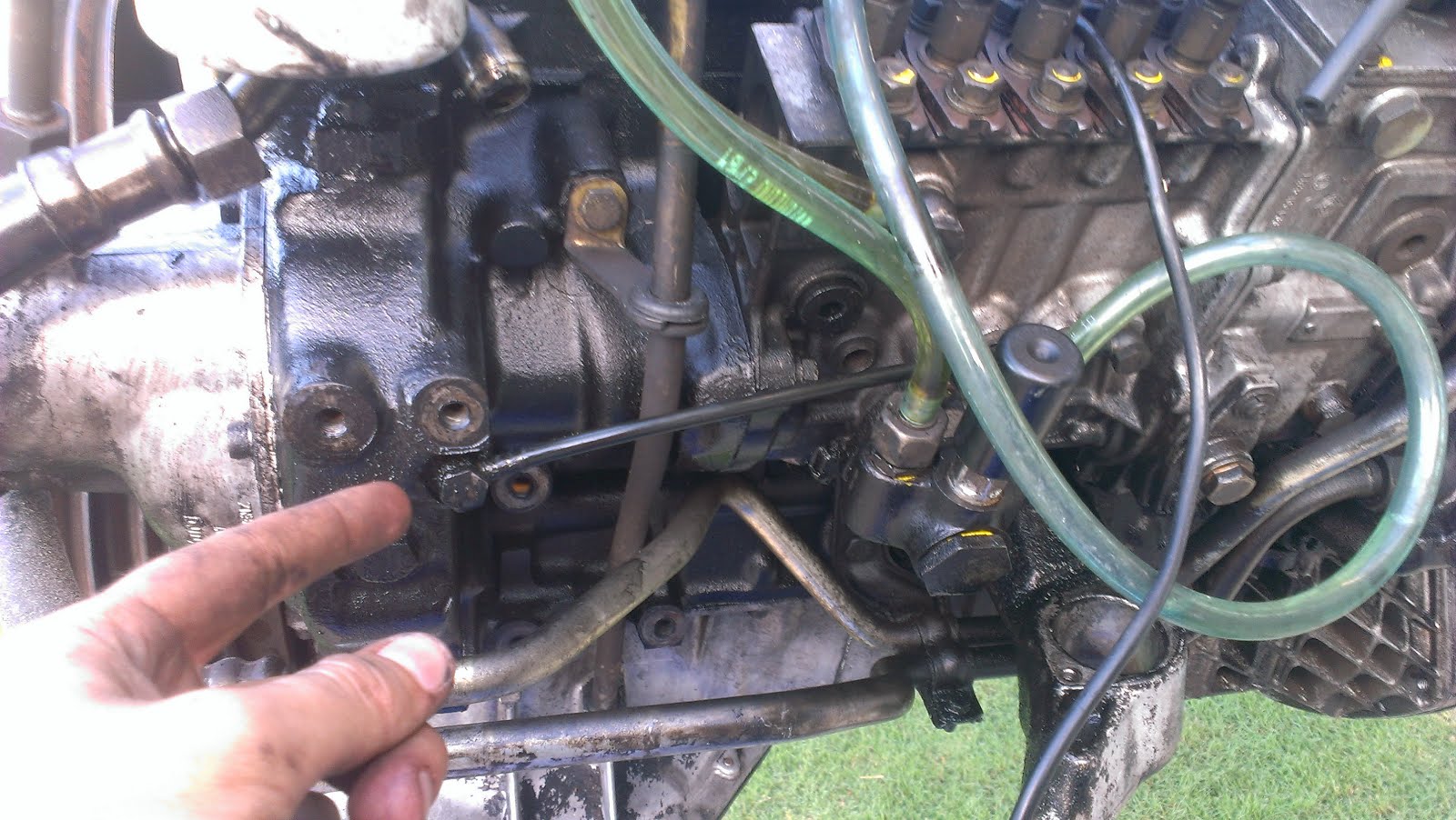

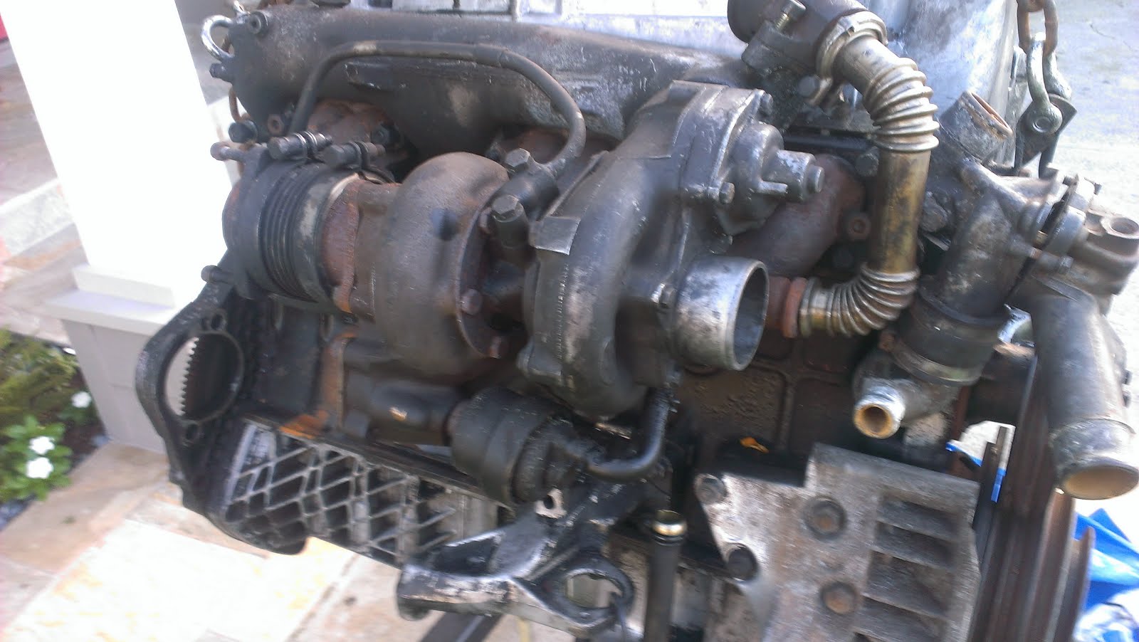

i finally got my project started, got an engine today.
life happens and money is tight so no super pump for me yet, just tuning exhaust injectors and so on.
heres the engine i think its off an 84 300d, the guy i got it from wasnt sure what year, but it has things on it ive never seen or noticed on other cars, like the extra port and block on the turbo inlet side.
and the box between the injection pump and the block.
and the vacuum hose (i think) going to the injection pump.
can i work around these things?
and the turbo looks like it might have eaten something during its life, some little nicks on the leading edges of the comp wheel. but there doesnt seem to be any play, should i run it hard as is? or jut buy a new turbo, or even bother to rebuild it, its almost cheaper to buy a hx35 or something?
larsalan
1,272
05-19-2013, 01:04 AM #13
That crazy block thing between the pump and block is some dumb emissions crap, does nothing.
That 'vacumm line' is an oil line for crankcase oil to the pump.
I would say a nicked up turbo impeller is not good. But you can run it depending on budget. Them things spin at like 100,000rpm so a little unbalanced does quite the harm.
If you're going for a powered up 617 a 'super pump' will free you of that shitty emissions thinger.
And a big turbo will be in order anyway so that'll take care or that too.
In the meantime you can make a block off plate and rtv it in place to block any egr. Exhaust gas re-circulation, that corrugated pipe from the exhaust mani to the intake mani can use a piece of 1/8in steel by the intake side.
Keep searching and reading here and you'll see all what can be done and what's feasible.

poleshady
GTA2056V
78
05-19-2013, 01:34 AM #14
So I can just plug off that box?
What is that extra block on the top of the turbo? Not the one that goes to the waste gate
I am planning in doing an egr delete also
I'll pressure was the engine tomorrow to get a better look at things

larsalan
1,272
05-19-2013, 08:22 AM #15
I that box just has a wire coming off of it if I recall. You can't really remove the box unless you had a plate to cover the void.
The box on the top of the turbo to the wategate sounds like the alda. You can surely read more on that part here and there. Mine is deleted.

05-20-2013, 10:34 AM #17
If that turbo's comp wheel is knicked, I'd throw it over the hill. (not literally, just sell it)
Get something like a he221, hx25, hx27, hx30, or even a BW s100 or s200. HX35 will be too big unless you get dieselmeken to make you a pump soon.
DieselBoy ran a hy35 on his and didn't seem to mind it too much even with a stock pump.
I am getting ready to put a hx30 on mine, if it works well i will let you know!

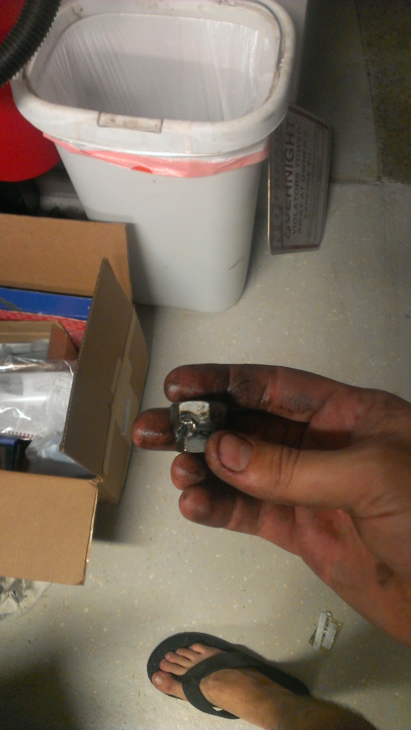

05-30-2013, 02:36 AM #24

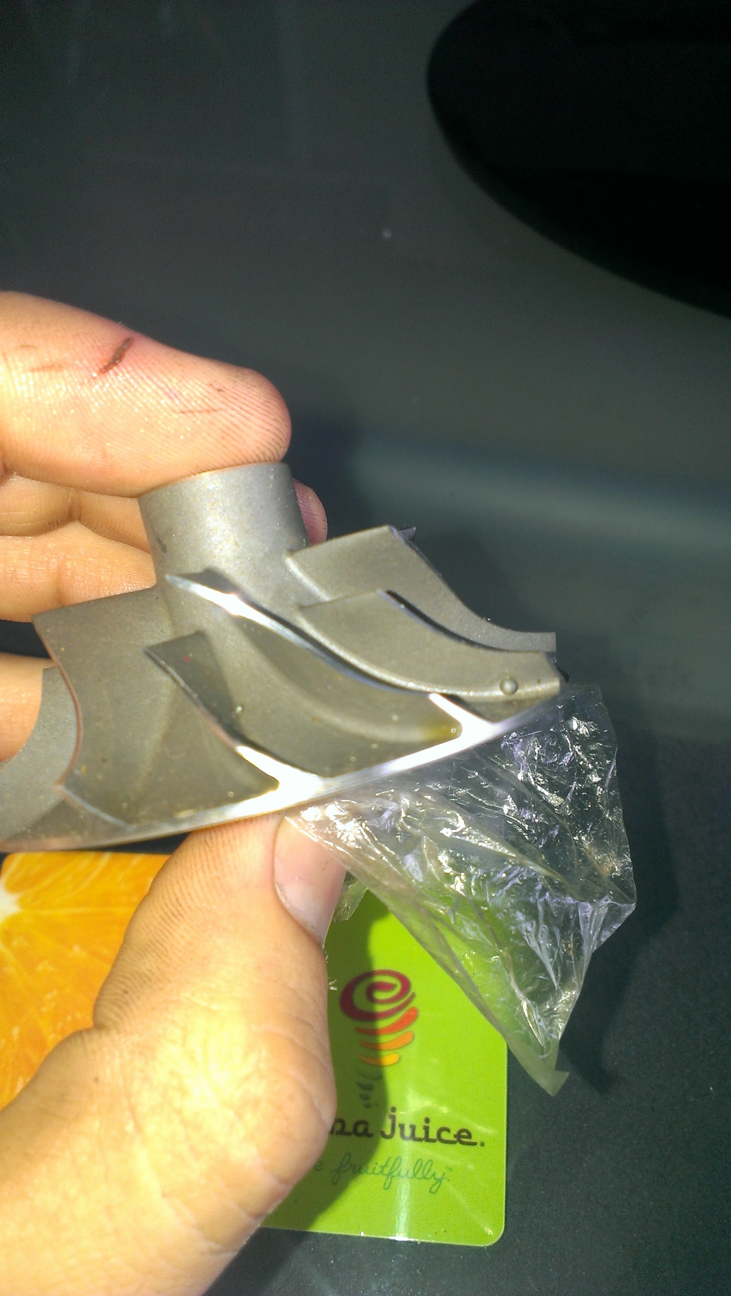

i finally got most of my parts in. bust some issues already.
got the replacement impeller from mercedes source. and it has a bunch of little balls on the blades.. it kinda resembles slag from welding, so they are sending me a new one.

05-31-2013, 05:29 AM #30
thanks, ill try find one locally, i doubt i will though
i replaced the nozzles today and pop tested them. but now none of the nozzles are centered in the injector housing. i dont know what the hell i did, i cant imagine that is how they are supposed to be. i didnt really pay attention to that before i took them apart

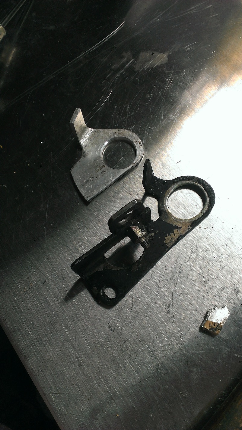

today i borrowed that little piece of metal that point to the degrees on the crank from a friends engine. and make a copy of it. looks ugly but should do the trick.
then i got bored and had some time on my hands and thought it would be a good idea to clean the valve cover one thing lead to another, sanding down to 600 grip was boring so i ended up brushing it witha brass wire wheel on a drill, it looks kinda cool.

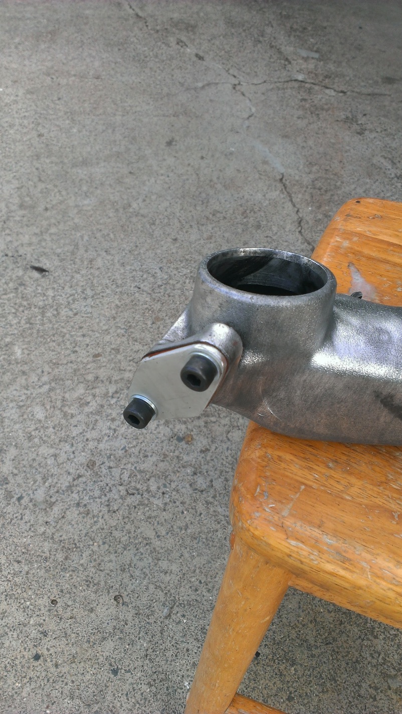

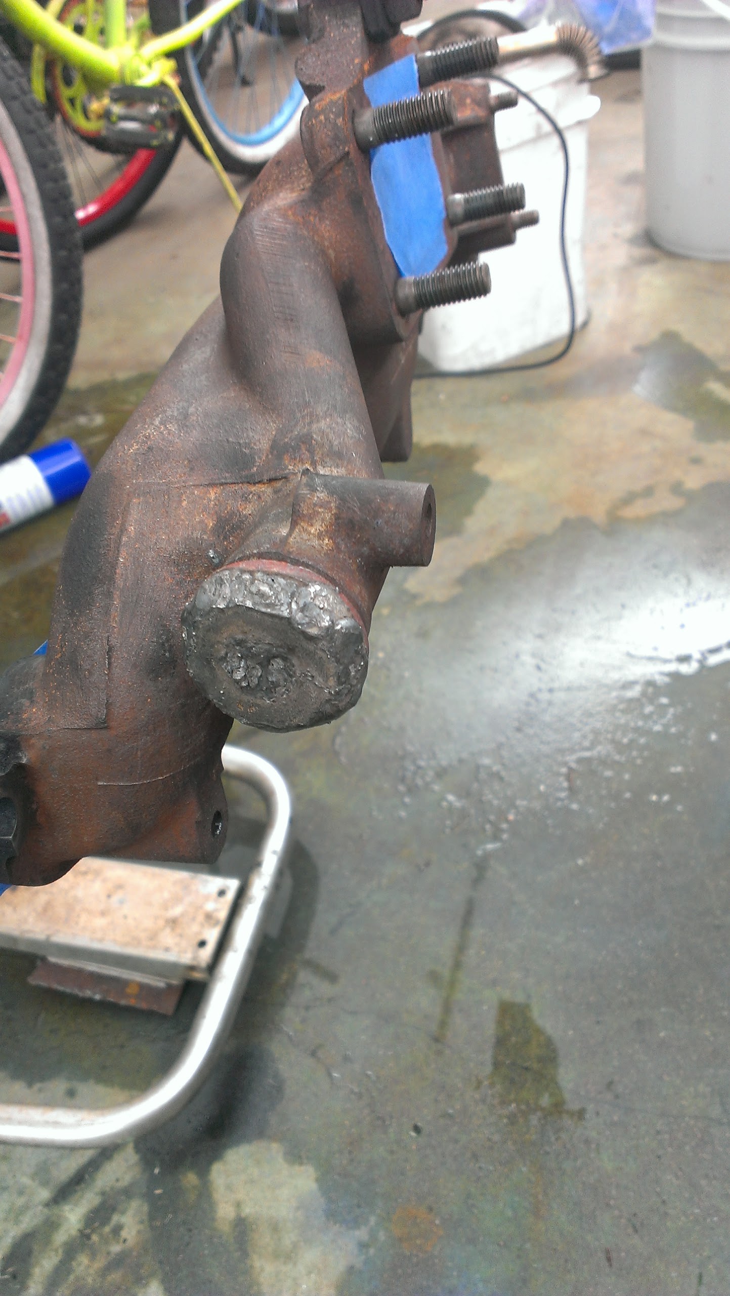

made an egr block off plate and welded the exhaust manifold closed with a couple thick washers.

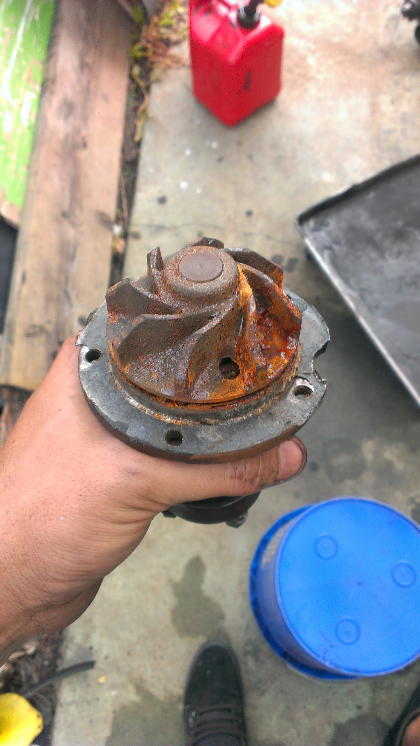

also i took off the water pump, it was kinda rusty, but its pretty hard to turn, it turns smooth but there is quite a bit of drag, i cant imagine its supposed to be like that.

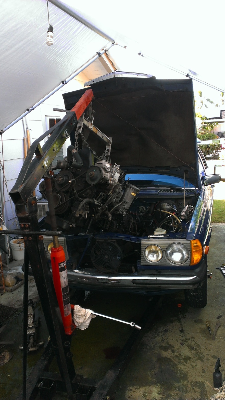

got the old engine out. need to figure out what to do about the fly wheel bolts and the pilot bearing, and get them match balanced.

07-15-2013, 04:34 AM #37

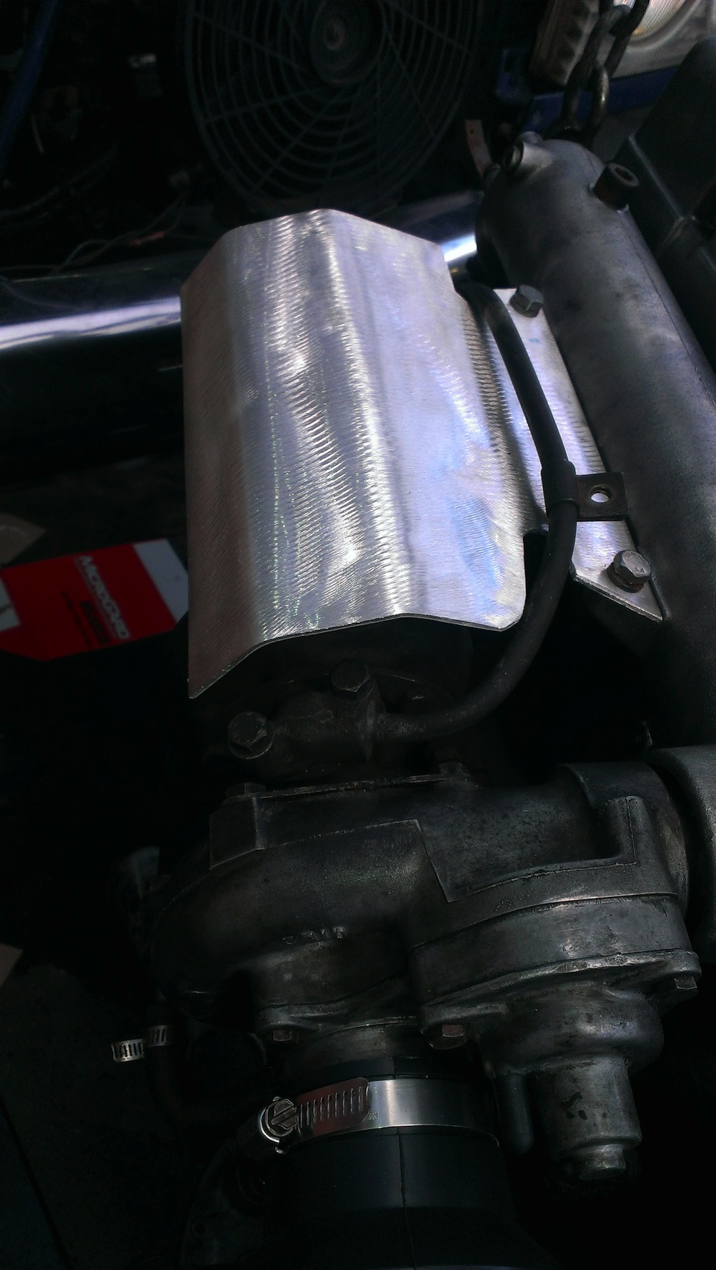

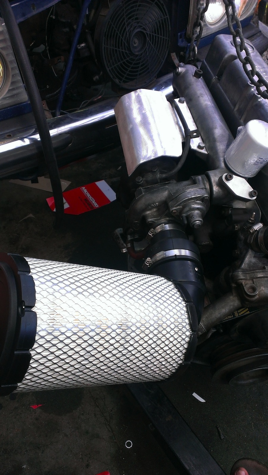

had some free time this weekend, waiting for the machine shop to match balance the fly wheel.
made a heat sheild for the turbo, and put together the 8038 air filter set up
poleshady
07-15-2013, 08:09 AM #38
Looking good!

got it started today and drove around a bit. I finally figured out that i had the cam off by 180 degrees, took a few days to figure it out but oh well.
Ran good, it was nice to hear the turbo whistling away, ill try to make an exhaust for it tomorrow before i ship it on tuesday.

08-29-2013, 12:34 AM #44
i almost undid this entire engine swap,
i pulled into costco to get stuff and noticed a trail of oil and a huge puddle under my car. the oil pressure line busted, and pissed oil everywhere. It was about a gallon low, so i filled it up drove, refilled, drove refilled etc till i got home.
I bought 3 gallons of oil at costco. I traced it back to where the stream started, it was about 30 seconds worth of driving. I got super lucky that I stopped when I did.
poleshady
