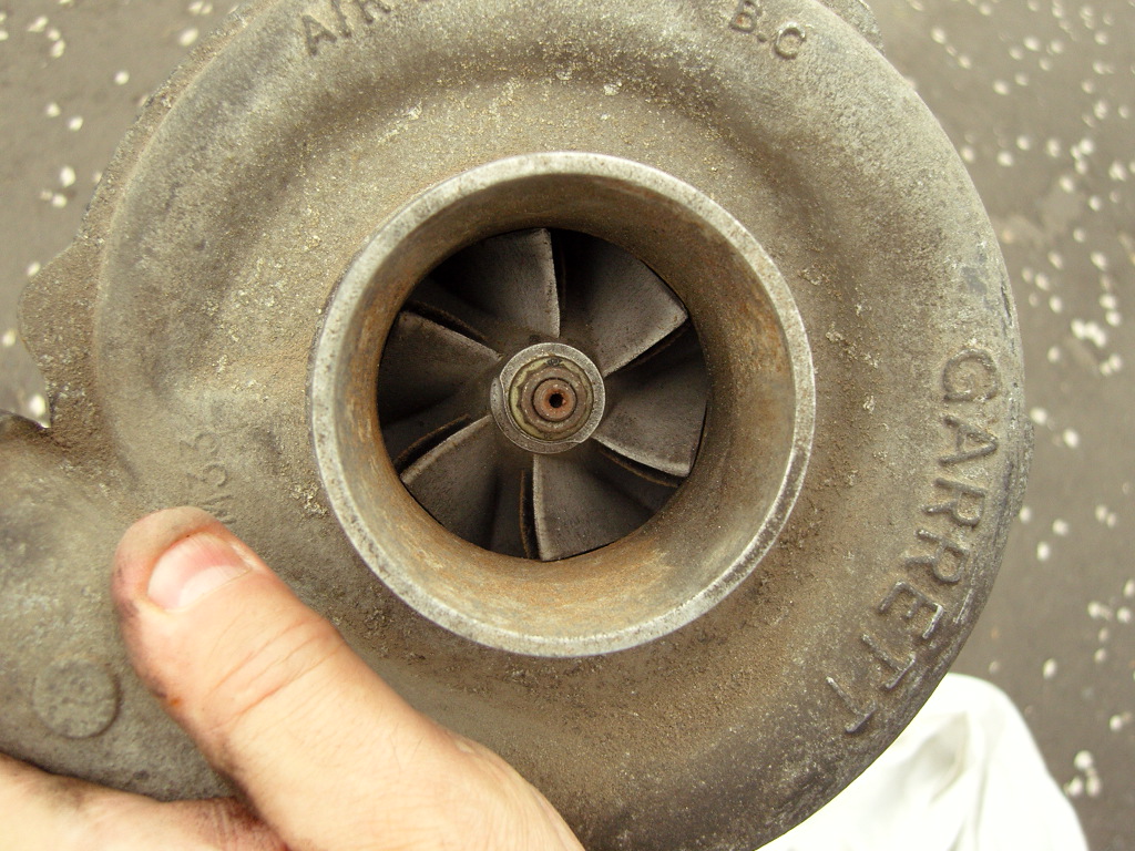

Thank you very much for the info and to the great people that have the patience to bare with me on this and all my questions Smile
The stock turbo is a no go then, better leave it alone...
Matanhead, you got 368 just with a bigger turbo, no remap, no bigger elements?
I might get a Scania Turbo, from a bus...
I think the writing on it were:
Garett 0.5 or Garett 5.
It had no wastegate.
The back wheel is big Tongue This should stop the back-pressure been a bugger Smile
Any imput on this Scania turbo, would that be OK for the 606 stock? Or do I still need the whole thingy, Re-map and bigger elements?
Dunno what to do about the wastegate tho, might put a dump valve on the AIT..
Again thank you all Smile
Olivier

(10-22-2012, 12:15 PM)Olivier Thank you very much for the info and to the great people that have the patience to bare with me on this and all my questions Smile
368 with stock elements could be possible but everything must be really well sized and injection time is way too long. Torque won't be too big either.

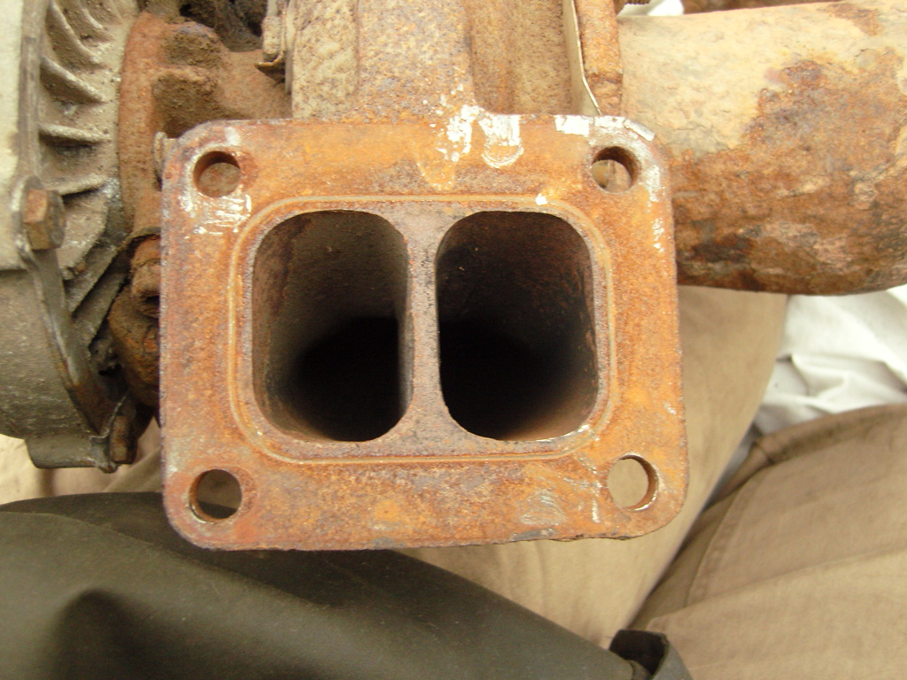

You may not need a wastegate with that turbo and stock elements Big Grin I think it will spool up slowly and it can't make too much pressure.
But anyway you have to make/buy new exhaust manifold for that turbo so you can put an external wastegate to it. Make good tube manifold where all the pipes are same lenght.
After driving for a while with that setup you may want to buy bigger elements and re-map your car for better performance.

(10-22-2012, 01:58 PM)Siekkinen 368 with stock elements could be possible but everything must be really well sized and injection time is way too long. Torque won't be too big either.
Is the 368 the Garett turbo?
I have advanced the timing injection already, would that help/ not?
(10-22-2012, 01:58 PM)Siekkinen You may not need a wastegate with that turbo and stock elements Big Grin I think it will spool up slowly and it can't make too much pressure.
Oh dear, you mean not enough boost Tongue Big Grin Sad
What can I do... I cannot win on a wee budget Sad
(10-22-2012, 01:58 PM)Siekkinen But anyway you have to make/buy new exhaust manifold for that turbo so you can put an external wastegate to it. Make good tube manifold where all the pipes are same lenght.
Dunno how I'll do that? Huh
(10-22-2012, 01:58 PM)Siekkinen After driving for a while with that setup you may want to buy bigger elements and re-map your car for better performance.
You mean after driving the slug... Blush
What is wrong with this Turbo? To big and it need a lot of fuel to spool?
Would an Xh35 os the T4/T4 be alot better?
Cheers Smile

10-22-2012, 03:12 PM #22
-No, I ment horsepower Big Grin injection timing won't help cause when you increase a fuel amount, injection goes longer and longer. Bigger elements injects same amount faster and burning will be better.
- With big turbine housing, big turbine wheel and too small elements you can't make much boost. On the other hand you don't need so much boost to burn all the fuel that those elements inject.
- Then you should buy one. I think that someone there makes those but in Finland is one good shop that makes them. http://www.kkdmotorsport.com/kauppa.php?k=1270679050 there. "Mersu" means mercedes Big Grin
-When you tune up your car, anything isn't enough Big Grin
Cheers Smile
- Hx35 would be lot faster to spool up. It's a good choise for anything between 250-400 bhp.

KKDmotorsports manifolds are really beautiful and high quality. That's the reason for high price.
Those cheap stainless manifolds won't last long. Maybe year or half and it cracks. But it's cheap though Big Grin and may last for a while if you are lucky. If they don't make manifold for 606 you can't even try your luck Big Grin
Of course you can give a chance for that turbo and try it. It could work fine but won't spool up fast. What do you mean by "faster as smaller"? I haven't spoken english whole of my life so I can't understand some things Big Grin

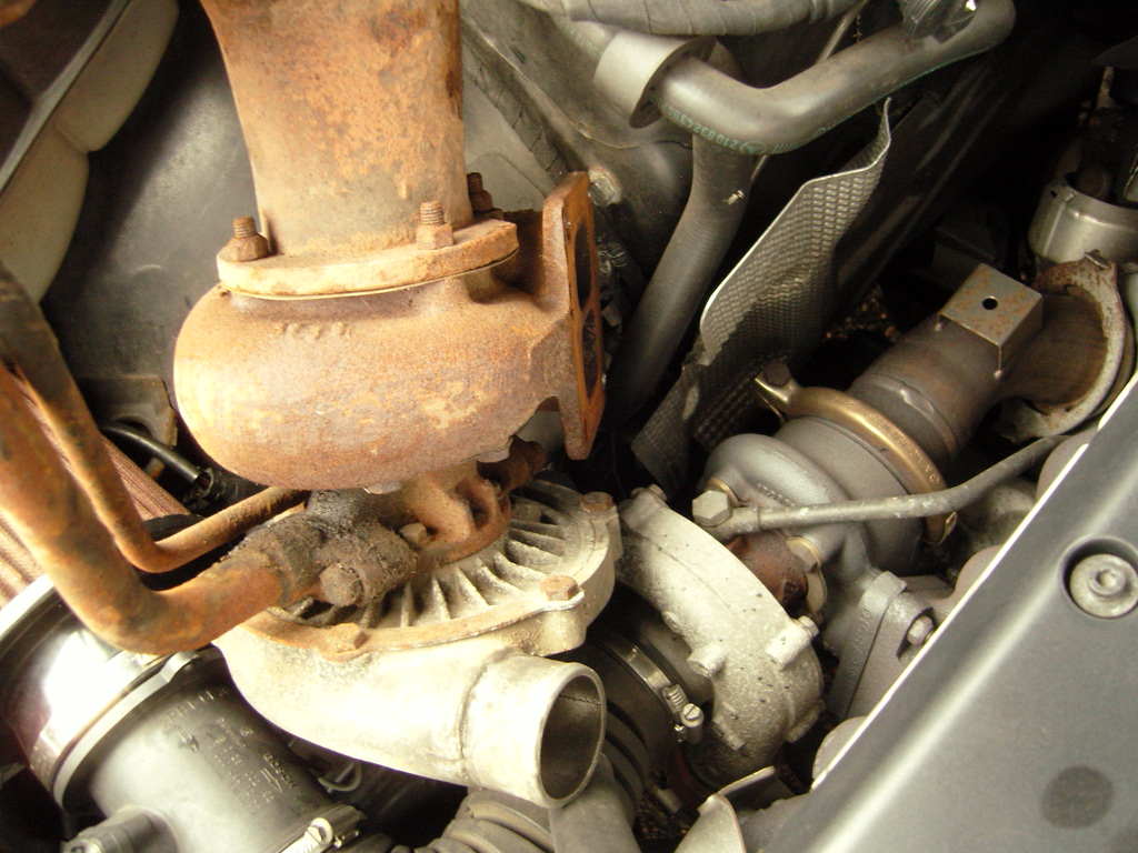

This is it, the turbine housing on the exhaust side was looking huge... EEK! Oh dear Smile
To be continued Tongue

    Hi Guys, is that any good? Got it today, the Scania Turbo Tongue
Its Big Big Grin
Cannot see what it is tho, its a Garrett but no idea what model?
Cheers Smile

Got the turbo type Tongue
its a Garrett TO4E06 for Scania
http://www.turbomaster.info/eng/search.p...referencia
From a 9 liters engine Big Grin
Oh dear... Tongue

(10-30-2012, 08:05 AM)Olivier Got the turbo type Tongue
Oh dear... Tongue
Olivier--
Think of it this way. That 9L Scania motor prob tops out at say, 3K revs and runs that turbo correctly
Your 606 is only 3 litres--But can turn at say, 6K, the turbo will 'see' the same sorta range of gas-flows--Ok a bit lower but you get the idea....
Its maybe a bit big and almost definitely the wrong 'trim' for what you want, will be very laggy but probably work with the right elements and manifolds...
HX35 be a much better choice, a 'Superturbo equivalent' from KKD trimmed up for the 606 would be the best choice...
HX40 prob be a bit big for everyday use, then again they are used....
