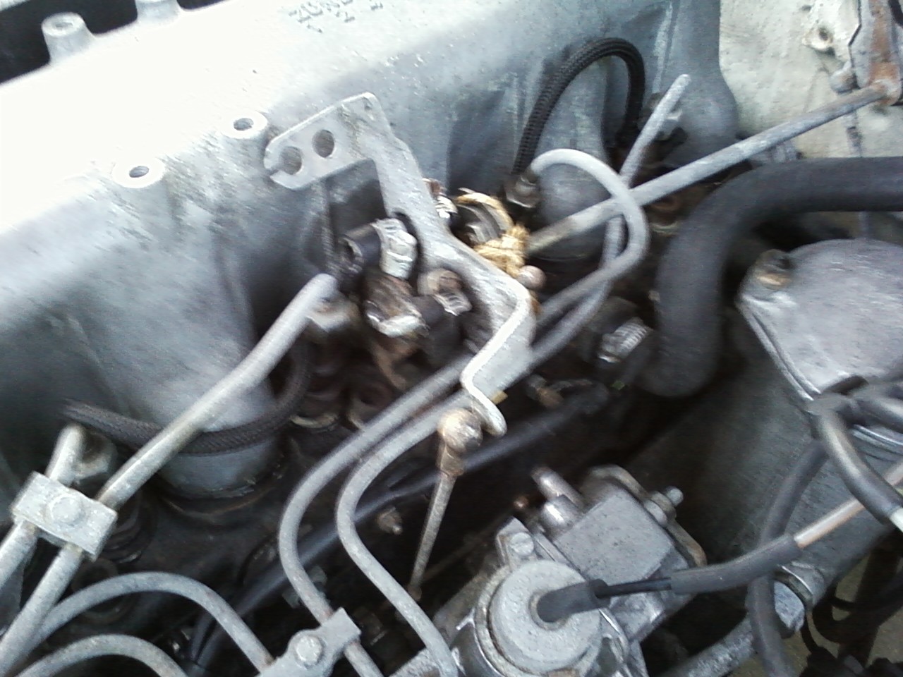

10-28-2012, 08:08 PM #4
Here's my current throttle linkage. I have a WTB out there for a 300D NA throttle linkage for M Pump set up out there. Any one ?

10-28-2012, 09:32 PM #5
(10-28-2012, 08:08 PM)Greazzer Here's my current throttle linkage. I have a WTB out there for a 300D NA throttle linkage for M Pump set up out there. Any one ?
that looks pretty beat up. Do you have a welder? maybe you should consider making one. Might be worth the hassle

10-28-2012, 10:10 PM #6
I have some of that stuff but not all of it. One time a while back I send some of the ball/cup ends to someone in FL. I could send the parts I have to you if you want. See if you can rig it up
and it's from a turbo 300d. Dunno what parts are different from a NA

10-29-2012, 08:50 AM #7
Hey guys,
Larsalan -- I passed your exit ! Bloomfield, IND while driving back home. I thought of you while my front end shook like a whirly bird over 60 mph ! LOL.
Yes, it is rough and not just that. Overall my fault for not asking a bunch of questions and asking for some decent photos. I was too hyped up over the five speed Getrag 717.400 plus after seeing an incredibly long write up of all the work done to the old girl, I thought the work was actually done. Even the "Rebuilt Engine" may not be all that rebuilt. Blasted thru 3 quarts of oil in 500+ miles and the great cooling system is not so great as it overeheats, and the list goes on and on.
I found the throttle bushing. The ball and cap thing. BRAND NEW or just about that.
I really need a picture of what the throttle accerator set up is supposed to look like on the 300D NA. I found in my garage in a big box of junk a spare, but I dont think the M pump and MW pump setups are the same. I have the turbo set up. Thanks anyway. This is the BEST forum out there. Period.
ANY Pictures PLEASE !!!!!!

10-29-2012, 11:17 AM #8
(10-29-2012, 08:50 AM)Greazzer .......
Thanks again,
Here is a later setup with EGR controls I posted a while back. Just overlook the EGR control.
[Image: attachment.php?aid=1952]
[Image: attachment.php?aid=1950]
[Image: attachment.php?aid=1951]
Without the EGR controls
[Image: attachment.php?aid=1942]
[Image: attachment.php?aid=1941]
[Image: attachment.php?aid=1943]

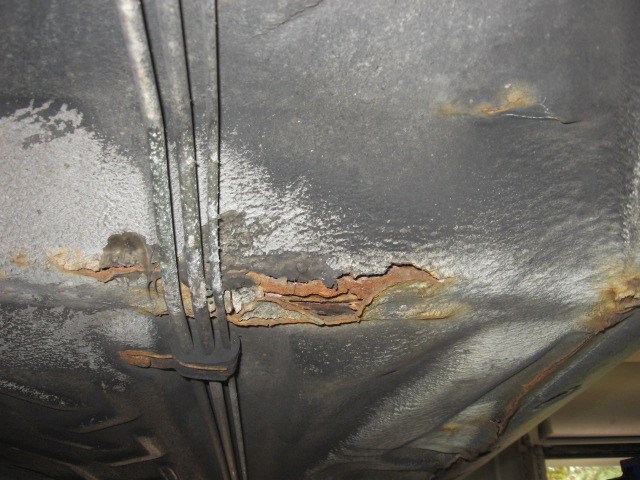

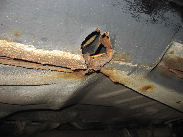

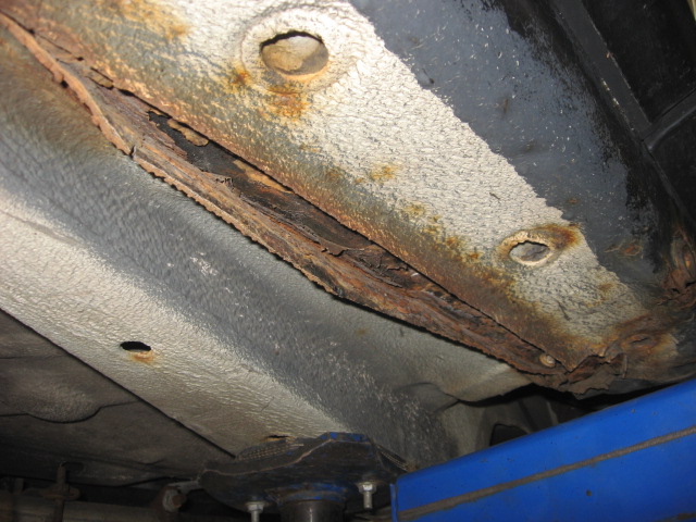

10-29-2012, 08:46 PM #10
I think I have captured the rust bucket of the year award. Although I got the Getrag 717.400 five speed, look at the disaster I bougt. This will teach everyone out there to not buy a car unseen with one's own eyes, to rely on a few photos which on reflection really showed almost nothing, and not to rely on a long narrative of all the work that was done over the past 6-7 years. This might end up as soup cans real soon. Sooooooooo, any one interested in buying a fully functional Getrag 717.400 Five Speed Transmission ?

10-29-2012, 09:30 PM #12
IF, and IF the engine is not screwed up, then I am sort of OK with the transaction. Problem is that the assurances of a really sound mechanical car are not panning out right now.
The 5 speed. Jury is still out for the car right now.

10-30-2012, 07:36 AM #14
I had one that rusty. You could see the road going by from inside the cab and you needed to be extremely careful with your pocket change Wink

10-30-2012, 08:32 AM #15
Yes you can see the road as you drive ... LOL. I wished the PO pointed this extra feature out ! LOL

10-30-2012, 09:30 AM #16
My DD had rust worse than that and I towed 3klb loads to/from rochester a couple times (200 miles one way)
I'd use it as a test platform until the Phoenix Project is done, then scrap it. Shoot some primer on the rust, and rivet some scrap metal over the big holes.

10-30-2012, 09:44 AM #17
I've replaced a rocker panel and floorboard before in a W123. Not fun. The rest of the car would have to be pretty exceptional to justify doing a job like that.

10-30-2012, 09:48 AM #18
The rest of the car is not exceptional. Rust all over.
I got a truly rust free floor from my skeleton of a part's car. As for the pans, I was thinking of just glueing them in with "Fusion" product. All the tests so far indicate stronger than welding.

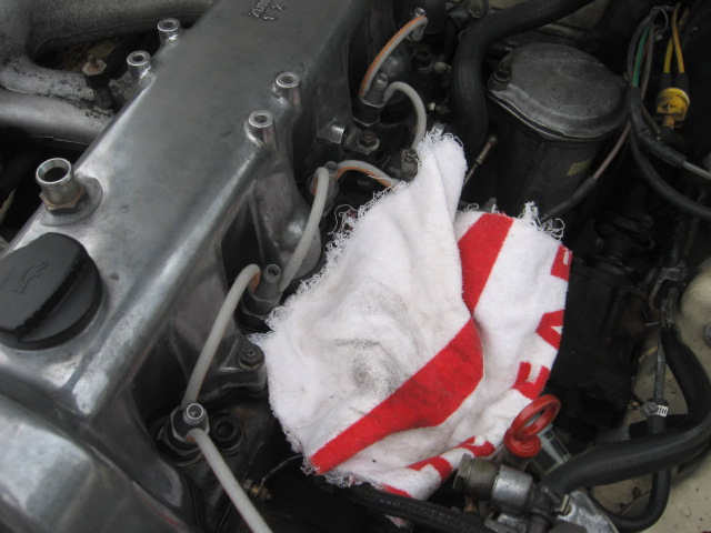

I did some much needed maintenance after work. A long 2 hours.
I drained the trans, added Dexron, drove it about 1-2 miles, drained it again and added the good stuff. The stuff that came out the first time was black like used motor oil from an engine. The flush came out not perfectly pink, but pretty close. SUPER improvement over before. I still got a grind from shift from 3rd to 2nd, but I can go a few more miles per hour before the grind. However, the trans overall is SUPER right now. VERY pleased. The PO did just disclose today that he shaved too much off the FW so now I got to worry about that. Plus, I had to swap him a GREAT FW. So, I gave up a great FW in return for a not so hot FW plus money. Whatever.
I drained the rear differential. That crap came out like water. Not real happy with that.
I distintly recall the PO claiming that the car might have a few cosmetic issues but it was mechanically sound. I think our views differ ... LOL.
Right now, I need to track down why I do not have any rear back up lights. Also, I need to figure out how to adjust my rear brakes -- emergency brakes. I have taken 2 cracks at it and failed.
This weekend I am doing some STD mods --
Elsbett Injectors and my mechanical steering box and getting rid of the PS set up. The power steering box and the entire set up is for sale. The box steers nice and does not leack. Same with pump and hoses. Adjusting the valves and valve cover gasket too. I think I am about halfway done the maintenance I plan on doing. Next is exhaust and brakes. The header pipe partial broke off . Totally rotten and the front rotors have to be warped.

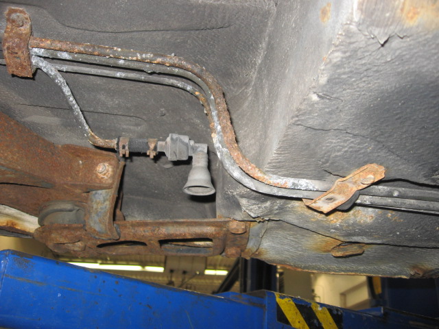

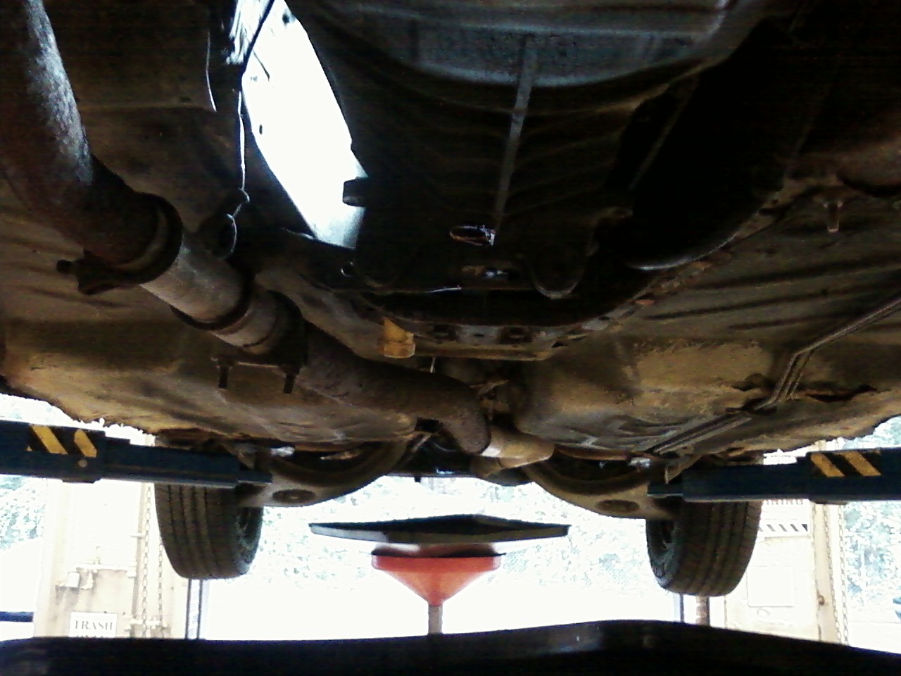

11-02-2012, 08:59 AM #28
(10-29-2012, 08:46 PM)Greazzer I think I have captured the rust bucket of the year award. Although I got the Getrag 717.400 five speed, look at the disaster I bougt. This will teach everyone out there to not buy a car unseen with one's own eyes, to rely on a few photos which on reflection really showed almost nothing, and not to rely on a long narrative of all the work that was done over the past 6-7 years. This might end up as soup cans real soon. Sooooooooo, any one interested in buying a fully functional Getrag 717.400 Five Speed Transmission ?
aint so bad. here, this will make you feel better-
[Image: 014.jpg]
[Image: 0032.jpg]

It has the 38 pounder, but thanks anyway. I'm just a little pissy right now since the PO really did not disclose all the issues and I kick myself in the butt for not asking questions. Actually, when you read his add and compare it against what I got, they really don't add up.
I agree about the grinding maybe being associated with the bushings and they do need to be replaced. I got a lot of slop in the shifter right now, but the trans is 100% better with the fluid flush and then refill with the good stuff. I can tell that the PO squirted some oil up on one of the shift arms from underneath. For a guy with a zillion posts on a different forum, and telling me the car was mechanically sound, I just have to wonder what makes folks tick. But, as I said, if you get lemons, make lemonaid.
Yes -- your rust beats my rust.

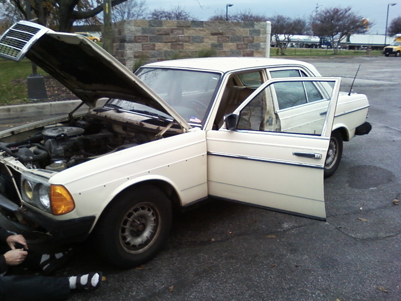

No .. the key is not busted. I was driving to work. What is funny is that fact that after I posted SOME of the problems I found out about ... I got a PM from the PO telling me he legally did his duties and started talking legal mumbo jumbo and that his add was just fine. LOL. And, he offered me $150.00. What is funny is that when I went to put the spare tire in the trunk before driving off in Indy, he told me ... "Oh, I forgot to tell you, you cannot open the trunk." .... After driving about 80+ miles, the fuel gauge did not budge. I called the PO and asked him if the gauge was OK ... guess the response ..."Oh, I forgot to mention that ..." I could write an incredibly long list of "I forgot to tell you ..." Even the battery was junk. I drove it 13 hours and it would not hold a charge which made the drive a challange and the so called great radiator and cooling system overheated before I hit Lexington, KY.
The car just has rust and rot everywhere and every single mechancial system is screwed up except the power steering system which I am deleting anyway and the front passenger regulator which I am selling. The car has 3 out of 4 manual regualtors, but 2 of the manual regulators are broken and both front interior door handles are broken so right now I cannot lock the car doors or the trunk. What is ultimately funny is that he called the car "his gem" and actually had it listed for $4K+ a few years ago, and now at $3,500 or BO. I wasted $2,000 and a Flywheel plus my free airfare voucher on $250 scrap and a five speed trans. Even the so call rebuilt engine has low compressoin.... BUT, I will get the old girl up and running in STD tradition !!!!!!!!!!

11-02-2012, 06:37 PM #35
You forgot the $450.00 imputed value for the FW I swapped which was hand delivered. Perfectly machined and balanced. So far, I dropped the equivelant of $3,375 on the car. That includes my airfare, which was free, a day of vacation, et cet. Not to whine, but I just wish I knew the real deal since I would have probably never bought the car in the first place. I guess that is the real issue at hand. I really didnt want another super project. But I certianly got one.
I will be posting some real juicy pictures of the rust and rot. Its nasty underneath the old girl. I saved the best for last ! HA HA

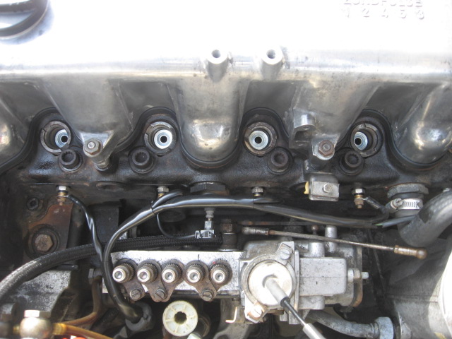

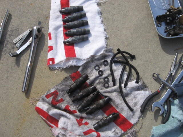

11-04-2012, 06:28 PM #36

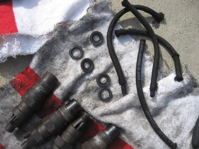

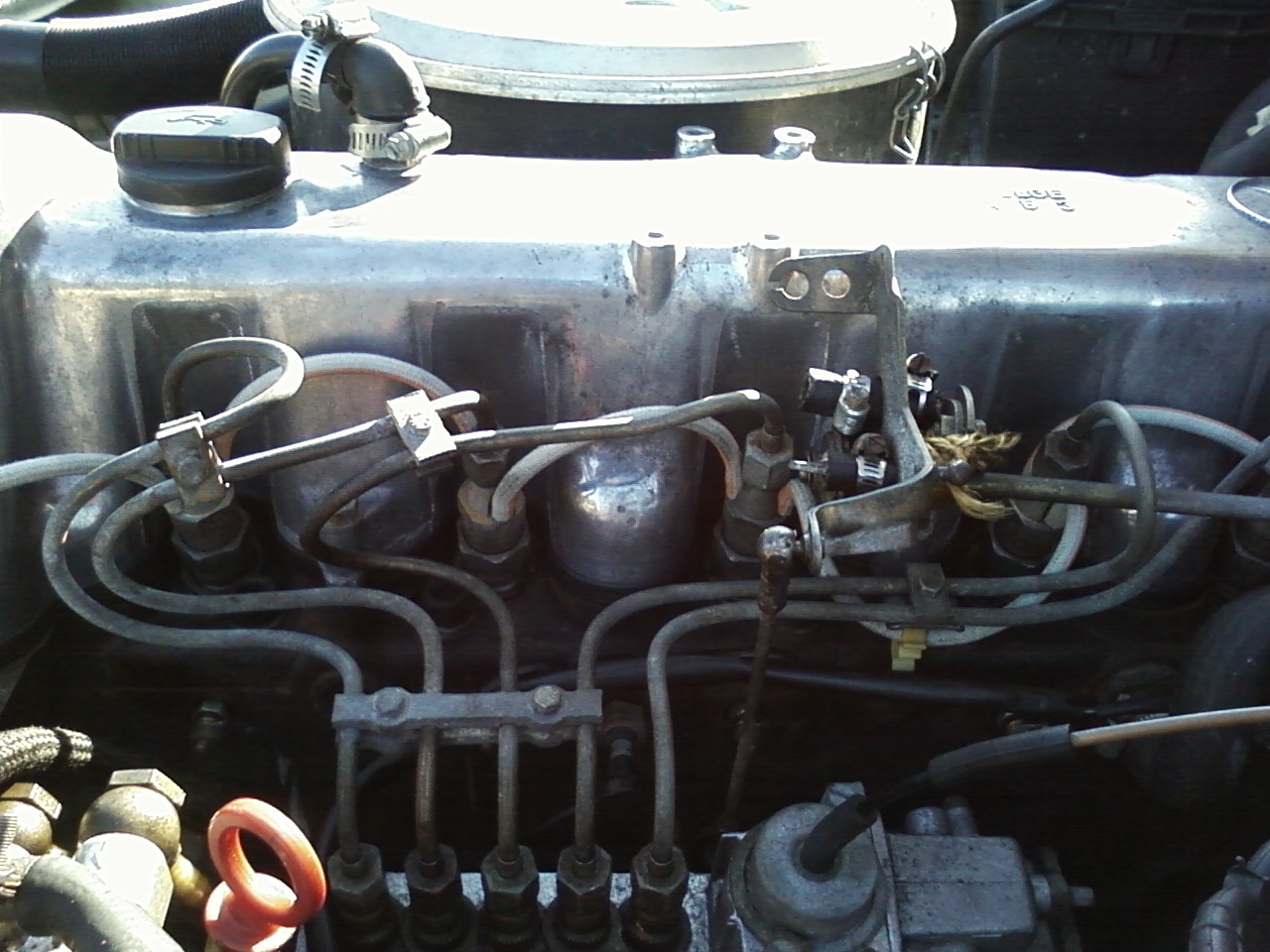

Spent about 5 hours this weekend to do some really long over due maintenace. She's really peppy right now.
So, realizing that I had about 2 good hours to work on the old girl on Sunday, I made the most of it. I determined that no way is the belt "slipping" so I found one of my stashed thermostats. A Behr 80C -- a nice little gem. I tried removing the old one but snapped 2 bolts. They were frozen in there good. I then realized that the gasket fossilized, so who knows how old that deal is. BUT, I got the snapped bolts out and installed the new thermostat. GUESS WHAT -- No more overheating ... at least yet. The lower radiator hose is about ready to go. Rotten at the bottom, but I am OK with that until it explodes since I do not want to invest any money on the cooling system now when I am working on converting to EWP. However, she really does drive nice now.
So, just celebrated my first week with "The Sleeper" and
1. I drained, flushed, and refilled the tranny
2. drained and refilled differential.
3. Oil and oil filter change
4. Adjust edthe Valves and VC Gasket and buffed the VC for a little over an hour on Saturday. Pretty shinny.
5. New Injectors with Heat Shields.
6. New Thermostat and gasket with new bolts
7. Adjusted rear parking brakes although they are basically shot
As for things fixed, here's a partial list
1. Fuel Sending Unit
2. Washer Fluid Resevoir and pump
3. Trunk opened but no new lock yet
4. New Wiper Blades
Things that must get done this week:
1. New Oil Pan and Gasket. Need to figure out how to save or capture my new oil since that costs more than a new oil pan and gasket. That is sad ...
2. Exhaust. Header pipe is half way busted right now. I got a new header pipe and new manifold gasket. I got some serious manifold leaks also.
3. Tracking down any more leaks since I am finding them here and there.
4. Finding my key to the trunk lock and fixing the front door locks so I can lock the doors.
MODS which I missed out this weekend because of the extra work involved in Maintenance
1. Getting rid of the Power Steering and putting in the mechanical box
2. Getting rid of the non functioning A/C system. I won't need it until March so I got time to rebuild it correctly.
3. Installing my 150 AMP Altenator
4. Relocating my new battery to the trunk
5. Installing my WVO system -- way over engineered but I like it.
I NEED To SOURCE a NON-EGR Exhaust Manifold and a throttle linkage. Any one out there ????????????????

11-05-2012, 12:45 PM #40
A little better snappy of the rebuilt injectors and new return lines and my semi-polished valve cover. At least the injectors look new ... LOL

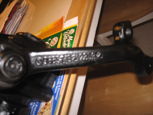

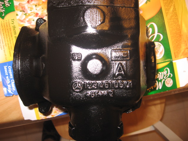

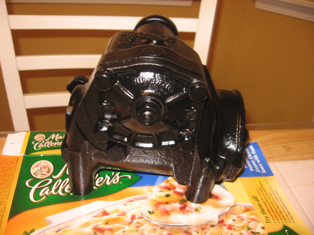

11-07-2012, 08:36 PM #44
Finally !
Here is my first mod to the Sleeper ! It is going on tomorrow evening.
I am getting rid of the parasitic power robbing Power Steering System altogether and installing my mechanical steering box. Here are a few pictures. Although I do not know how much HP I will be gaining and how much MPG I will be picking up, I do know that the various sources claim between 5-10 HP and somewhere around 2-5 MPG. We will see.
AND -- this is the ONLY system on the Sleeper that is actually in decent mechanical condition. So, if anyone wants to buy a Steering Box that does not leak and not a lot of play, a nice pump, pulley set up, and hoses, check out my FS listing for this. My price is negotiable since I want to get rid of as much clutter in my garage to generate $$$ for very serious maintenance, e.g., brakes & exhaust right now.
Finally !

11-07-2012, 09:16 PM #45
I like that. Are those easy to come by? Like what model/year car can they be found?
pn # 1234610601 right?
larsalan
11-08-2012, 07:01 AM #46
Yes, that is the Part #
Nope -- very rare, which is odd since who wanted non-power steering ? LOL. Just as rare as the five speed Getrag 717.400.
They are for sale in Germany for a ridiculous price of around $600 USD and the shipping will be around $150, taxes, et cet. So, it's very pricey unless you can find one. I would never pay $750.00 for it. Excluding my current 5 speed in the Sleeper, the WHOLE Car is not worth $750.00. LOL
