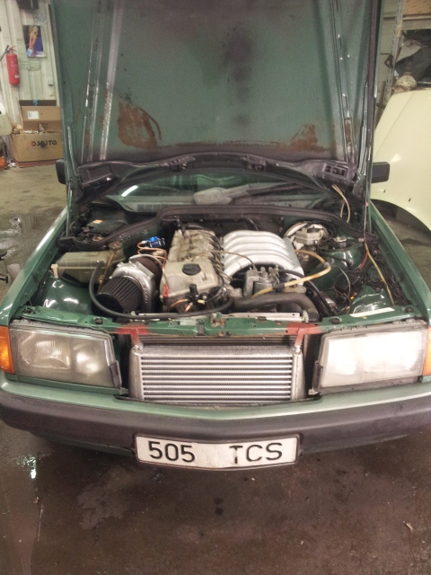

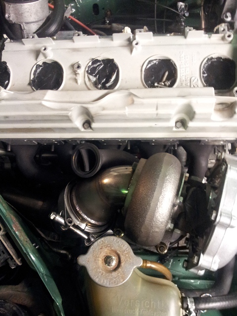

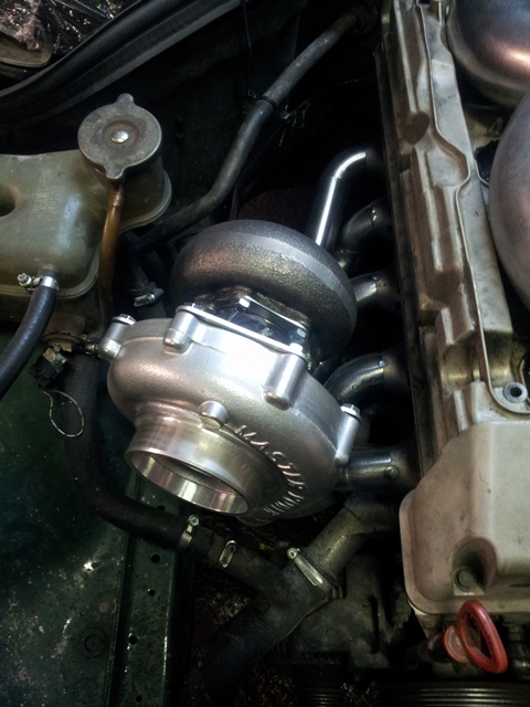

Hei
Here are some pictures of my w201 om 605 build.
Pump is going do be 7,5 mm 180cc dieselmeken,i hope do get it back this week Smile
turbo: master power mpr 545 #14 housing.
wastgate : turbosmart
Itercooler will be custom made, exhaust mainfold custom made.
cant ad pictures.

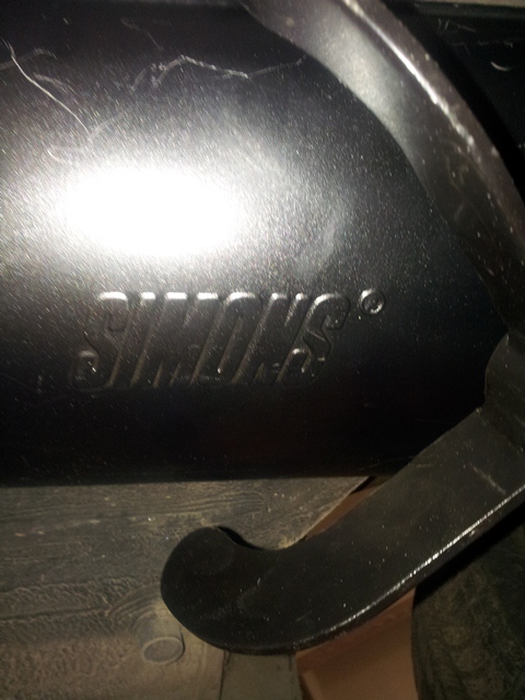

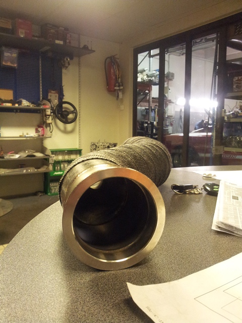

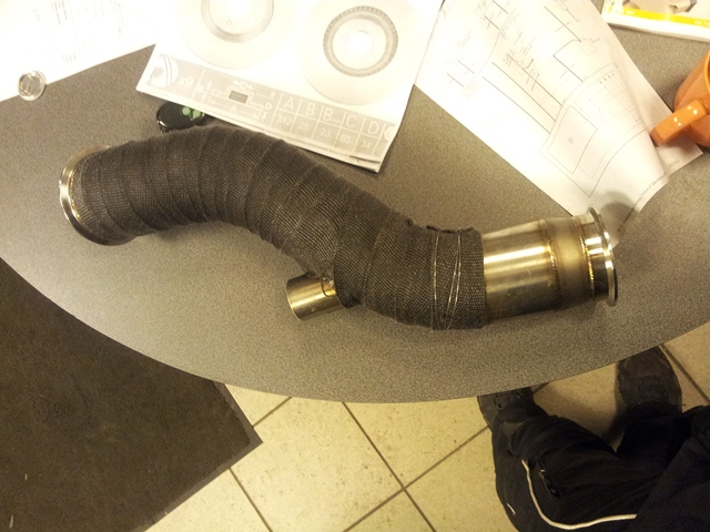

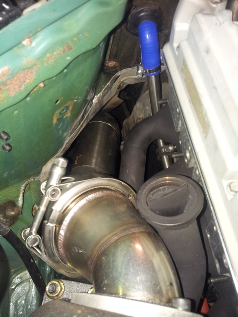

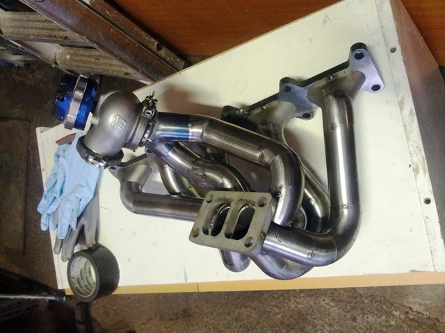

some new pictures and progress
Downpipe 3,5 inches
other pipes 3 inches
new seats Cool
Here is ready exhaust mainfold
https://www.facebook.com/photo.php?fbid=...=3&theater

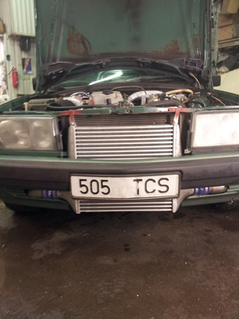

Company how will makse the parts is https://www.facebook.com/JouJaam
There you can see allmost ready intercooler allsoo.

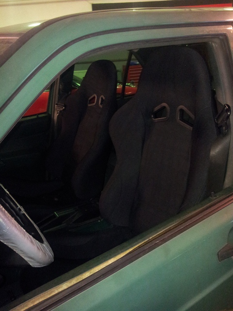

artuur
12-05-2012, 03:08 PM #4
Downpipe 3,5 inches
new seats Cool

12-06-2012, 01:19 AM #5
I like the look of the seats!

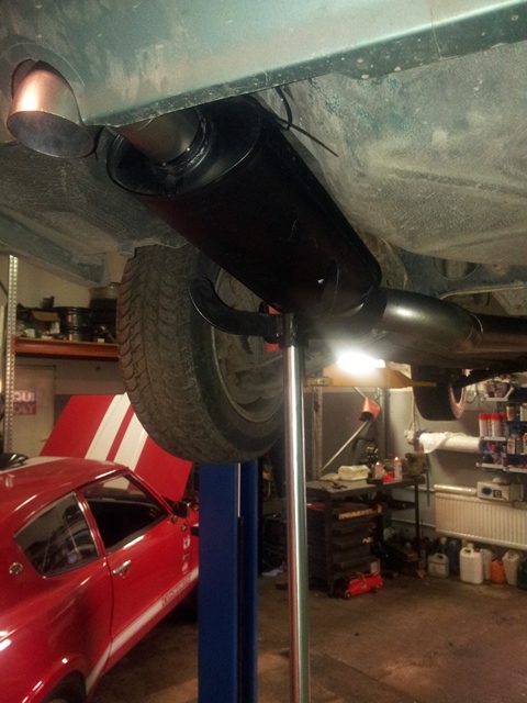

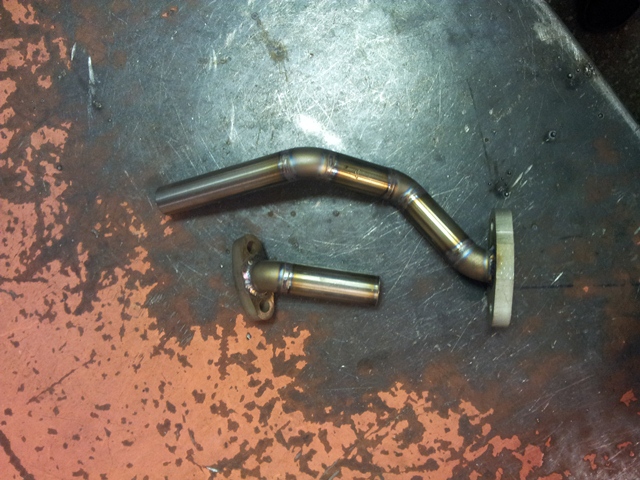

12-10-2012, 03:55 PM #8

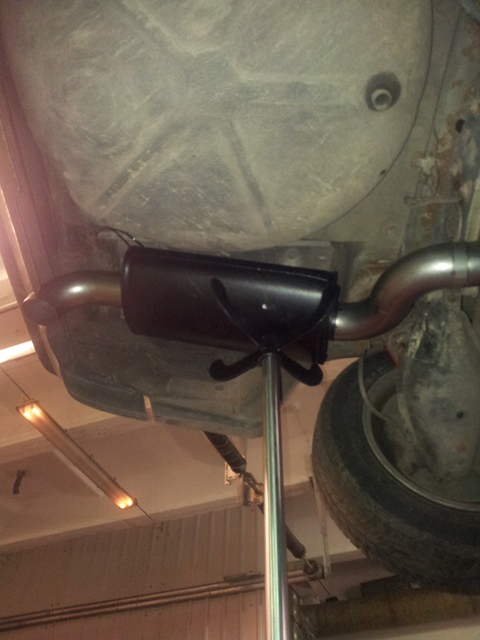

Hei guys.
new pics from exhaust system and oil return pipes.
Probably will see the intercooler progress this week.
This post was last modified: 12-10-2012, 04:04 PM by artuur.

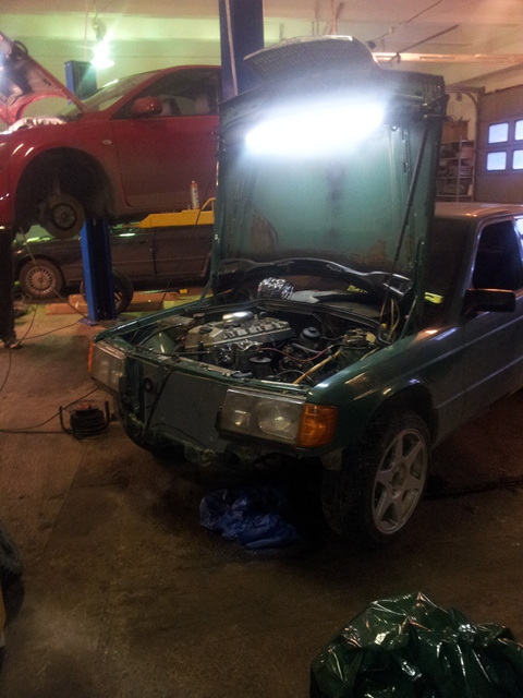

12-28-2012, 05:10 PM #9

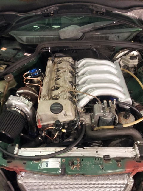

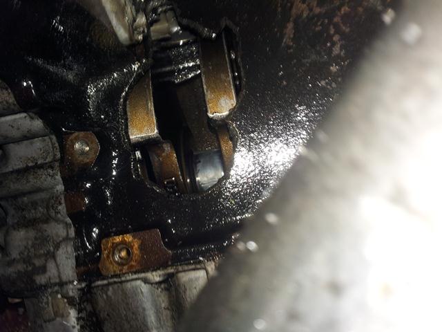

hello
reiceved the pump from dieselmeken, cooler and exhaust is ready, started the car with no problem.
Pump is running good thanks do dieselmeken Smile
but now i have some minor issues do fix.
have nice end of the year everybody Cool
the next pictures will tell everything Confused

dieselmeken
407
12-29-2012, 07:19 AM #10
ops! What happend? First pull or did it go oildry?
dieselmeken

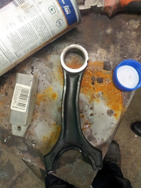

artuur
17
12-29-2012, 09:53 AM #12

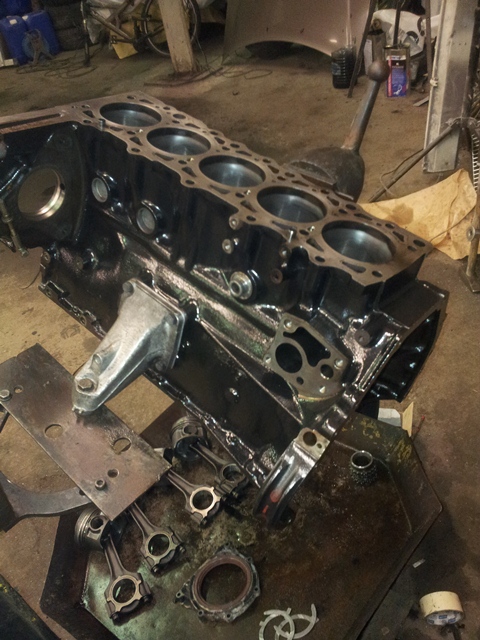

hei
the connecting rod bolts where like cut of,
i know that the engine is once rebuild and the bolts where old.
But its not a problem, i have one spare engine.
The new engine is getting forged rods and some other tuning parts.
Dieselmeken pump with 130cc worked very good, the first run and clutch disc was gone Smile
The roads in Estonia are snowy and we have some spare time do make the necessary repairs.
In february will try again.
Ill update if something interesting is going to happen.
cheersBig Grin

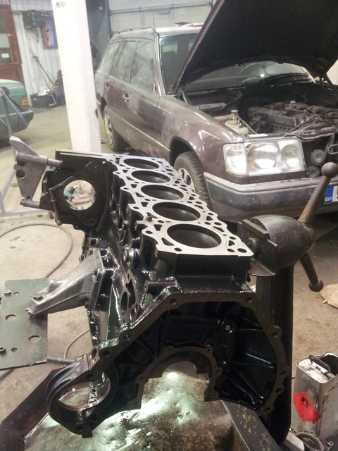

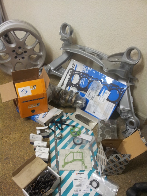

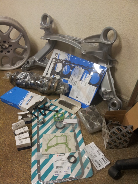

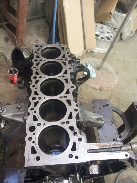

02-11-2013, 01:56 PM #14

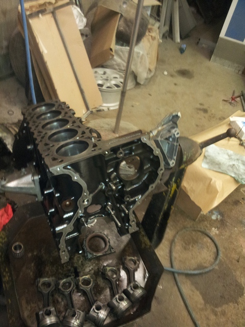

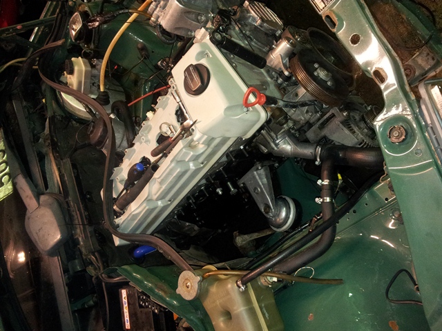

hello people
i havent been here some time.
Now is some progress with my new engine.
crankshaft is polished and balanced.
Pistons will be old but they are in very good condition.
connecting rod bolts will be new.
All new gaskets, new crankshaft bearings.
tuning valve springs, valve tappets, new chain and tensioner, new water pump,new cylinder head bolts and lots of more useful stuff.
Engine block is very good, had 200000 km on spido.
Everything is cleaned and looks nice.
Probably will hear the voice in march because i have to go on vacation for some nice weather in Egypt.
some pics allsoo.
Regards
Artur

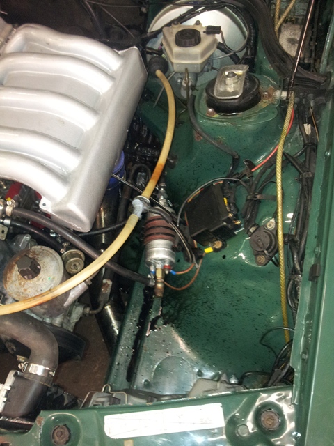

Artuur,
What are you using to control the pump? I only see a throttle cable going to it.
TheDon
03-17-2013, 06:53 AM #22
Artuur,
artuur
17
03-24-2013, 02:18 PM #23
Helllo
im using only one cable and self made fastenings.
[/quote]
one thing more.
I will use gearbox from bmw e34 535 getrag 260
This post was last modified: 03-24-2013, 02:20 PM by artuur.
artuur
Helllo
Probalbly next week get some new pictures, i have not had time do bulid the car.
hopefully the snow will go away and i do not have do fun with snowmobile.

Great Projekt, i hope you give us more informations about the performance of the engine next time.
Is the intake manifold stock or an prepared part?
