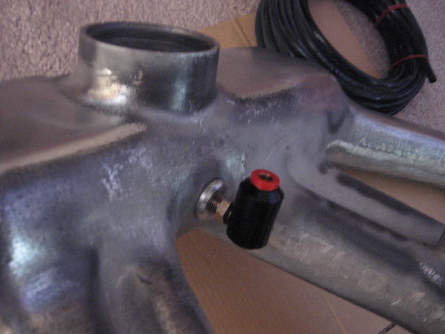

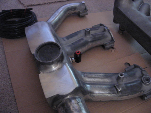

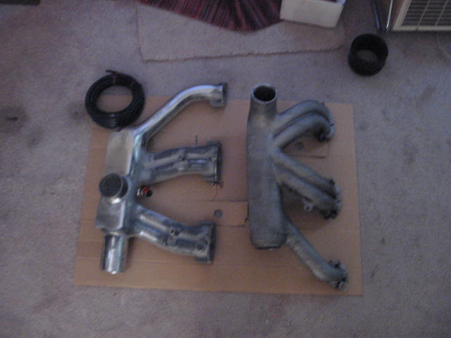

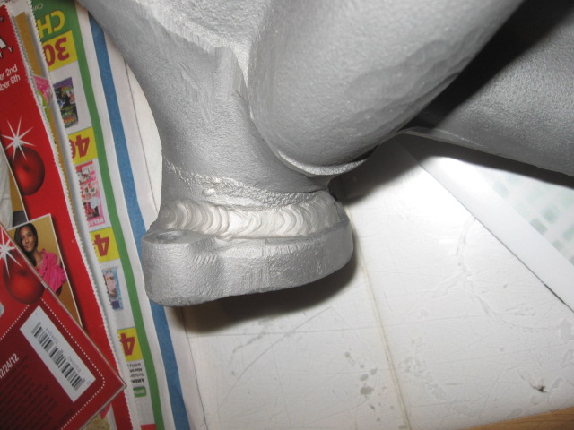

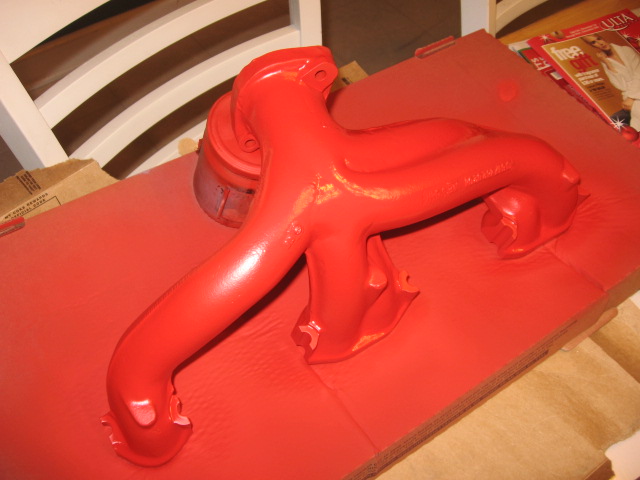

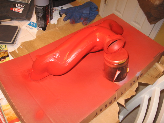

Since the Sleeper is headed to VSTECH's from PP tomorrow or Saturday at the latest for the drivetrain swap, I guess this is as good a time to start my new thread. Being impatient, I already started some mods, especially since I have been stuck homebound for a while now.

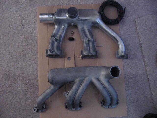

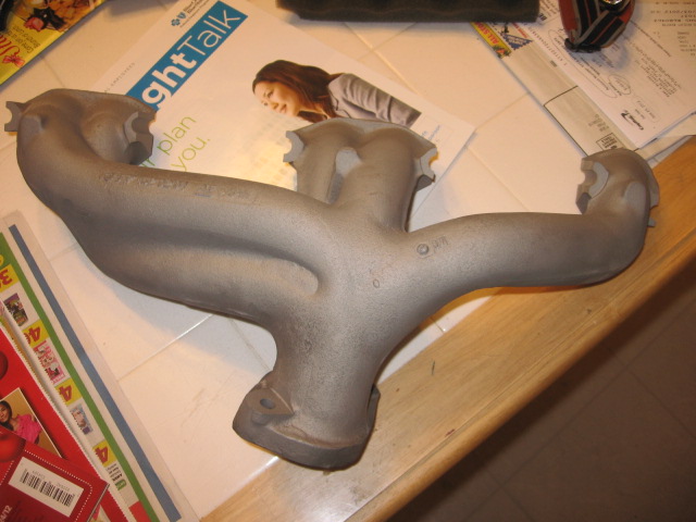

Here is the Exhaust Manifold I got from Simpler=Better. Here it is bead blasted, front and back. The back shows the weld repair I got today.
I then painted it tonight in my garage, but brought it in because it is going down to about 50 tonight. I followed the directions on the VHT Paint to a "T". Let's see what happens. I need to figure out how to cure it in a oven. My better half is already PO'd over this thing drying inside our home so the oven is totally off limits. I guess if she's home that is. LOL.
Once I get the Sleeper Part Deux home, I plan on installing the mainifolds. I should have my mods to the intake manifold done next week. So, that will be:

12-07-2012, 07:23 AM #4
A word of advice on the VHT paint: It WILL stink your house up like a chemical factory. Properly curing mine made it stick like you wouldn't believe-until it got soaked in salty slush and wasn't ever washed. When I did mine in my apartment I had to air the place out for two hours....the cohabitor at the time was not pleased.

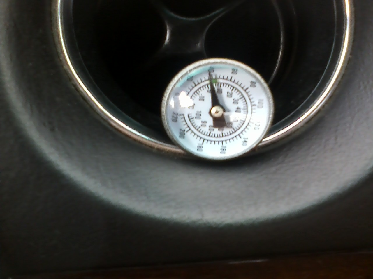

Got an IR thermometer? My turbo car idled at around 200-300°F, you could always cure it on the car and hold the accelerator in place to get the higher temps. Do you have room for a craigslist oven in the garage? Perhaps heating and cooling it on a grill? Really big toaster oven?
Now that those manifolds have been un-bastardized and cleaned up they don't look so bad. Glad they're being used and aren't at risk for being randomly scrapped when my Dad/ Brother go on shop cleaning sprees.

12-07-2012, 10:20 AM #5
That paint before the oven has really stunk up the place. My wife is super PO'd right now. LOL.
AND ... the red looks more orange. I am thinking of waiting a week and going with the black or grey.
Your thoughts.

12-07-2012, 10:51 AM #6
The orange-red looks sexy once cured and installed:

12-07-2012, 07:40 PM #8
(12-07-2012, 10:51 AM)Simpler=Better The orange-red looks sexy once cured and installed:
[Image: dscf0028t.jpg]
LOL .... Great minds think alike.
I got access to one of those laser thermostats. I also think I figured out a way to heat it NOT inside my house. Heard crap all day about that damn paint stink and "over spray" that supposedly got on the kitchen floor. NEVER, and I mean NEVER tell your better half that was intended as a gimick to get her to clean the floor more often. Bad move ... LOL.
OK ... I will keep the orange - red for now.

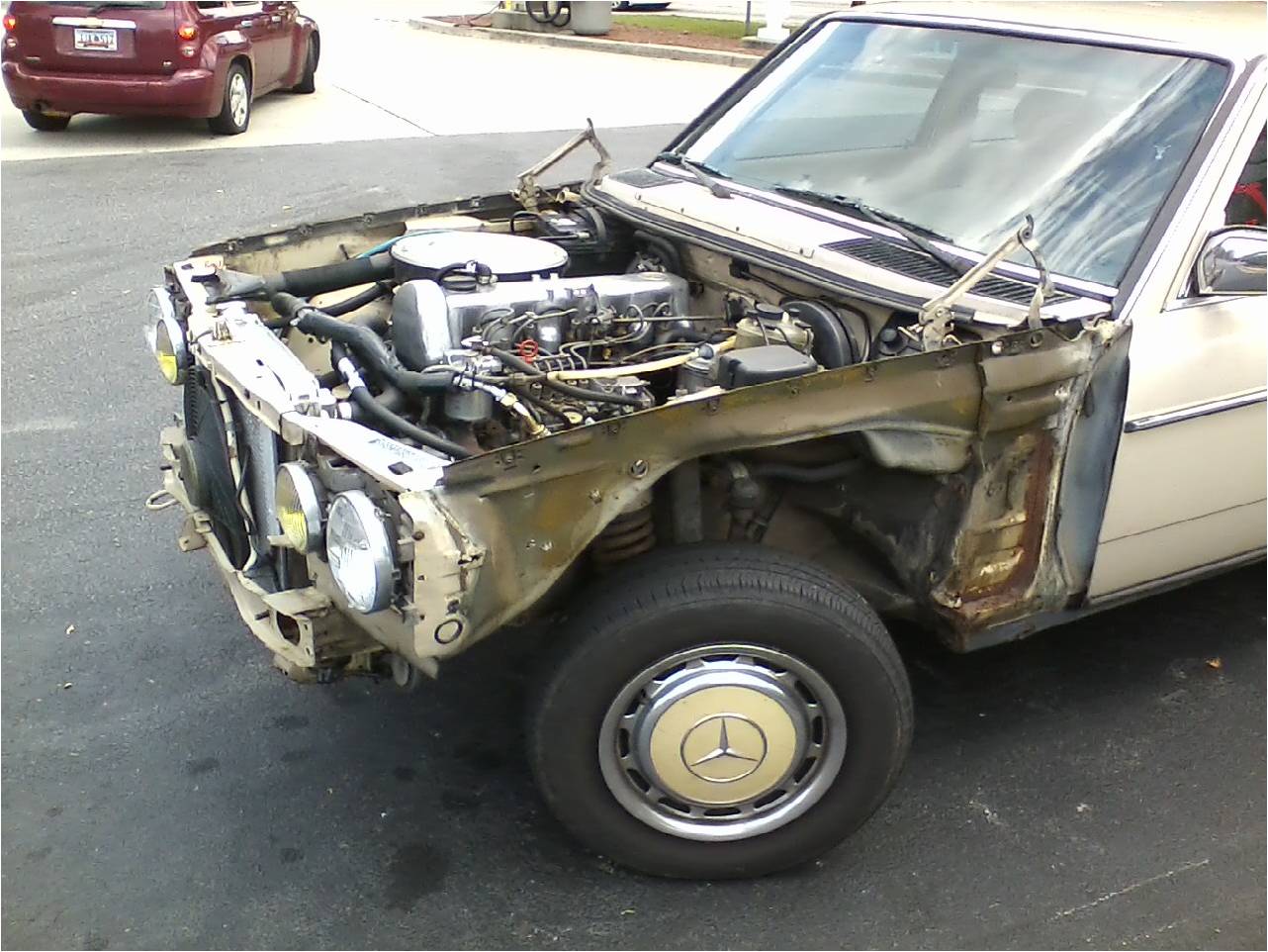

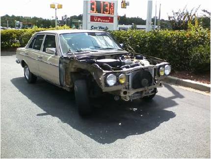

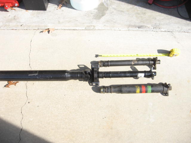

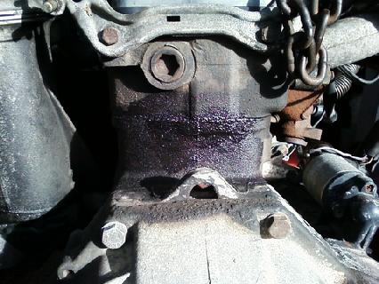

After my 4th trip yesterday to Charlotte, NC, still NOT done. That car I got -getting rid of is a complete WASTE of time and total POS. The new car is a pretty sweet ride and very nice condition, but what a TIME bandit.
So much for the so-called rebuilt engine just 65-70K miles ago. Nice oil headgasket leak. From the right side of the engine, you can see a pretty gap where the headgasket is missing. I guess the PO forgot to tell me that one. I got a very long list of "I forgot to tell you's ..." going on right now, such as below ...
So much for the 5th speed set up -- the front section of the drive shaft was a 240D HACK JOB ! The PO thought it OK to cut off about 1 + inches of the drive shaft so it would fit. So, no nut or rubber boot. Got pictures but I cannot find them on the cell phone. I will be posting these shortly.

01-07-2013, 05:17 PM #14
wow.
I was giving you crap on the other forum, but that sure does look like a headgasket is leaking right there. yipe.
How did he cut up the driveshaft? Is the threaded section cut off? I wouldn't think that was possible and have it work! looking forward to pics on that.
I have front driveshaft sections if you need one for resizing. I also know a really reasonable place out in MO which will relengthen and balance one of these driveshafts for a very reasonable price if you don't have a local place. well worth the cost in shipping it out there.

01-07-2013, 10:20 PM #15
He chopped off at least an inch maybe 2, so I got no threads. There is no nut or boot anymore since there is no room for it. It was wedged in there and done so tightly that I could not remove the rear flex disk. It is sort of "welded" in there. John even pried and banged on it a bunch and no movement whatsoever. So, not to sound the "I told you so routine", but excluding an incredibly short list of a few parts, every single thing one could dream of is screwed up, hacked up, rotted, rusted, and the list goes on and i do have an ever growing list of "I forgot to mention" ... from the damaged FW I now got, to the DS hack job, a totally rotten body, et cet et cet. So, for someone to tell me and the world that his car was "his little gem" and "mechanically sound" and had a "rebuilt engine 65-70K miles ago" and has a 5 speed conversion with all the fix'ens is simply delussional or not so forthright in their description of the car. In any event, I currently have the CORRECT front driveshaft part and that will be a major project very, very soon no matter what. I might need the info you got since I still need another front shaft since I am robbing Peter to pay Paul.

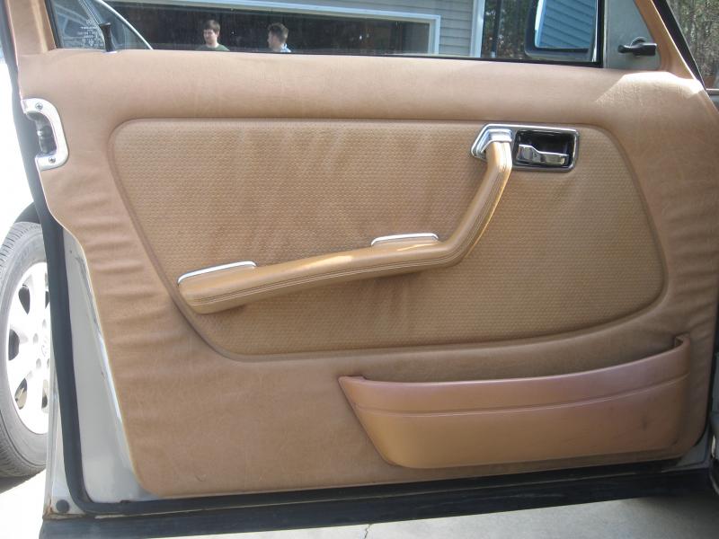

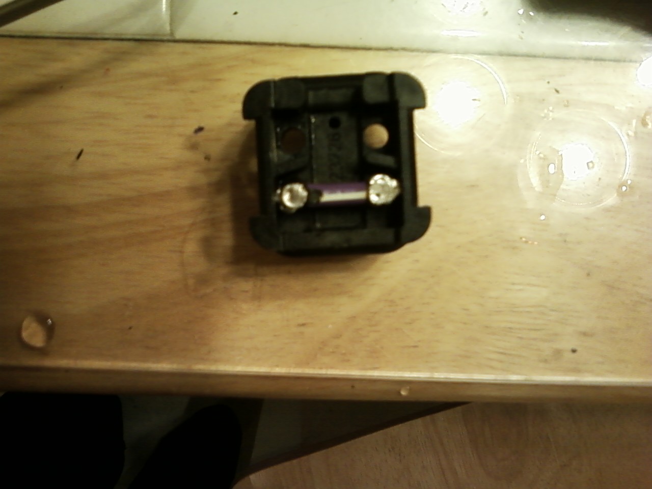

01-26-2013, 04:39 PM #19
I ventured outside for about 30 minutes and its Coldddd .... So, I did very little.
1. The jumper I made works great. Simple plug in and it "jumps" the NSS. Right now, I am looking for the 2 prong deal for the back up lights. I can now get rid of the wires that run through the firewall and out to the trans tunnel. It was very simple , plug-and-play. Here's a picture of it.

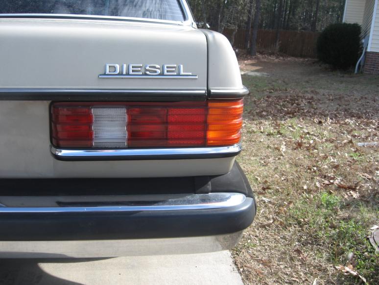

2. I decided to NOT sell my real tail light chrome strips and I just installed them. They look 100% better than the dull black rubber deals.
3. I got rid of the 2-point arm rest - door pull and added the 3 pointer. I really like this a lot better than the stock OEM deal.

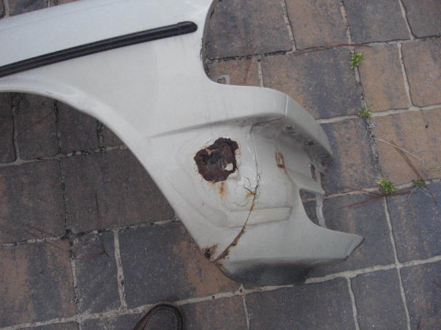

4. No pictures of the driver side (L) firewall drain tube. I found a really nice one, no cracks so that hole is now plugged up.
Overall, a productive 30 mintues. I put the battery back in and discovered I was missing Fuse #2. Now, my clock works and my dome lights work. Let's see if the battery drains out over night. I doubt I am headed back outside. Too cold and I think my wife is re-getting the flu and I am not far behind her.
Thanks to DeliveryValve and Diesel911 for thier info on the NSS. That was my most productive part of the day !

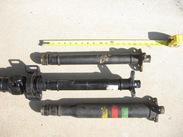

01-27-2013, 03:33 PM #20
Drive shafts.
Here are some pictures of the various flavors of drive shafts from a w123. Not sure if others exist.
The top one is the correct one for the 5 speed (Getrag 717.400) The Getrag 717.400 is the only known bolt on 5 speed out there.

Drive shafts.
The middle one is from a 300D with auto trans
The bottom one is from a 240 D with auto trans
The DS itself is mod'd for grease fittings.
I hope to get the DS in the mail tomorrow to get the middle one correctly sized for the 5 speed before I have a major issue. The ticking time bomb thread comes to mind right now.

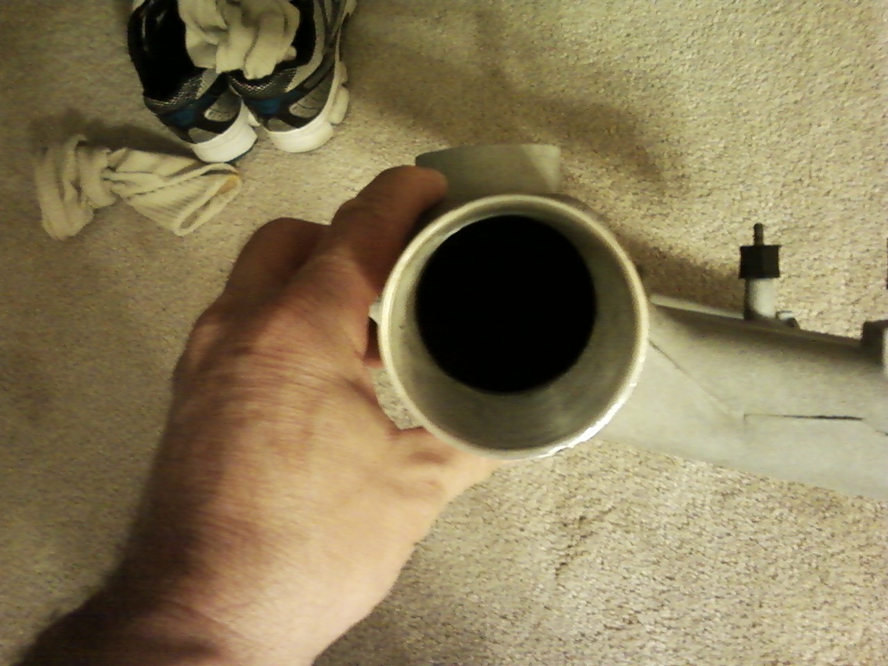

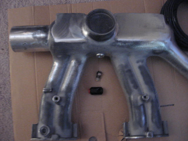

Weather went from 75-ish+ to a very chilly 40F and windy. So, I decided to complete my Intake-Exhaust Manifold and Exhaust System this weekend before the superbowl since I am now homebound a little with the crappy weather. I also found a "new" exhaust sytem. Still has the stickers on the muffler and resonator. So, my entire exhaust and intake system should be done along with the air box set up. One system down, 9 to go. LOL. I have a pretty aggresive goal to get'er done by end of March; that is, everything!
Here are a few pictures of the the 300D NA manifold. The top side view shows the Welsh Plug where the air cleaner box used to sit and where the air feed used to be into the manifold. The other picture is where the air feed will go. She is bored out to be slightly bigger than the OEM opening. I am going to be using my 84-85 California Airbox, and the inbound port will be for my .75 M+W nozzle for just water injection. The bead blast look is not so hot, so I will buff it this weekend to a mirror look and file down the welding so it will look quasi-factory. The Exhaust manifold is the NON-EGR type, so that will get some VHT paint, most likely black. Not so much love for the orange-red I did on Simpler=Better's manifold.
I decided to keep my 5.5 rims and matching hubcaps and got my alignment on Thursday from the area's old timer. Cannot beat $40 alignments, and your in and out in 30 minutes. Found some tires on CL, so checking them out tomorrow evening. Right now, she really drives incredibly nice and I think with new tires and the 5.5 aluminum rims early next week will be the charm. I scavanged my all new front end suspension parts from my totaled MB of 2 years ago and they will be going in next weekend. They had less than 3,000 miles on them and they still look and even smell new -- I found the box in my garage along with a bunch of stuff I will be selling shortly. It will be a flashback to 1983 as for the driving experience. I can get the old girl up to about 75 and smooth as glass right now. I got a lot of accelerator left after VSTECH fixed my accerator linkage. Still looking for the odds and ends for that, but not a major issue now.
01-31-2013, 10:25 PM #22

I'd love to see how that mani lines up with a turbo in the way. I have one of them manifolds and have never tried to see if it will fit.
larsalan

02-01-2013, 06:57 AM #24
This is 300D NA. No turbo for this old girl ... LOL

02-01-2013, 09:18 AM #25
(02-01-2013, 12:30 AM)larsalan I'd love to see how that mani lines up with a turbo in the way. I have one of them manifolds and have never tried to see if it will fit.
If you make a drop or angle adapter it *can* clear a turbo. With everything in the stock position there is no way it's going to line up.

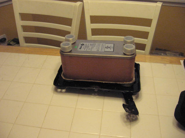

04-03-2013, 06:50 AM #26

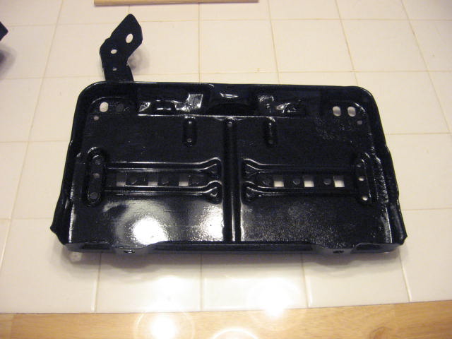

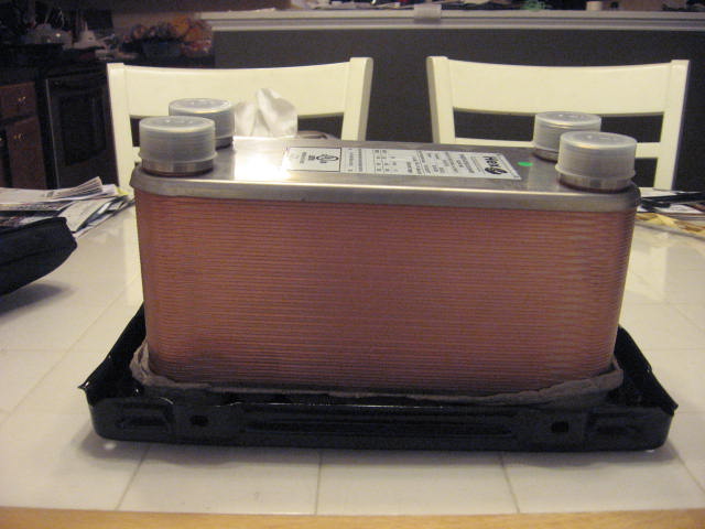

            Finally found some time last night to work on the old girl. Over a month or so. Here's a bead blasted and painted battery tray. Not the best investment in time, but I got to do some restoration. My new 50 Plate HE in and it's time for my 3rd WVO system. This time, I have worked out all 4 major issues in any WVO system and I am thinking this will be the last version. Greazzer 3.0 so to speak. I am hoping to find "some" time this weekend to relocate my battery to the trunk and at least mount the new battery tray with HE. This beast should capture most of the engine's free BTUs of heat and keep the WVO at a nice 180F. It holds over a quart. Just looking now for a suitable thermal blanket. I used to have a big piece of UH-1 helicopter thermal blanket material but I guess that got lost in the shufflle over the years. Any one out there with something like this? I need about 4 square feet, give or take. The HE measures 12"x5"x 6"

04-03-2013, 07:41 AM #27
I would use some adhesive-backed heat shield material. Something like this (although there are probably cheaper alternatives) http://www.summitracing.com/parts/hsp-721102/overview
Will you be setup to purge the FPHE?
Are your supply lines heated as well?
I'm always scared by people that run coolant all the way back. IMO electric is the way to go.

04-03-2013, 08:48 AM #28
With a 30 plate HE, the WVO never got above 130F with a return to the tank. With this, it will either hit 180F with a return to the tank or I will just loop it back. With the loop set up, I am absolutely guaranteed 180F. Also, the 30" Fattywagon Thermaline before the lift pump is more of a mental warm and fuzzy than effective heating, but instead of wrapping each steel line, I will have just one 30" steel line going diagnally accross the engine bay. No need to purge the HE. The worst case temperature drop is about 5* from the lift pump to the injectors. With my EWP, I can dial in the temp at 185F percisely, plus there is no restriction with no water pump (mechanical) or thermastat.

04-03-2013, 09:10 AM #29
Weird. I ran a (12? plate?) $85 FPHE and she hit 180*F no trouble at all, with the return going back to the (test 2gal) WVO tank

04-03-2013, 12:12 PM #30
That's why ... you were only heating 2 gallons. Still, that will take a while. If you shoot it back to the stock tank, you will lose a lot heat from the engine to the tank and heating 18 gallons or less. And, the line in the line is really not that effective as you loose more heat than you transfer. I only see that as a benefit or needed if you are in really cold area where you have to heat up the lines to get the grease moving. Also, the WVO does not heat in a linear fashion. It will jump to 125-130 F, then the last 50 degrees is a burden. I am thinking that the 50 plater and its masive surface area will do 180F even without a loop system or a smaller tank. I was initially toying with a 3 gallon WVO tank where the battery sits and just heating and running 3 gallons at a time. However, all that R&D was not worth it. Also, the thermaline from Fattywagon gets incredibly hot, but the surface area on a steel line will not heat the WVO a great deal. Elsbett ran some info on this a while ago, but they went out of business and changed their name in 2010 or so. I wish I saved their tech articles. I ran the steel line heater and it got smoking hot, burn your fingers hot, but its overall heating effectivness was really not that much from what I could tell. I am going to try running a 36" steel fuel line and running the 30" Fattywagon thermaline resistence line in a straight shot on the steel line with insulation. The coolant and effectively harnessing the BTUs from the engine is the real zinger. That is why I am looking for the gauages which have multiple readings. That is the only way to really see how and what is really heating. If I don't need a loop, then I would rather have 2 independent fuel line sets and just a "T" at the lift pump where I can shut off 2 solonoids and turn on 2 solonoids and vice versa. However, with the EWP, I am predicting that my WVO will be up and running, e.g., an entire quart, in about one minute. The thermaline will be heated in that time frame also. So, I will have on command at least 1 quart of WVO at 180* within 1 minute. The one quart is worth about 8 miles+ of driving since I am getting a little over 32 mpg right now. Plus, I like to start and idle my car about one minute before taking off. So, overall, this should work as precisely as I am hoping it will work but then again, I thought that about my two prior systems. Each had their pro's and con's, and hopefully all the little odd ball issues that pestered me are now gone.

On the one with temp on supply and return, I did two sensors, and two gauges, but on a previous car I wrecked, had a setup with one gauge.
I bought one gauge and two sensors, then wired the signal sensors into a two positon switch, and by flipping the switch, I could redirect the the sensor output.
On that one I was measuring supply temp and tank coolant temp. It was a pretty basic autometer digital temp gauge. It would sort of go to all zeros and reset with the new temp, but it did work and read properly splitting the signal and otherwise wiring as reccommended.
My ultimate plan was to get a double throw, double position switch and run 4 temp leads into 2 gauges, but I didn't get that far

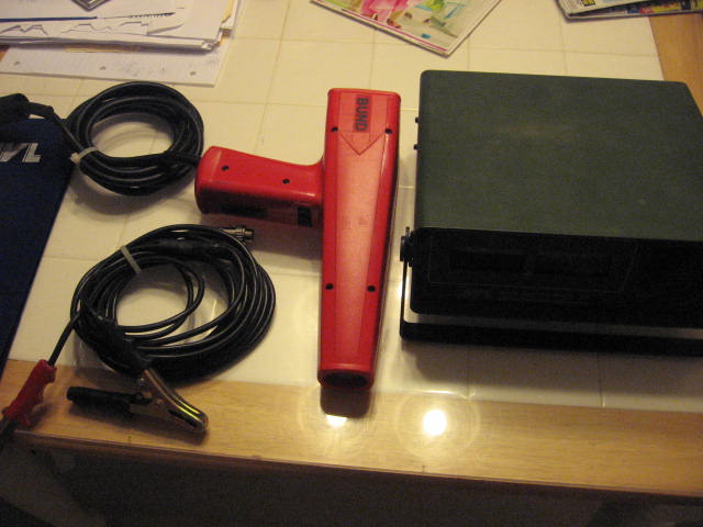

I picked up the AVL Bund 875 Diesel Fuel Injection Timer / Gun. Very very pleased so far. I need to source the missing cable. This way, I can exactly time the IP without using the drip method or any other method, and I understand this is perhaps the most exact method to time the IP. I also need to translate the owners manual -- it's in German. Since I know ZERO about the IP timing, I can use all the help I can find.

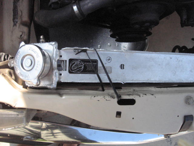

06-08-2013, 04:41 PM #39

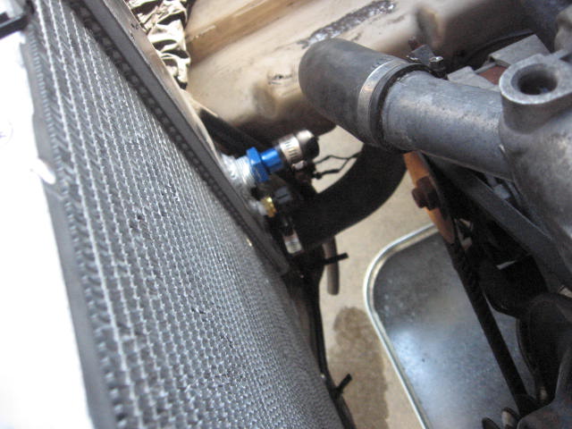

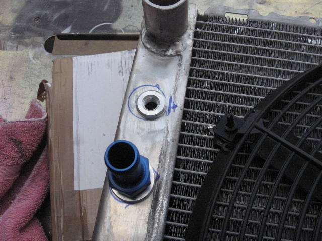

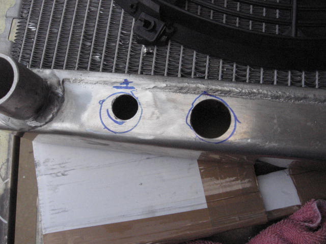

Found a few hours in the morning to remove the OEM radiator and condensor for some upgrades. It is now officially HOT in sunny S.C.
Removal and demo is pretty straight forward. I cut out a few holes and welded in a few bungs: Electric Water Pump sensor, drain (or pet) cock, and 3/4" return for the Heat Exchanger. I plan on using the auxillary water pump found in the PITA HVAC W123 system. Looks like once I get off my lazy butt, a lot of these projects will just fall into place since they are all somehow interrelated. Once all the mock up, R&D, PITA issues are done, I can move onto the looks of the Sleeper.
Here's the Be Cool 3" also installed. I hate the zip ties. This is just a mock up since it is coming right back out in a few days for the A/C install. Also, once I get my last missing piece for the EWP, the nasty water pump and miscellaneous items are gone forever. Right now the highest priority is the AIR CONDITIONING. I am putting in the Sanden 508. Just need the lines made this week. Missing the A/C right now ...

Since the radiator mock-up worked out pretty well, and I determined how I want to install it, I am now shifting to installing the modified intake manifold with .75 GPH nozzle M+W injection. I need to get some odd ball aluminum pieces in this week, so I am shifting gears a little during the wait. I will post some pictures of the radiator out of the car with the gizmos hooked up, et cet. Down the road, I will be installing a larger radiator which takes up the space where the oil cooler is. That's 1-2 years R&D. Right now, happy with the current Be Cool.
I won't be using the "M" in the M&W set up. Just water. The main purpose is to off set any possible coking or junk caused by burning WVO. Since my WVO will be heated to 180-190 F*, with 2 tank system, I am thinking the junk caused by the chemistry of WVO will be almost none. For those who want to bash WVO/WMO, all I can say is that I got 4 solid years under my belt and never an issue. If you want to bash, then start a thread on it. Otherwise, I'm very satisfied and confident in burning grease.
As you can see, there are some similarities between the mod'd NA intake and the 115 long runner. Other than the 115 looks sexier, I am thinking the modified 300 NA will look very sharp once I sand her down and polish it up on the buffer. Already hit the high spots on the top and she's pretty shiny with just 220 grit. I ground off all the casting lines, tangs, dog ears, and other boo boos. There's one deep gouge that will stay, but that is on the bottom. Otherwise, I am shooting for the chrome look from the buffer wheel. Plus, good by useless EGR valve !
The water injection items are from Devils Own. I really like their stuff. I got the 90* nozzle holder and a ton of line for all kinds of boo boos. I also got the huge 1.6 gallon resevoir out of the Euro W123s so I can run for about a week without fill ups.
Once I sand and buff, I can quickly install. I will post pictures. Supposed to hit mid to high 90's this week, so all work will be from 645-ish to 800 ish before it starts to burn up.

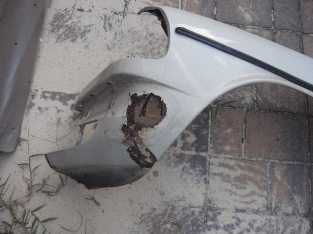

The old girl is off to the paint guy today. She's getting a new, freshly painted front clip in Pastel Beige, 684-H to match the rest of her:
1. New Fenders
2. New Hood
3. AMG Air Dam (Chin)
4. Any other possible rust on the front clip cleaned up and permantly treated
5. Inner plastic inserts in each wheelwell, re-dyed black
6. Inner wheelwell cleaned up and topcoated in chassis black
7. Front jack points cleaned, and new welds, and "like-new" appearances in the works.
1. New Fenders
2. New Hood
Here's some snappies. She looks sort of sad. I went ahead and ordered the front bumper to fender braces / brackets from the dealer out of Atlanta. Still looking for the black plastic pieces which go on top of the bumper.
I should have the ol' girl back in a week or two.
09-05-2013, 06:44 PM #48
Here are some close-ups of the fenders and their rot. Soon, all new sheet metal from the firewall foward.
Purplecomputer
Slowness 220D
897
09-07-2013, 03:10 PM #49
(09-05-2013, 06:44 PM)Greazzer Here are some close-ups of the fenders and their rot. Soon, all new sheet metal from the firewall foward.
Are you going to fix those fenders or are you getting new ones?
Purplecomputer
09-07-2013, 03:20 PM #50
I got "new" ... there's no fixing those puppies ...
