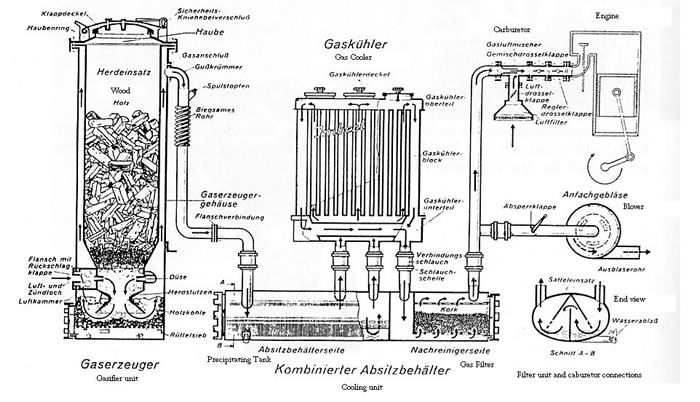

The science behind it is solid. A practical application of it is going to be a challenge though.
My understanding of the gasification process is that the fuel (plastic in this case) needs to be heated beyond its flash point in a pressure vessel and in the absence of oxygen. The resulting "smoke" is plumbed to a carburetor to be mixed with air and burned.
There are examples of this being done by the Germans towards the end of WWII. They converted some vehicles to run on "wood gas" using this gasification process.
Alternately, this "smoke" can be further processed by distilling the compounds to make a liquid "diesel" fuel.
I'd be very interested to hear more about it if you begin experimenting!
