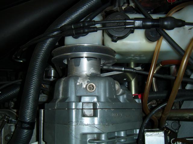

big 6 with mr eaton m112.
not much room down the side of engine for pipework, with inner wing.

The OE equipped M112 motors that I've seen have a separate belt for the SC. It sits in front of the accessory drive belt, requiring the long snout.
Have you thought about using nitrous instead?

Hi wayne, i have bought the same charger, and my problem is that im using an OM605 which is even shorter :0(
I have found out that the snouts on m90's are inter changable so you can get a real short snout.
The problem is trying to find a snout on its own with out the rest of the charger with out spending another couple of hundred quid.
The other slight issue is the M112 has the mounting points on the snout, and you would have to fab a bracket to hang off from somewhere round the snouts bottom bolt holes.

Mount it where the intake manifold goes stick the snout out where the fuel filter goes! and make a custom intake manifold

There is enough meat in the snout to cut it down and machine the bearing and seal pocket. I have done this with a M90.
I have a couple of GMC 4-71 and 6-71 blowers available that will surely provide enough air LOL... Plus, they could be under driven.

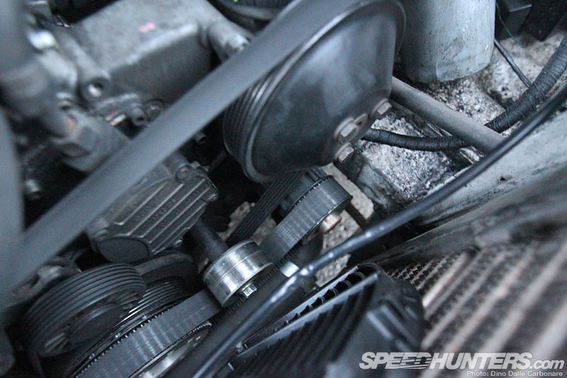

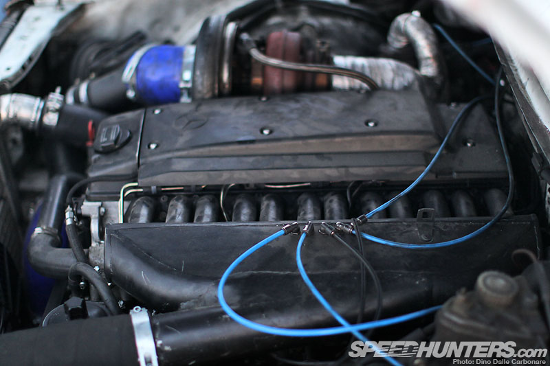

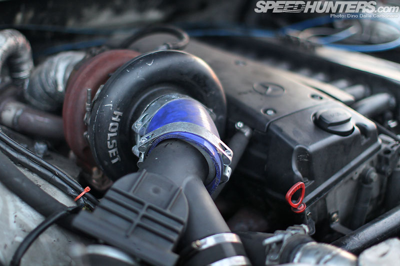

Hi Wayne, I currently have a kkk from a mercedes lorry but i fear that it will now be too small, once coupled with the M112
I am following black smoke racings delevopment and can get a cheap (less than half the price than the uk) hx52 that requires a rebuild from the states, but the shipping is quite expensive.
they run a modified hx52, along with a custom intake (these pics are from a write up a few months ago)
a modified charger belt that is toothed instead of ribbed (better grip i assume)
the M90 feeds the turbo directly (via a large plastic valve) and runs approx 50 psi
Im not sure if the hx52 is too big, considering the om605 is a full 500 smaller than the om606, so wont have as much flow, so maybe an hx40 should do
It will be in a w202 the same as yours.
as for space, i am doing away with the AC pump, and using the bolt holes on the block to help create the base for a solid mount
(om616, when you shortened your snout, did you shorten the pulley side of the shaft, or the end that the coupler attatches too??)
I would like to keep it a daily driver, and also TRY to keep the electronic pump, too, with some software changes.
Jemmu has a friend who has a 605 running Karala software, so maybe that is an option
