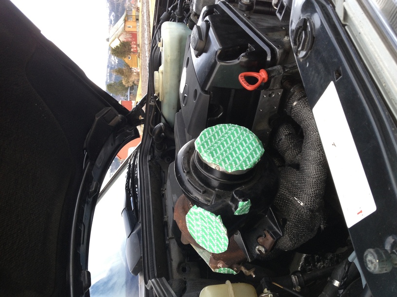

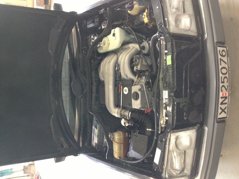

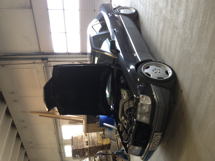

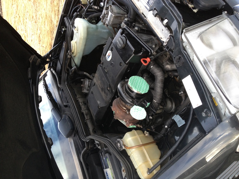

Hello. I´ve been around on the forum for a while now, mostly reading. So now i think it`s time for me to start my own project thread.
The car is a `94 E300 D Sportline. Originally a 606NA car. ASD diff, mushroom interior, tempomat, AC etc. A well equipped car in my opinion.
Bought the Merc for about a month ago and i`m very pleased with it. Firm steering and suspension for the age as well as minimum rusted body. I have tried many cars prom the early 90`s and I think the BMW E34 and Merc W124 is the best cars from that time.
I planned to put in a 606 and get about 250whp out of it, but much wants more... So Dieselmeken made me a 7,5mm 140cc pump. This pump should be good for at least 350-400whp i think.
But with my limited budget i had to go for a HY35 from a `02 Cummins that i had. Any opinion how much HP/NM i will get with this?
Think i will upgrade to a GT42 at the end of the summer..
Because i want to keep both AC and the tempomat i vent for a water to air IC solution. Found a Bosch 044 in my basement that will be used to feed the IP. Turbosmart pressure regulator and a Aeromotive filter.
I will use 10mm(overkill) stainless pipes from the tank to the 044 and from the 3bar fuel regulator after the IP for return lines. Any suggestions on bypassing the original lift pump? Just let it be there or take it of and make a plate over the hole?
JAAS Performance jigged up the turbo on a flange and are welding my exhaust manifold as we speak. They will also make the downpipe and mod my orginal 606NA plenum.
3" stainless straightpipe from turbo and back.
I will be using the old 722.3 trans for a couple of weeks until i get hold on a 722.626. It will be a pain in the ass not to be able to use the 606 properly that time toughAngry
Suggestions?Big Grin

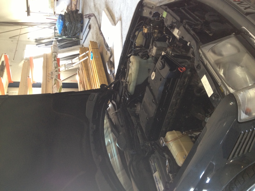

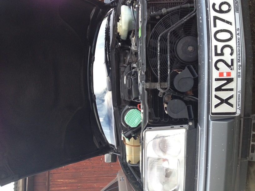

04-23-2013, 02:27 PM #36
Needs lowering!
Last pics with 606.910
606.962
Compressorhousing is turned now.
More pics of cooler etc will come!
Also ordered spec stage 4 clutch and PP today!Smile

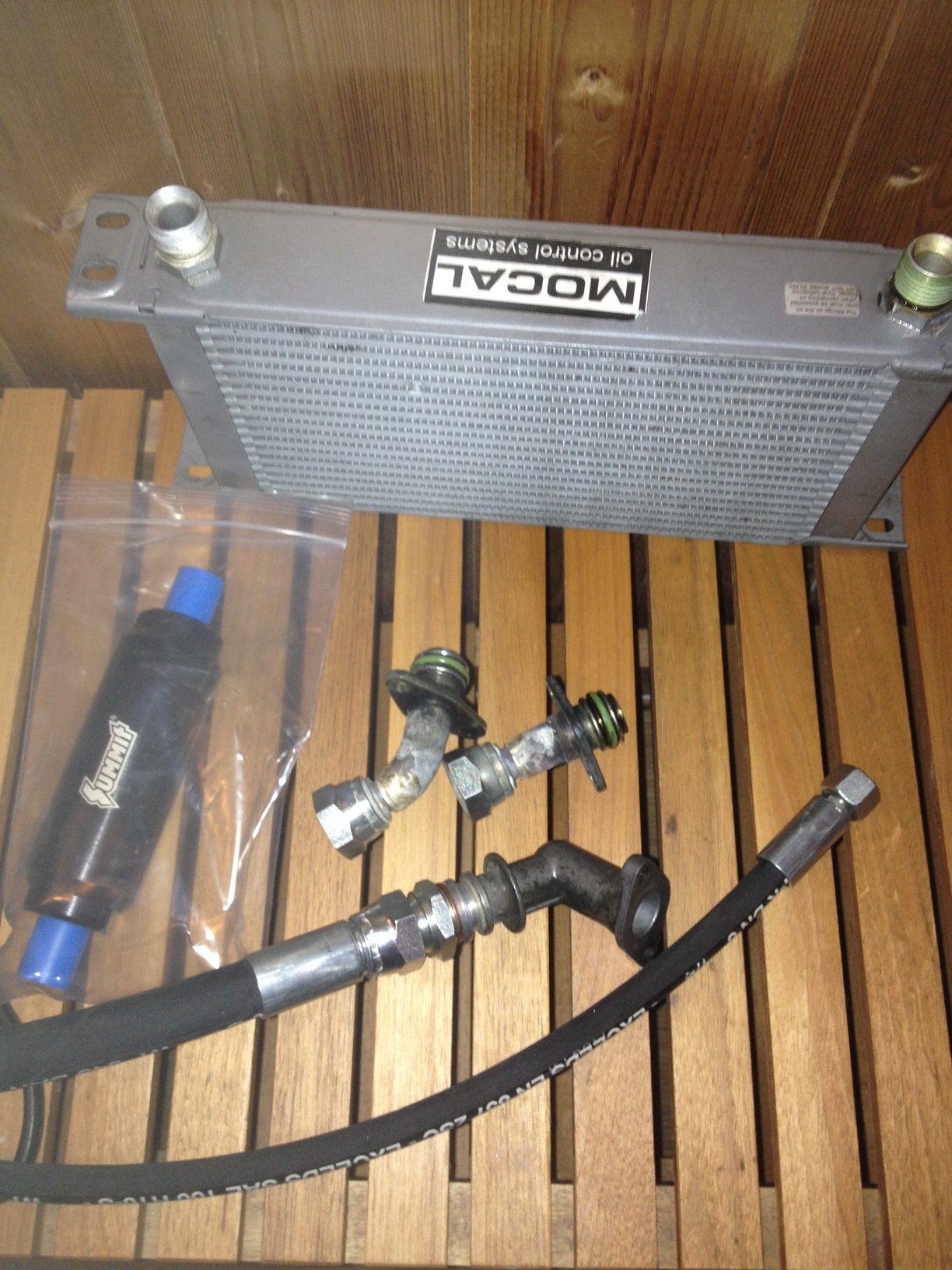

Made some oil fittings for turbo and oilcooler today. Also the the new dieselfilter.
This post was last modified: 04-24-2013, 04:19 PM by HaavardPYA.

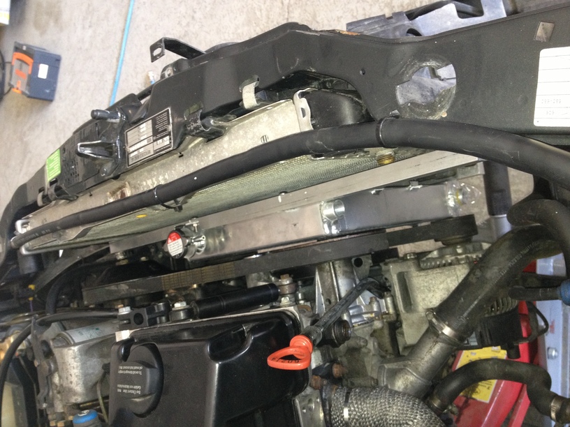

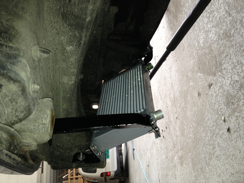

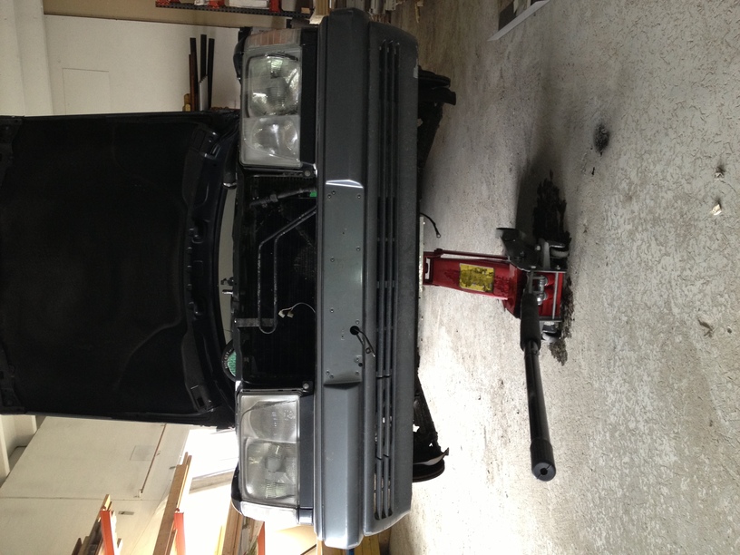

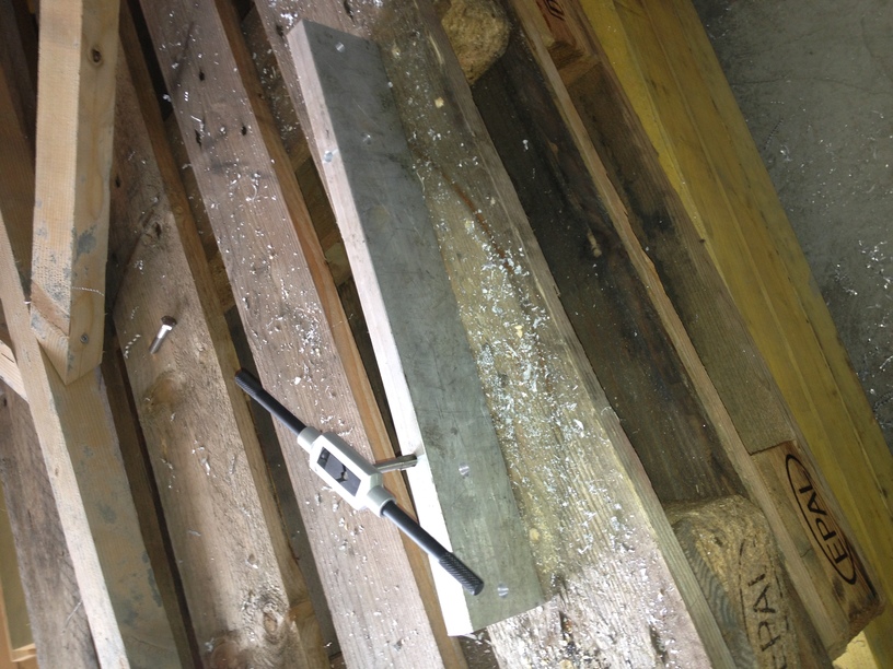

04-29-2013, 12:14 PM #41
I got drunk, so i`ve only mounted the oilcooler and radiator this weekend. Shit happensWink
But here is some pics:
Here is the lower mount for the radiator. Made so that the mountings for the orginal fan-cover is still there for later use.
Upper mount.
Oilcooler
Sleeper style! Nothing to see on the outside.
