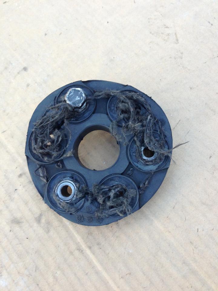

Had a great race this weekend. We were holding onto first place in our class when the flex disc failed an hour before the checkered.
This disc was only a few months old so I need to find something stronger. I'm thinking of going with aluminum and poly but don't know where to find them.
Here's a picture of the failed disc.

Search on here for your options. Some do have full aluminum ones. Talk to Winmutt. He does fo-sho. The 190e guys have them I believe.

Get me precise dimensions and I can make it happen with a 1 piece solid steel dealio, if you're confident in your drivetrain alignment

I'm thinking solid steel might be too rigid and cause other problems.
Anyone know where to get a aluminum and poly flew disc. I contacted revshift and no response.
