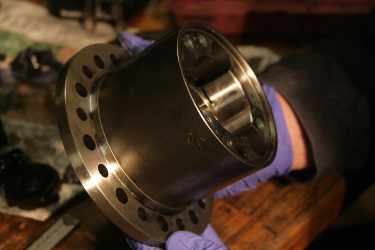

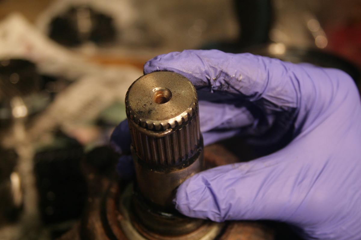

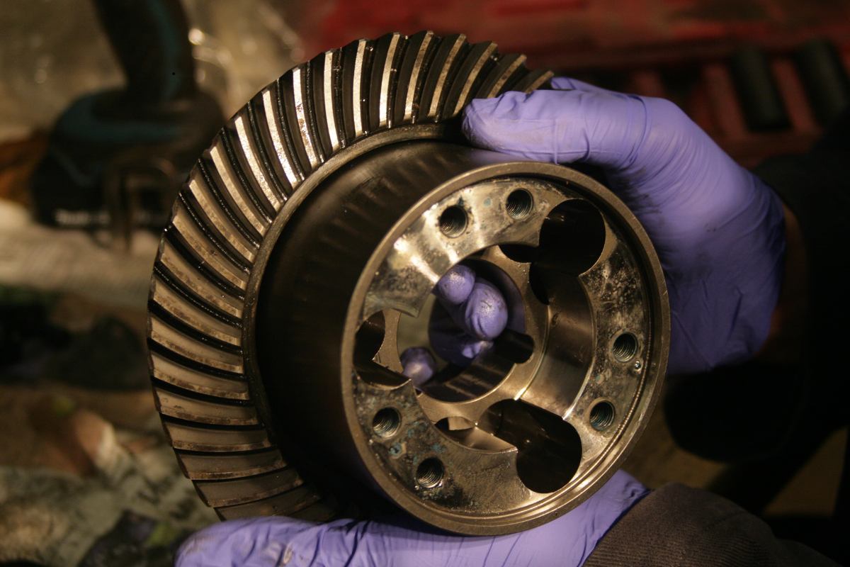

I have a cosworth differential but I'm interested in getting a truetrac into a 3.69 rear end.
this is a Dana 30 truetrac. the axle shafts appear to be the same size.
the issues of adaptation that I foresee.
1. c-clips: I believe one could use spring clips a la a supra diff (see pic)
2.bearing size: the merck uses LM503349 to a 331944 outer race and the dana uses LM501349 I'll be calling my bearing person as soon as I can.
3. ring gear: I talked to a machinist, who can turn the carrier and make a pilot bushing and spacer for $250 and significantly less for more units. The Mercedes bolts go through the larger holes but don't center.
So super turbo people: what problems can you foresee?
would you want one if it works?
can you see a better way of doing it?
llopness
04-22-2013, 09:12 PM #1

04-25-2013, 08:40 AM #5
It's not happening.
the shaft where the bearing sets on the TT is 1 5/8"
and the bore where the outer race sets on the merck's diff housing is 85mm
and there aren't any off the shelf bearing to span that.
so with $350 for the TT
$250 for maching a pilot bushing and spacer
$??? bearing bushing
and then all the ancillary bits like the bearings themselves.
I am however trying to poke eaton to see if they can just not cut as much metal off to begin with.
