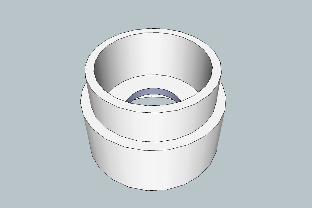

06-25-2013, 02:18 PM #10
An early design for an aluminum spring spacer, which I may still use for the back...
(damn solidworks license finished so I had to use sketchup)
    (I have a lot of other drawings for this)
Later, I revised the design to use thick wall steel pipe and weld in a disc, instead of a solid design.
