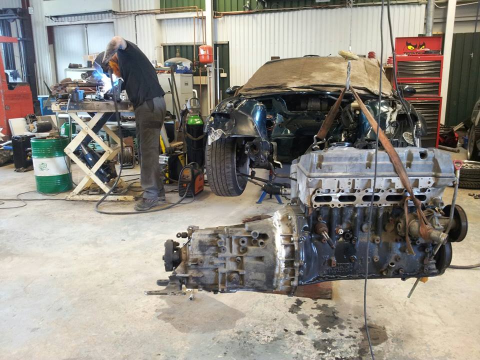

just got done building a turbo gas engine(3liter 16psi,hx35,398rwhp,445ftlbs), but it doesnt suffice when you miss that diesel knock and whistle all the time.
i want to build the om606 for 400hp or near it. ive been out of the diesel scene for quite some time, didnt know if there has been new discovers on more US parts readliy avalabile? and how can i go about getting 300-400hp from these motors? what kind of engine work?

engine will be fine, you will need exhaust manifold, turbo and modified injector pump.

yea, standard injectors are fine, i use Dieselmeken on here for pumps.
you will need to do something about clutch.

6 speed manual out of c220cdi w203 bolts up and should be able to put up with your goals
ive got one bolted up to my 606 sadly still not finished

the cyprus guys dynoed 600hp with stock engine and 180cc+garret turbo

it must be on the flywheel...600 whp, then you need alot more fuel and hx52/hx55

a local guy with om606NA and dieselmekens 8mm pushed the engine (by accident) to what he estimated to be 8000rpm Tongue
not funny to see this when taking the engine apart Tongue

The general rule of thumb is a little more than 100hp/cylinder for the turbocharged om605/om606. Say 550hp for a om605 and close to 700hp in a om606. So 600whp will be doable in a om606.
This is stock engine were talking about. Higher outputs will require other camshafts. Some rods and pistons would be a good investment also.
Stock valve springs can cope with 6k rpm. To rev 7k rpm you'll need tougher springs. We are currently building a om605 for 700hp, that's a 242cc Dieselmeken pump with a 7250rpm rev limiter. We also build a more moderate om604 with a 8mm Dieselmeken 180cc pump that we hope can deliver close to 400hp.

apperantly he missed a gear,
gave it WOT and apperantly the IP didnt stop untill way to late...
Dont know if its a pump fault or actualy how it do work, but it makes one kinda worried, better make shure the gear will stick before giving the engine WOT or WOT in first gear.
will try to stick to the 5500rpm and rarely 6k.
but makes you wonder weather or not the revlimiter works properly on these modded pump (if he estimated that 8k correctly) but way over his "regular" 6k atleast.

well its also possible to put a electronic over speed unit on the engine and set it so it shut down at 6100 rpm I use them all the time on gensets for offshore they are not so expensive compared with the repair costs.
you just need a magnetic pick up and the wire for the stop solenoid and its possible to make it stop if you have low oil pressure also.

stop solenoid i already got, the question is if that will be sufficient to stop the reving in time...
the oilpart is probably sweet thou Smile
(aswell as overheating protection Wink )
