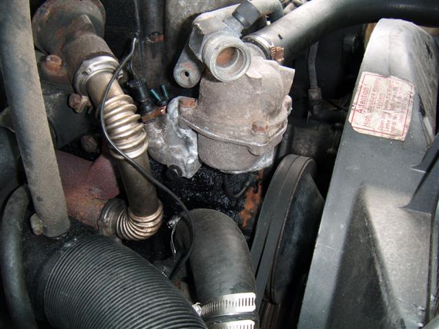

Franko
13
07-11-2013, 08:22 PM #6
Can you explain a little more how you did this? Looks like you just rotated the thermostat some how?
Franko

OM616
10mm MW
574
07-12-2013, 09:49 AM #9
(07-11-2013, 08:22 PM)Franko Can you explain a little more how you did this? Looks like you just rotated the thermostat some how?
I did that about three years ago and do not remember exactly what I did lol...
You are correct that it is rotated. I remember that I had to put in a thermostat by pass restrictor so it would warm up quicker in the winter.
I am using the stock Thermostat, summer highway temps are between 165F and 175F, right where I want it to be.
If you want to try moding the thermostat housing, I recommend getting a used one and playing with that. I did a similar mod on my 240D, but in that case I made a in line thermostat housing that I put in the top hose.
OM616
