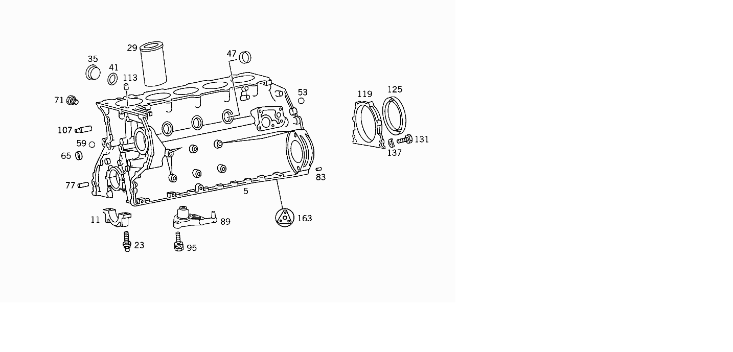

Seems odd to me there are not any "repair" or oversize pistons for this.
Here is the EPC image for the liners
The Sleeves are cheap money, $29 per. The piston set also not to bad at $700.
Duncansport
08-06-2013, 06:42 AM #3
