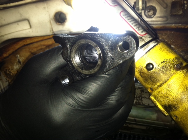

Anybody ever get a ratcheting tensioner on a turbo '82? Because I got one last night and it slowed us down big time. All set now though, got to pull the thermostat and all that crap.

(08-21-2013, 08:47 AM)Simpler=Better Anybody ever get a ratcheting tensioner on a turbo '82? Because I got one last night and it slowed us down big time. All set now though, got to pull the thermostat and all that crap.
Every replacement one ive done is of the ratcheting type.. Not sure when the change was made? Bilstein is NLA from 1/2012

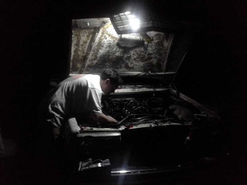

Everything is bolted back on(offset key, valves adjusted, chain tensioner, water pump stubby hose, new turbo oil lines, GT2056V, w115 intake, new glow plugs), all ready for a test fire aaaand dead battery. Also, I'm pretty sure I killed the turbo last night-but the test fire will tell the truth
And because y'all like pictures here's our fancy workspace:

like your workspace shot, very dramatic lighting.
looks like you guys are assembling a bomb in secrecy

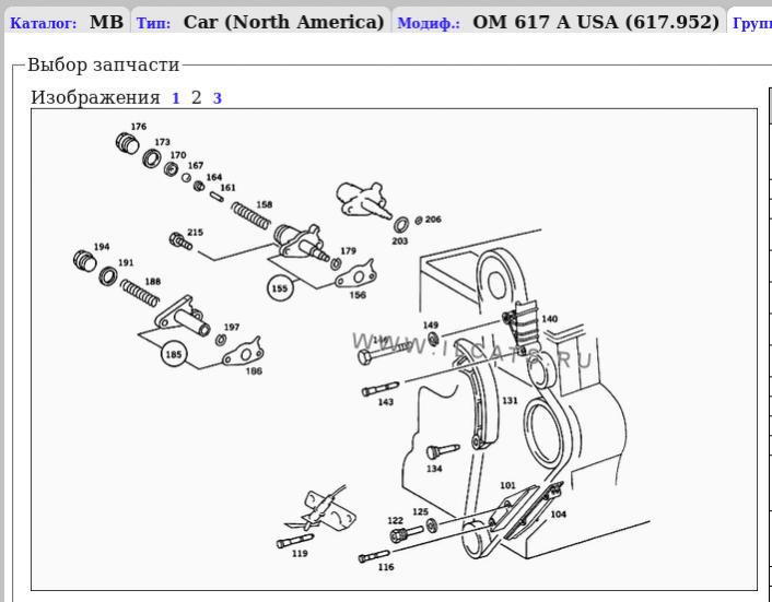

Can you take a location pic of the ratcheting tensioner and or describe where this is located on the turbo and what it does? Because that looks like a small driveshaft flange to me with one ear broken off. Big Grin

It's the timing chain tensioner. When we put in the offset key the bastard slipped tighter and cranked down on the timing chain, which forced us to pull the thermostat housing and tensioner assembly in order to get the cam sprocket back on. Which meant an additional couple of unplanned hours mucking around, draining coolant, going to the store for a new radiator hose (while we're in there better replace the 30yr one), etc.
#185 in the pic below:
[Image: 111739d1368988223-cant-source-om617-timi...sioner.jpg]
http://mb.bolinko.org/15/warsztat-mainme...ioner.html
