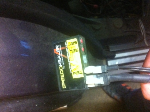

I have searched long and then I found a box called SpeedoHealer V2. normally used for motorcycles.

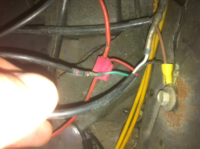

sorry for the bad foto its under the backseat
red 12v to box
black is gnd from box
white and green is input and output (long ago i dont know what is in/out)
brown comes from diff with a second that makes the signal goes into the box and comes out and i go to the front to my speedo.

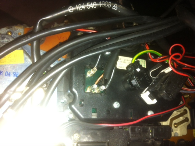

at back of the 500e tach there schould be a 3 pin plug. my 300d has in stock there a 2 pin plug. its only + and - .. i destroy the plastik from the stock plug to fit the 2 pins. the upper 3rd pin is the signal in (that i have from my box came out)
red 12v to box

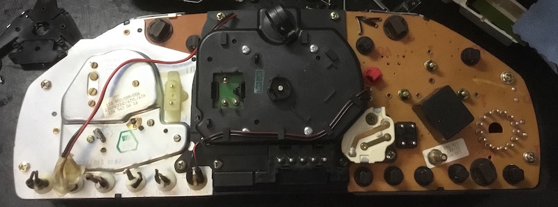

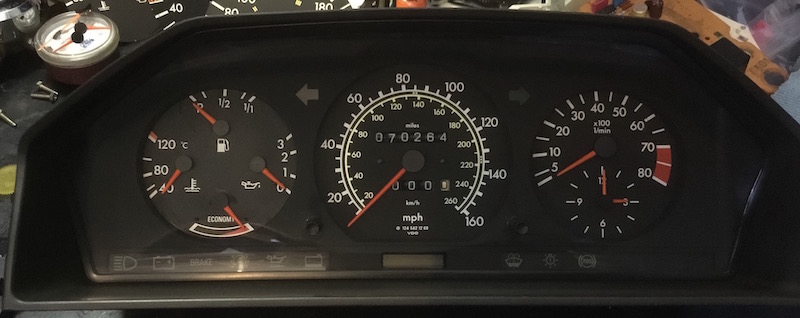

I had to butcher part of my spare w126.039 cluster to make the cluster and gauges display exactly how I wanted.

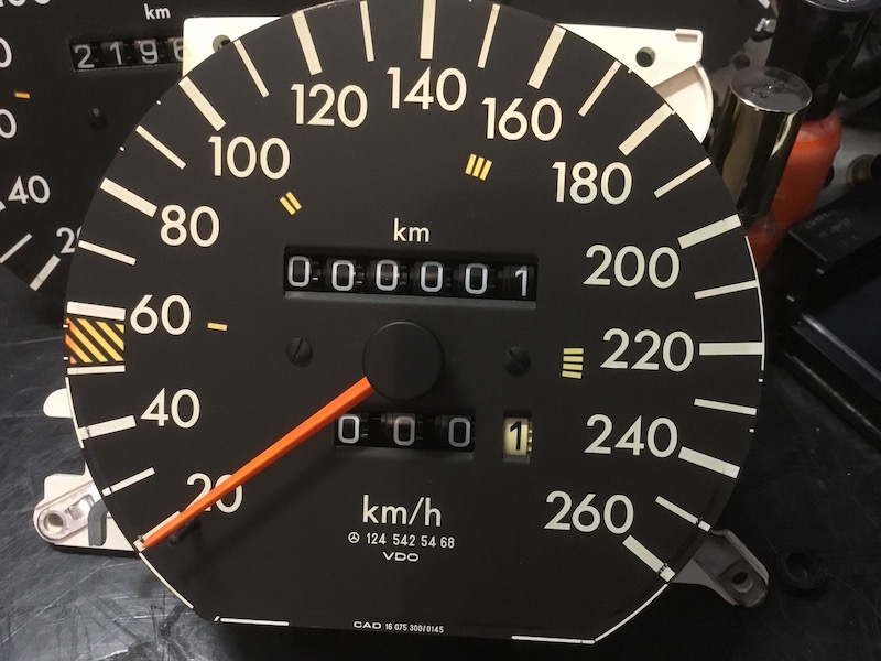

Original mechanical 260km/h speedo (for dial part number reference only)
