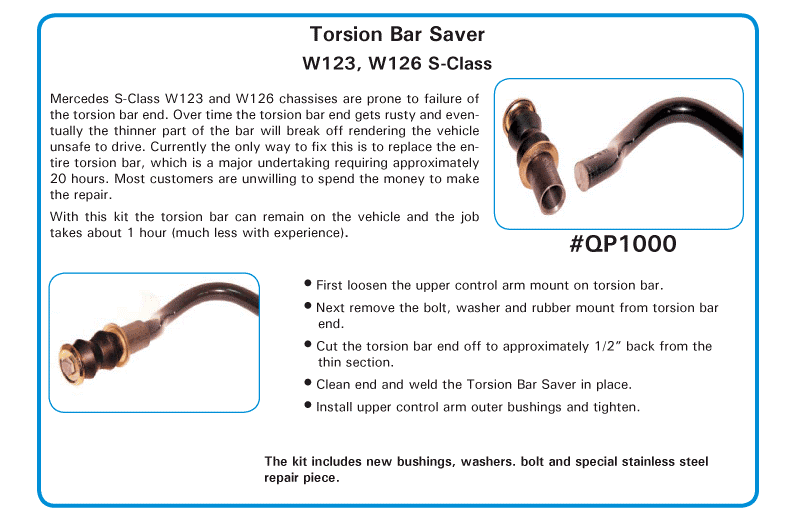

07-07-2009, 03:19 PM #3
Can you post a picture of where it broke?
There are is sway bar saver kit if it broke at the bolt end.
http://www.peachparts.com/diy/mb_tools/m...hp?page=35

(07-07-2009, 03:19 PM)DeliveryValve Can you post a picture of where it broke?
That is about where it broke off. Would a shop do this or would I have to find some guy with a welding machine.
I wanted to get a picture but it started raining. I think I might just buy the part so that I can get my car back in good shape.
