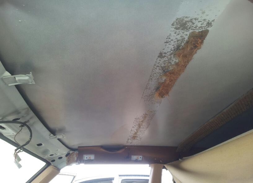

i deleted my sunroof with a plain panel and 3M epoxy (400 square inches of contact area!). the chassis roof is intact up to the sunroof opening. the epoxy isn't supposed to be used in any structural application, so i'm relying on the stiffness of the original roof with an opening in it. i left the flanged/stamped edge in place FWIW.
now, i'm looking into cutting out this leftover frame, which i can still hit my head on. at the front it has just two spot welds which couldn't provide any structural strength, but on the sides there are a few inches of welded connection to the chassis. is this part present in non-sunroof W123s? any reason i can't cut it out and have some kind of rib welded in a less intrusive place all the way across the ceiling? would that even be warranted for street use unless i could detect the roof getting torqued?
if i could remove this little frame, it would reveal that dark gap or channel all the way around the car, and that could be a fantastic place to hide new lighting.
[Image: insideroof.jpg]

I would just cut it and then brace as you can. There are guys running around with redneck convertibles (read: they sawed off the roof).
Without those braces the roof may flex and resonate, but you'll have to cut those out to find out.
To test for torque get some modeling clay or something similar that will harden to be brittle when cured. Put it between two pieces that you think may be flexing and let it cure. Once it's dried, take some corners hard. If it cracks or deforms then you know that it's flexing.
Play doh may also work to tell you what moves.
10-01-2013, 08:45 PM #2

take the risk eh? great idea on the modeling clay, thanks, S=B.

My truck flexes A LOT from the factory. Cheapo cab-on-frame, there is seriously at least 1" deflection in the frame when going through a ditch. It's fine, there's no rust and it's structurally sound. A little flex can be acceptable.

This flex idea is great. Until flex immediately turns to crimp and bend, haha. Semi trailers are intended to bend. And the ideal of steal bending is some of its great value. Conversely, this all reminds me of a time I seen an old ford straight truck loaded with logs looking something like this after trying to drive down a curved grade.
http://image.4wheeloffroad.com/f/1172439..._frame.jpg
All that said. I think the hole in the sunroof is really not much of trouble presuming the rear half of that 300d over the back seat is still fully intact. That 1980s german steel car is nice and strong.

Checking the flex with modeling clay is a great idea.
I say just go for it and remove the frame.
I would however, try to glue in a couple of cross braces after you remove it.

Some entire roof skins are held on by nothing but epoxy. Unless you used a very poorly chosen epoxy, you've already added structural strength. I say cut it off and don't worry about it.

i will cut it out and report. anyone got a stash of modeling clay?
PS, ray, as far as i know, it was the right epoxy, and an entire pair of tubes' worth. now i have to decide what to do with the special application gun. anyone else looking at this project?

I saw w123 at the yard without a sun roof. Took some pics of the interior. No cross braces, just outer skin sheetmetal.

thank you richard!! that's a trip. mine will look like that soon.

winmutt, i am not even 6'1" but all my height is in my torso. that means i have to slide the seat all the way forward, which raises it!! the geometry is hella wrong for me.
anyway, i am two sessions deep with the angle grinder. i have had to cut the pan out all the way around its perimeter, not just at those welded attachments on the side. it's a very difficult job to work upwards with a dangerous, noisy power tool. i am fogging up my safety glasses every thirty seconds or so. it would be much easier if the seats were not in the car!! i will have to do a lot of cleanup afterwards.

today i had to do most of the work with the sawzall. destroyed a couple of blades by bending them. i even broke open one of the epoxy sections on the inside trying to pry the stamped steel apart for cutting. this is slow going.

this was extremely difficult and messy. i had to use the angle grinder, sawzall, wire brush drill bit, vice grips, etc.
[Image: SAM_2010.JPG]
finally think i finished. how can i clamp those loose edges upwards to reglue the parts i delaminated while prying?
[Image: SAM_2014.JPG]
do not do this with upholstery in the car or you will end up having to try to clean it all with a magnet:
[Image: SAM_2016.JPG]

An air hammer will bend that back where you need it. It looks great, I can't wait to see where you take it.

man this is some major work you have been doing. I probably would have gone for some kind of seat change, but I like what the roof looks like after removing all that. I have roof plans down the line that you have benefited with these pics.
I think you need to get an air hammer with a flat end attachment to flatten those bits, but you need to get a buddy outside the vehicle with a big piece of steel to work on the other side of the air hammer for it to hit against without distorting the whole roof, kinda the way you install a buck rivet as an example
Wouldn't do to make a bunch of dents in the roof after all this work.

Looking good with the head room Aaron. x2 with the air hammer, probably the best tool out there.... Unless you find a gigantic "c" clamp to smush it in place!

JB3, as i recall, i saw how the passenger seat could be permanently modified to sit lower, the gain would have been about an inch. true, it would have been a lot less work than what i did. i needed to address one specific thing, which was the 90 degree edge of the sunroof frame above my head. now, i can _still_ hit my head on the ceiling, but thank god, on a flat part.
now that i think about it though, maybe it would be possible to reverse or to offset the whole adjustment mechanism beneath the driver's seat so that its travel had different characteristics. maybe if the rails were slightly removed one way or the other there could be some more height saved.
i will look for the air hammer. dejankification continues. thanks folks for the support!

i have not had any flex or resonance problems in the roof. still need to finish the interior, but it does seem that extra strength isn't needed... for my driving style anyway.
