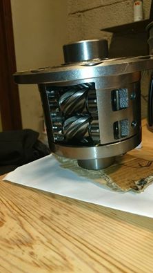

Picture of diff:

swampmonkey
hx40 super
280
11-24-2013, 09:34 AM #4
thats sweet!
where did you find that? and will it fitt inside the housings? custom build?

mercemann
13
11-25-2013, 04:44 AM #5
It is an original Diesen Torsen diff that AMG used to mount on the cars that they modified. So it should fit inside all W126 V8 housings.

mxfrank
36
11-25-2013, 09:05 PM #7
Ratio shouldn't change. The Torsen replaces the ring carrier and sun/planet gears, it uses the same ring and pinion as a regular diff.
You can buy these new from Quaife.
http://quaife.co.uk/shop/search/results/...C267%2C925

mercemann
13
11-26-2013, 03:17 AM #8
(11-25-2013, 05:36 PM)swampmonkey Where can i find one and what ratio will it result in? Big Grin
I dont think you can find one...
I got mine from an old storage from the 80s...

12-02-2013, 02:50 PM #10
(11-25-2013, 09:05 PM)mxfrank Ratio shouldn't change. The Torsen replaces the ring carrier and sun/planet gears, it uses the same ring and pinion as a regular diff.
The surface that the ring gear bolts to on the carrier is spaced differently on the low ratios (2.65, etc) than the regular gasser ratios. Since they're specifying a 190e 2.6, it would be wise to assume that it's for the shorter gasser-friendly ratios.
