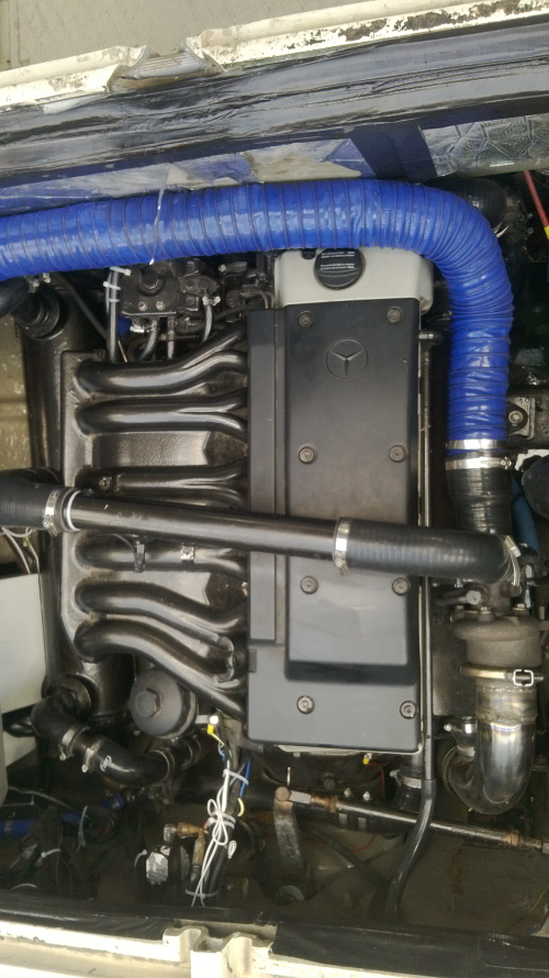

Hi all
Just to let you all know how I have been getting on with fitting 2 OM606 TD engines in my boat.
I have found this forum very helpful and constructed the exhaust manifold from some pictures published on the site, investigated mechanical IP fitting, and many other members’ ideas.
At first I decided to go the 603 mech IP but after many failed attempts to get good pumps and also the drop in HP from standard IP`s (without the huge cost of fitting larger elements in the pump) I thought that I would look into converting the electronics from the vehicle to run just the engine.
Well after nearly a year they are in my boat and running with the ECU and K relays running the engines, no smart key no EGR, I had to alter the wiring loom and all sorts of other items but got there in the end
They are so easy to convert the ECU`s over and you end up with just four connections Ign Feed, main feed, alternator light, and ign excite, and also you can Chip the ecu if you want more power without messing with the engine, I am looking at this as well and I think that 210 HP will be very easy to sort out.
I will post pictures later of them fitted in my boat and will soon be doing sea trails to see how they perform, will keep you informed.
See pictures here http://s925.photobucket.com/user/kws1951...t=3&page=1

03-18-2014, 12:22 PM #29
[attachment=7268][attachment=7268][attachment=7268]Hi
I went out in the boat the other day and she ran fine both engines ran up to 4000 rpm and she showed a speed of 16knts.
I am going to chip the ECUs now to get them up to 210 hp and better torque so she should go even better.
I will put some pics on soon.
Kevin

speedwellfane
24
03-18-2014, 03:41 PM #30
    More pics
This post was last modified: 03-19-2014, 05:08 AM by speedwellfane.

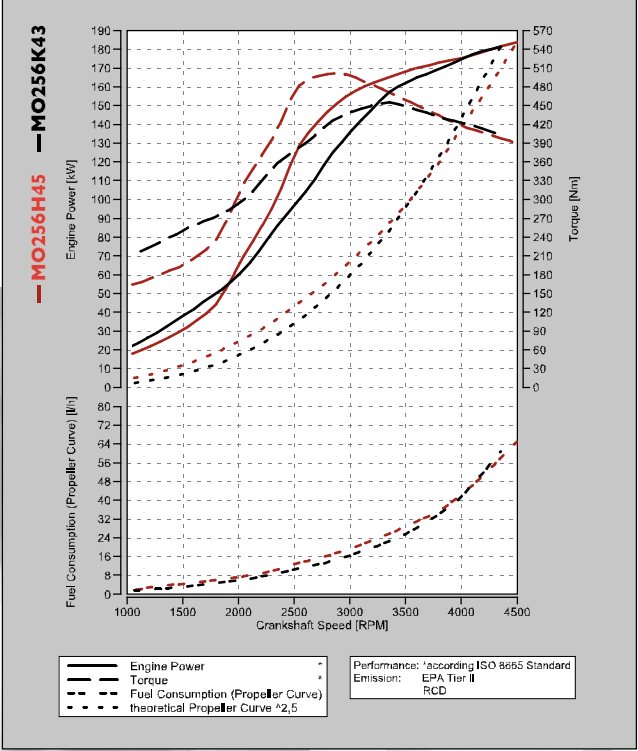

Mmaxi
06-27-2014, 12:06 PM #34
I do not want to hijack this thread or open a new one.
But also need some info
I discussed marinization various car engine, and my one friend advised Mercedes om606. So I came to this forum.
The boat is small 6m 1.5 t, Alamarin 230 jet - impeller for Steyr mo256k43 (engine removed), power curve in att (black)
So I'm mechanic and reading forum get something like this:
-mechanic pump om603, cca 6,5 elements ?
-holset hx 35
-water cooled, intercoler, oil cooler, exhaust manifold etc..
So need 170-180 hp on 3000 rpm, 250hp on 4300 rpm.
Normal ride is 3000-3800 rpm
How long can engine hold this power, would be to much smoke on low rpm (get on plane) ?
Thanks in advice !

I doubt that can go over 210hp and maybe 400nm.
"I am just about to updgrade the ECU`s with a new chip which will give me 210HP and about 630 nm of tourque."
So Kevin statement can't be right...
Cool
starynovy
338
01-06-2016, 04:02 PM #39
That pump can push some 230PS with heavy smoke due to long injection time. That massive torque can´t be right for sure, this is not CDI. Big Grin
