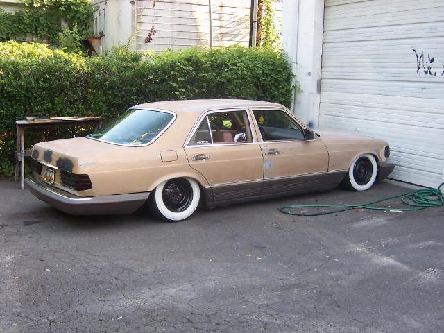

No, no. Not in the steering wheel, in the suspension.
[Image: 824200635541PM85201.jpg]
I have been looking into bagging my wagon, but haven't done anything to it yet. Seems like it would be fairly straight forward since its all coils. Build some cups and plates for mounting the bags. Put the tank, compressors, and valves in the back under the floor.

10-02-2008, 05:24 AM #4
Why? These are not show cars and the angle of the rear tires looks ridiculous when the car sits low. The rear shocks are inside the coils so installing airbags would make a very bouncy ride unless you could retrofit them elsewhere.
Noticing the "for sale" sticker on the window, I would never consider buying a car if I saw a picture of it doing anything like that.

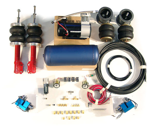

Id like to bring this debate back to life and chime in as well. Ive also considered bagging my 300D for years because of two reasons, carrying more weight, and improving rough road ride quality.
Im not into low riders and I would not bag something just to drop it to the ground, but in general, in my opinion, air bag suspensions are awesome.
For example, a couple years back, I managed to get my hands on a 1984 Lincoln MKVII with a BMW diesel in it. To pick up this car, I had to drive about 30 miles down a rutted farm road in nebraska.
I had gone to visit before with my 300D, and could barely make 25 miles an hour down this road, it rattled the hell out of me, but on the same road, I was able to cruise at about 65-70 in the full air suspension lincoln. It was almost an incomparable difference in ride quality. That, combined with the fact that I could carry a lot more weight at the same time makes this a really attractive idea.
The biggest problem would be what forced said, relocating the shocks and struts to make room for the bag. That alone might make it not worth it.
Heres a pic of a macpherson strut adapted air bag system I found, (upper left) if you could get larger air bags like this, with a hollow core or sealing system, maybe this is not impossible with super minor modification.
I still think it would be totally worth it even if I had to relocate the shocks.

(12-01-2009, 11:48 AM)dropnosky Heres a pic of a macpherson strut adapted air bag system I found, (upper left) if you could get larger air bags like this, with a hollow core or sealing system, maybe this is not impossible with super minor modification.
Essentially, that looks like the hydraulic struts used on our wagons. Those have the "nitrogen spheres" to act as an air bag, but not sure if it really really smooths out the ride since I haven't driven my wagon all that much yet. Will be taking it to New Hampshire in a week or two though (1400 miles one way! Cool)
