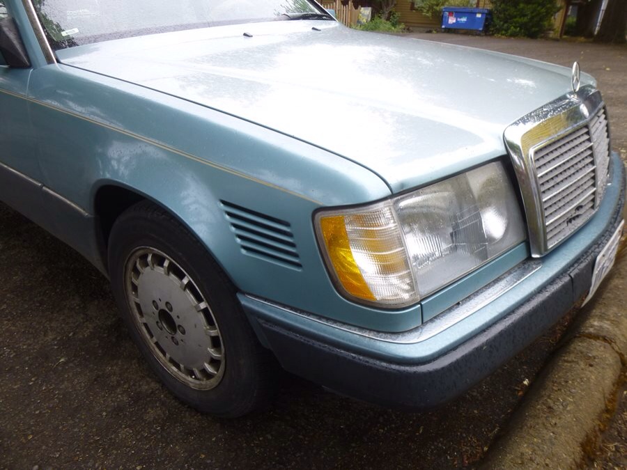

Craigslist or on StanceWorks may help you find 8x16 wheels = high speed rated tires and better brakes http://www.stanceworks.com/forums/forumdisplay.php?f=90
in a past life, i owned a track-specific Subaru STi ...
on the Subaru owners' forum, there are a few gearheads to managed to strip 700+ pounds off of a 3,400 lb Japanese car ... not easy to do.
philosophy: if the item didn't help the car go lighter, then it was deleted or replaced
eg ... no carpeting, no headliner, wiring, no paint ... lots of "drilling" = lightening
Given how heavy the steel body panels are, i wonder if you took punched vents in the bodywork, spaced every X" inches ... lighter, better?
