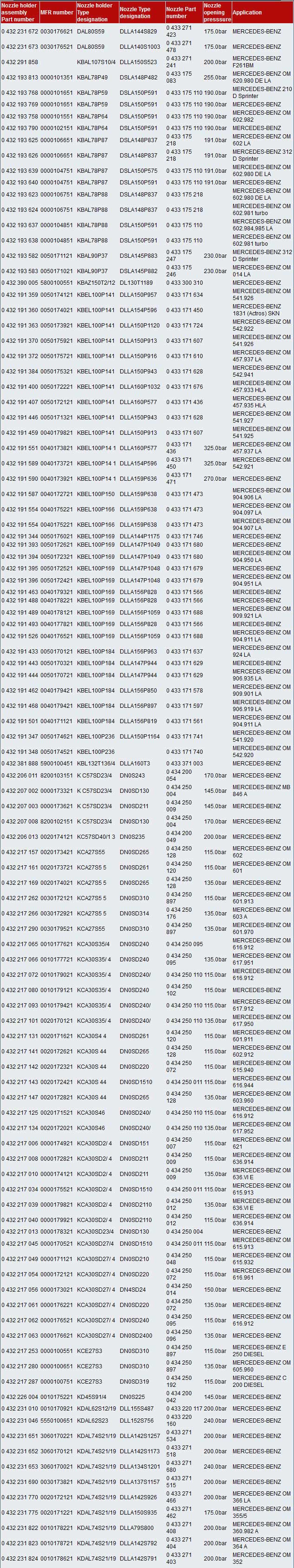

Here is a couple of small lists on Audi and Mercedes. Hope that can help you guys out.
Audi
Mercedes
Had to cut it in two...

(03-02-2014, 02:04 AM)Turbo Thanks FRAS
can you please explain a little bit more, for example what pressure is listed ?
In the red field on the Mercedes list there are specifications.
This was just a list that I found on the computer. I have not checked it out more close. I just saw that you were talking about Audi and Mercedes injectors and thought It could help.
