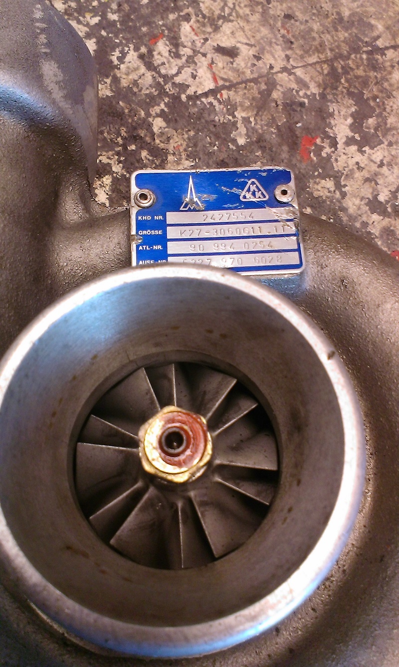

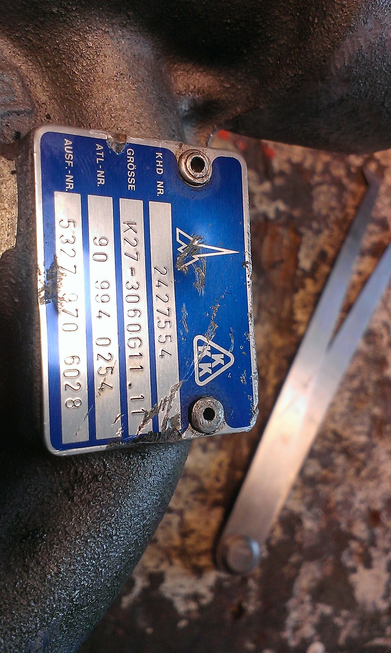

Hello,
I have an OM606 with 7.5mm elements (PPdiesel). Now I have here an KKK K27 3060 G11.11 turbo from an Deutz BF8L513C engine, V8 13.38 liter twin turbo.
This turbo is brand new, would this spin up on this engine or can I better throw it out? I know a HX40 would be better but money is an issue..
kind regards,
Cor Kuin

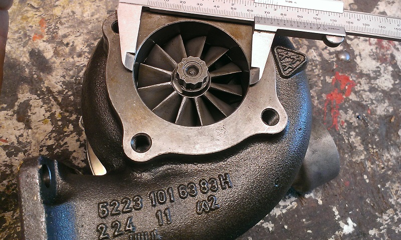

Measure the comp and turbine wheel size and take a few photos of the turbo. Then someone here can help you

Sorry for my very late reply. The exhaust weel diameter is 65mm and the inlet compressor is 46.5mm.

Turbine shaft and wheel is identic on Porsche 911 turbo K27 but compressor and houdings are different.
TBH, this "old" K27 would not be my choice for a nowadays build. Its old technology, compared to todays knowledge these turbos are quite inefficient, sluggish and slow spooling....
