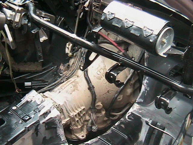

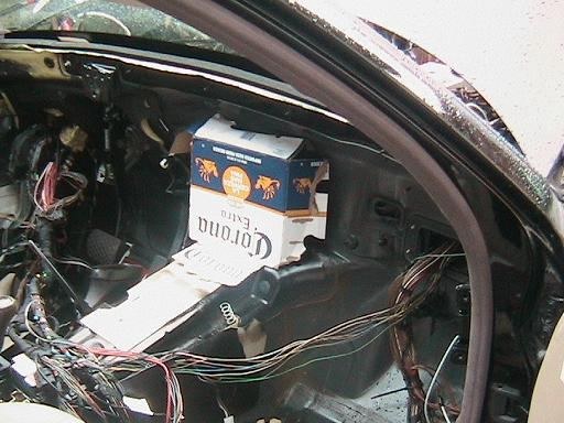

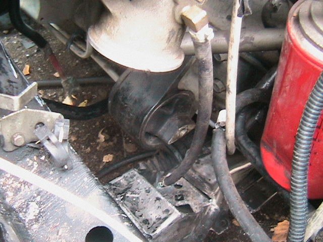

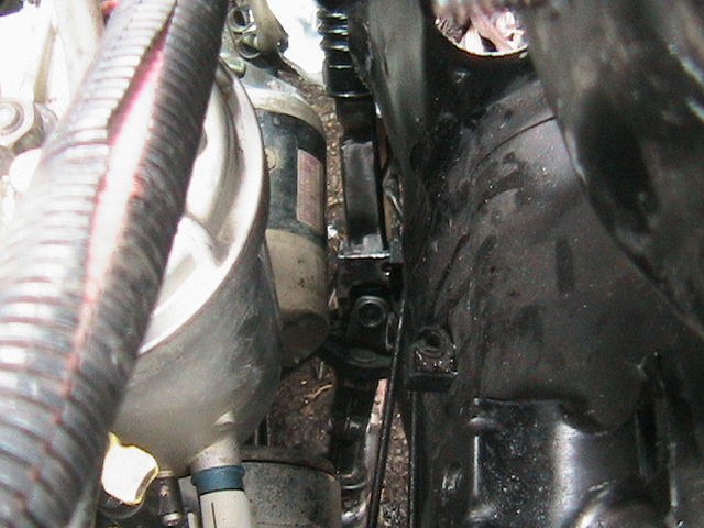

The cummins is not very heavy, if this guy can put it into an E class then a crown vic should be no problem.
[attachment=0]<!-- ia0 -->turckdodgepicture3019te1.jpg<!-- ia0 -->[/attachment][attachment=1]<!-- ia1 -->turckdodgepicture3017zh6.jpg<!-- ia1 -->[/attachment]
[attachment=2]<!-- ia2 -->52925460hw7.jpg<!-- ia2 -->[/attachment]

omg! That cummins powered mercedes looks badass! Any links pics or more info on that car? I have seen a cummins powered monte carlo on Youtube. But not a Benz. I would appreciate any info or links to modified cars like that!
I wonder if a late model crown vic will fit a cummins 6 cylinder? Might affect the handling with the weight?

The cummins although badass, is quite heavy at around 1100 lbs and very tall, I wouls suspect that the crossmember in the late benz had to be modified. Also the cummins is quite spendy. where as a properly prepped 6.5 chevy diesel with all marine mechanical injection, main girdle and ARP head studs will make 300 very reliable HP and about 600 FTlbs of torque. These engine use small block chevy engine mounts and bell housing pattern, making them a great choice for swaps. You can find them around for cheap and even convert the later electronic FI type to mechanical type FI. I'm doing a swap in a 67 chevy truck now with a friend and this motor is a beast. There are after market cooling setups available for them as well as fluid dampers and other parts. Military surplus is a good place to look.

there is no way that guy got that cummins into that W210 car without MAJOR crossmember
surgery, in fact he probably has to run a dry sump oil pan to keep it off the ground..
I have one of these engines in my Dodge Dually truck (mercedes parts hauler)
and greaseking is right... VERY tall
forced,
do you have any more info on that car ?
does it actually run, or was it just dropped in there as a photo op ?
( still has the chain on it )

10-06-2008, 04:11 PM #8
These photos are all the information I have on it.

10-06-2008, 06:42 PM #9
wow... just wow..
I thought I did some crazy stuff..
that will be one nose heavy car..
the ISB/6BT is about 960 lbs
even the 4BT is 745 lbs..

..its mounted pretty far back..
