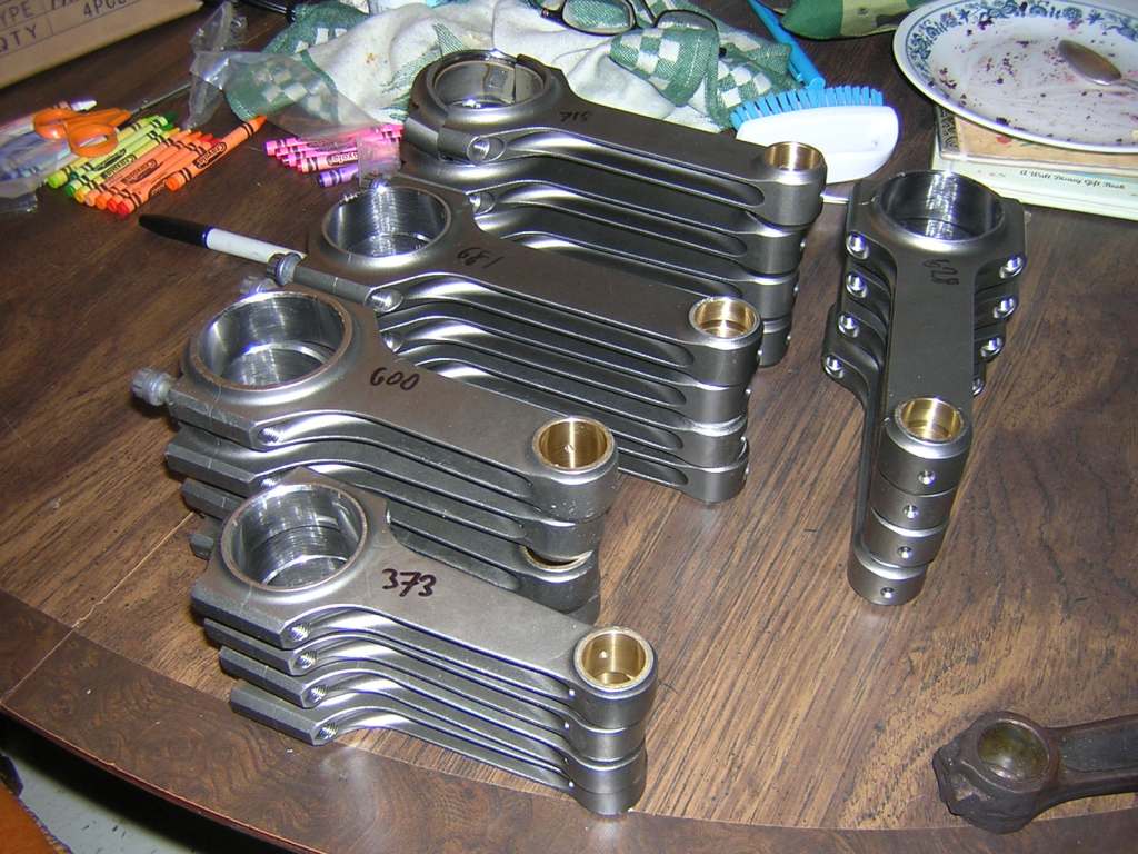

[Image: JVAB_Rods05.JPG]
Does anyone have the specs on the OM606 rods so I can get him some numbers to get a quote on a few sets?
I have been thinking about getting some done for myself but don't need four sets. Would anyone be genuinely interested?
